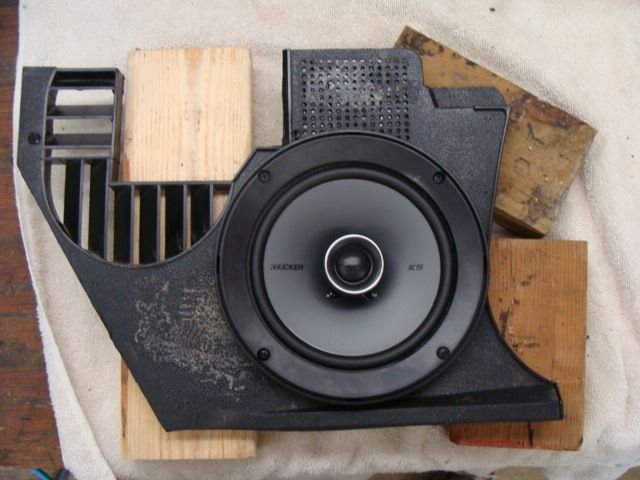

Purchase used kick panels. Cut a hole and add 6.5" round speakers. You will enjoy the sound much better than placing the 4x6s behind the panel.
Here's my install thread...
https://www.corvetteforum.com/forums...-speakers.html
Another with good info...
https://www.corvetteforum.com/forums...ns-please.html

I Put 6" round Rockford Fosgates in my '69.
The original kick panels were already cracked in several areas so I didn't hesitate to cut holes in them for speaker sound. And the new grilles look good on top of the kick panels.
These speakers also came with satellite "eye ball" tweeters that are placed in the windshield corners. These really add to the front overall sound quality. It brings the level higher and closer to your face/ear level, which helps with the tops off.
Rounded it out with a compact sub (also from R-F) in the rear compartment, and a little Boss amp for the fronts only, which I mounted to the backside of the passenger lower dash panel with some Velcro strips.
Overall, pretty happy with the sound quality.

I'd suggest that you remove your kick panels and measure metal support spacing and depth; then compare those measurements against the actual speakers you are considering. Also consider putting a bit of fiberglass or foam behind the speaker to keep from creating unwanted vibrations and/or resonance. You need some airspace behind the speaker, but that's a trade-off with rattles.
