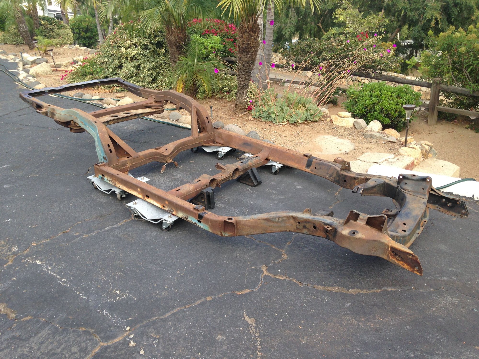

I kept telling my wife not to let me take the body off
"I am 8 bolts away from disaster"
well look where I ended up

I also had massive rat nests in my frame
and it stunk to high heaven
I had heard that rat pee is highly corrosive, so
I ended up having to flush out the frame with water
You wouldn't believe all the nasty stuff that came out of there
