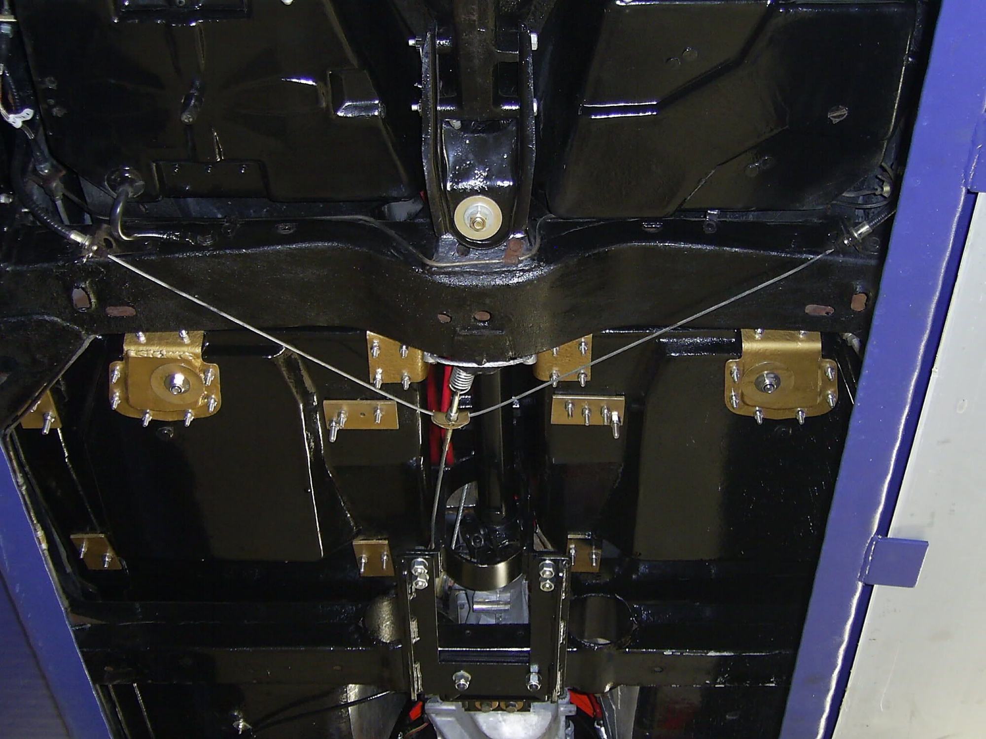

these areas usually get mud stuck up inside,
To Rust...how bad is bad?
