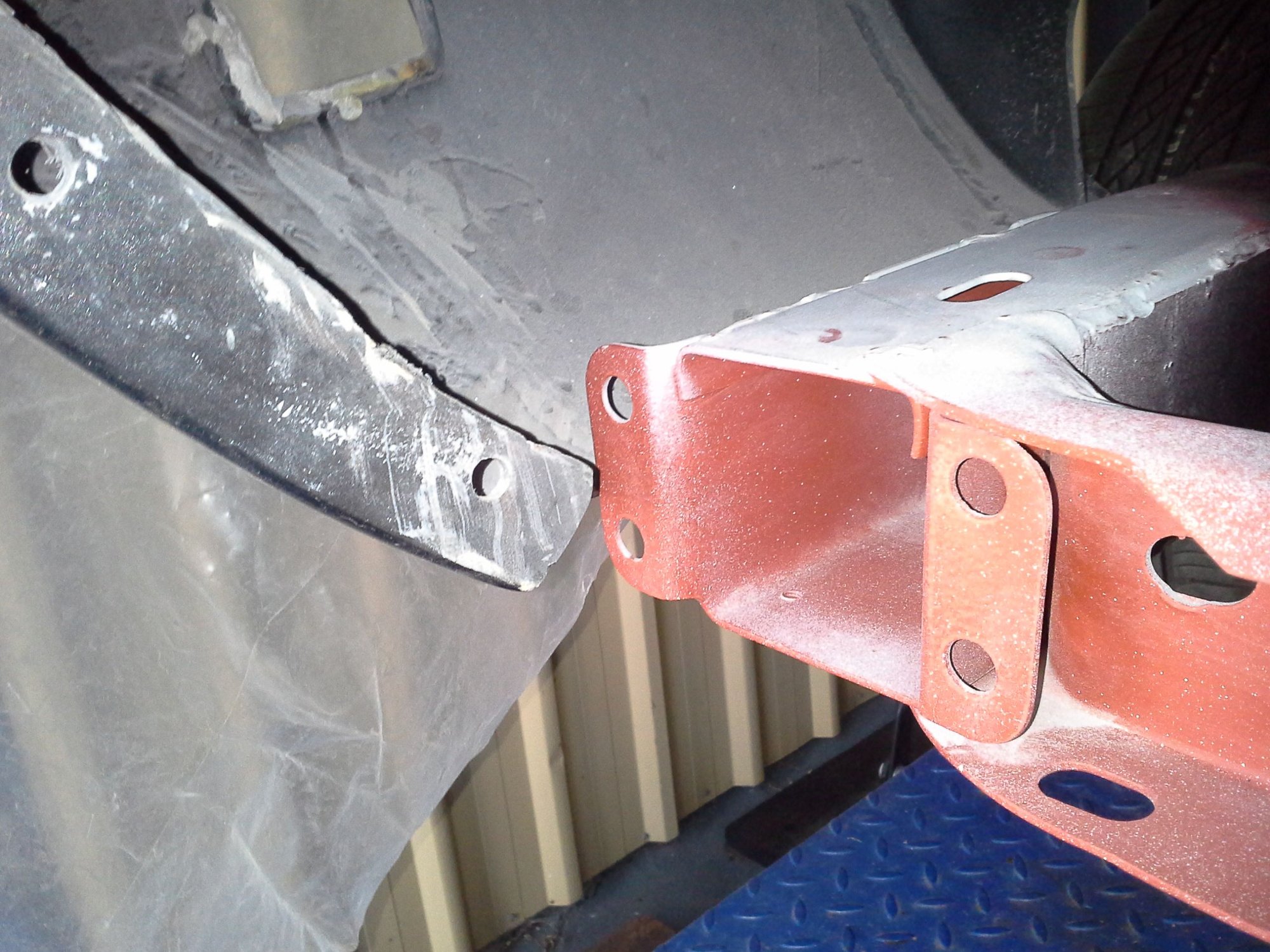

I just put my 69 coupe on a 78 frame , so far so good the 78 was the last year for the iron diff (I think?) so that's why I took this one , I tried for ages to get a 68-74 decent frame around here and I got tired of looking at crap when this one came along . Try and get an early one and save some hassle with the bumper supports as Bats said .

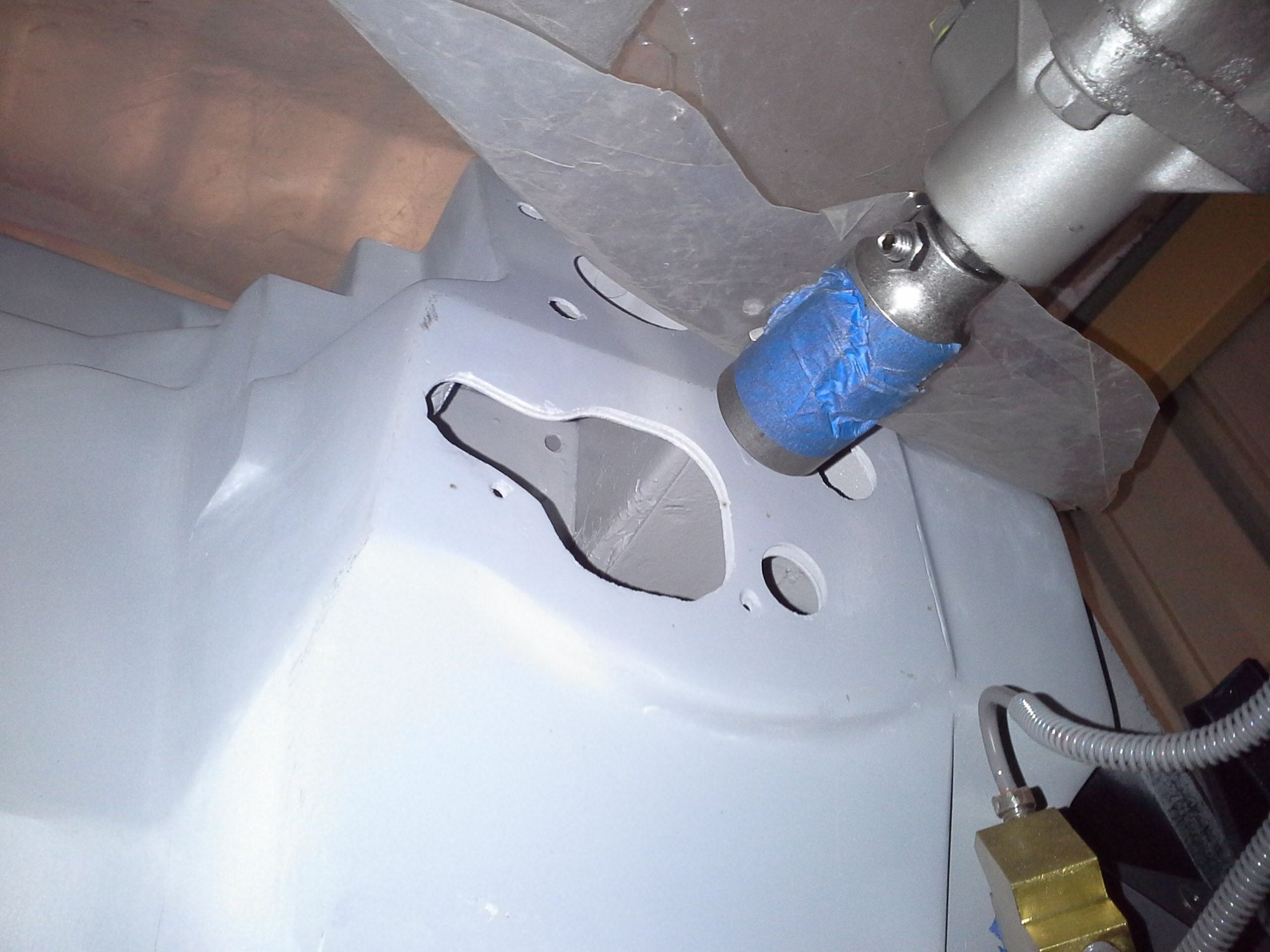

Anyway my body has the removable exhaust panel but the end outer tab on the 78 frame still caught on the glass as it comes down , not a big deal really but I cut the tab off anyway .Also recreated the side mounting holes for the rear bumper brackets before I dropped it on . I'm using new early body mount ali bushing kit and so far have 2 shims on each #2 and #3 mount and the steering column access hole lines up with the steering box well .
That's as far as I got with it , I still have to see if the tank fits back up in there , I'M SURE I will need to cut /fabricate on it to get things to fit , but I will deal with the challenges as they come .
