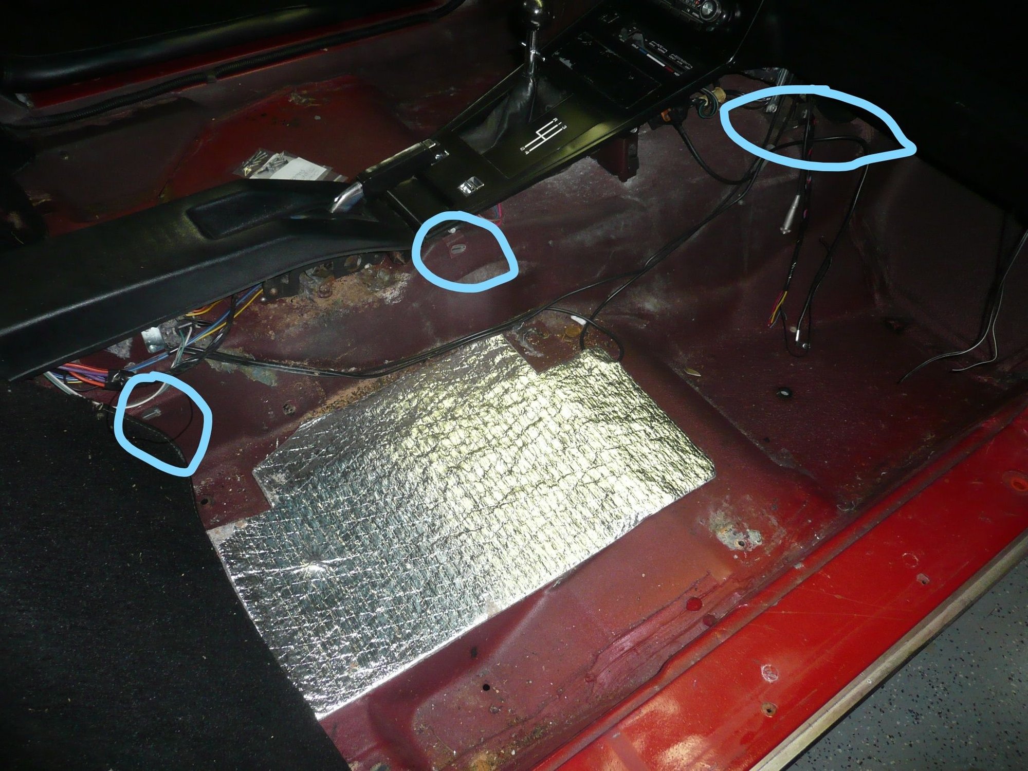

From: Ann Arbor Michigan
This pix shows where the 3 screws go.
