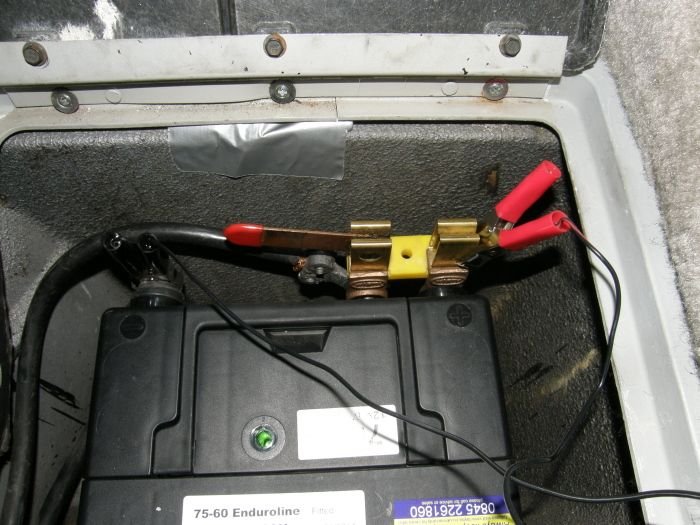

I bought this simple "blade" switch back in 1990 from Lectric Limited (Don't know if they are still going). It has worked a treat ever since. It's not for anti-theft but to ensure no battery drain when the car is left for a while. The wires and crocodile clips are for the "trickle charger", by the way.
