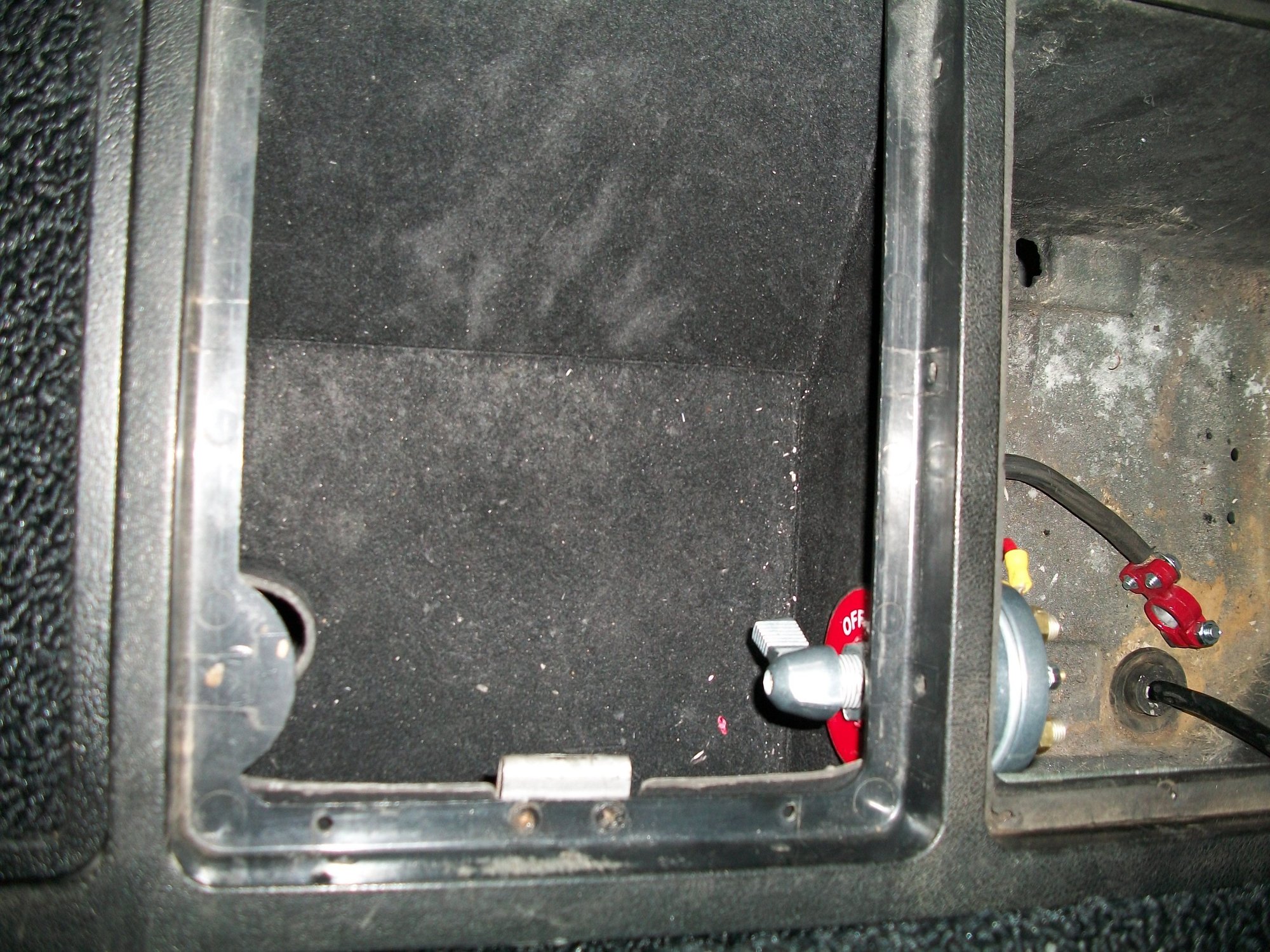

I put one in. The base of the switch is in the battery compartment, but the switch handle is in the center glove box. I did add some fiberglass mat to side of the cardboard glovebox insert to give it more strength.I put one in. The base of the switch is in the battery compartment, but the switch handle is in the center glove box. I did add some fiberglass mat to side of the cardboard glovebox insert to give it more strength.

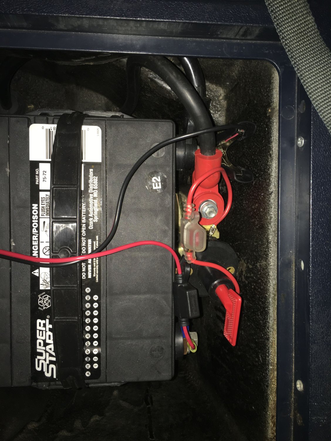

I was able to install it in the battery compartment

I just use a wirthco/battery Doctor side post blade switch attached to the battery. Get a good quality one as the cheapo ones aren't great.

I'll also add that I put a small fuse holder (I used the inline style but the blade like speedreed8 shows works also) and in my case a 1.5 amp slo-blo fuse. This keeps the radio station presets and fader controls etc and the clock (quartz) correct while still preventing most anything with enough current from being able to start a fire.
My interior lights are all LED so even if I open the door without closing the blade it doesn't pop the fuse
If it's going asleep for a long time I pull the fuse as well

that’s exactly what I have. I use a 5 amp fuse for the clock lights radio. Can’t tell you how many times I’ve blown it. Trying to start without turning on the main switch 😩

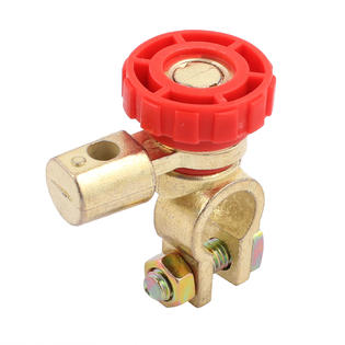

I bought this one today from Auto Zone. Now to install it.
