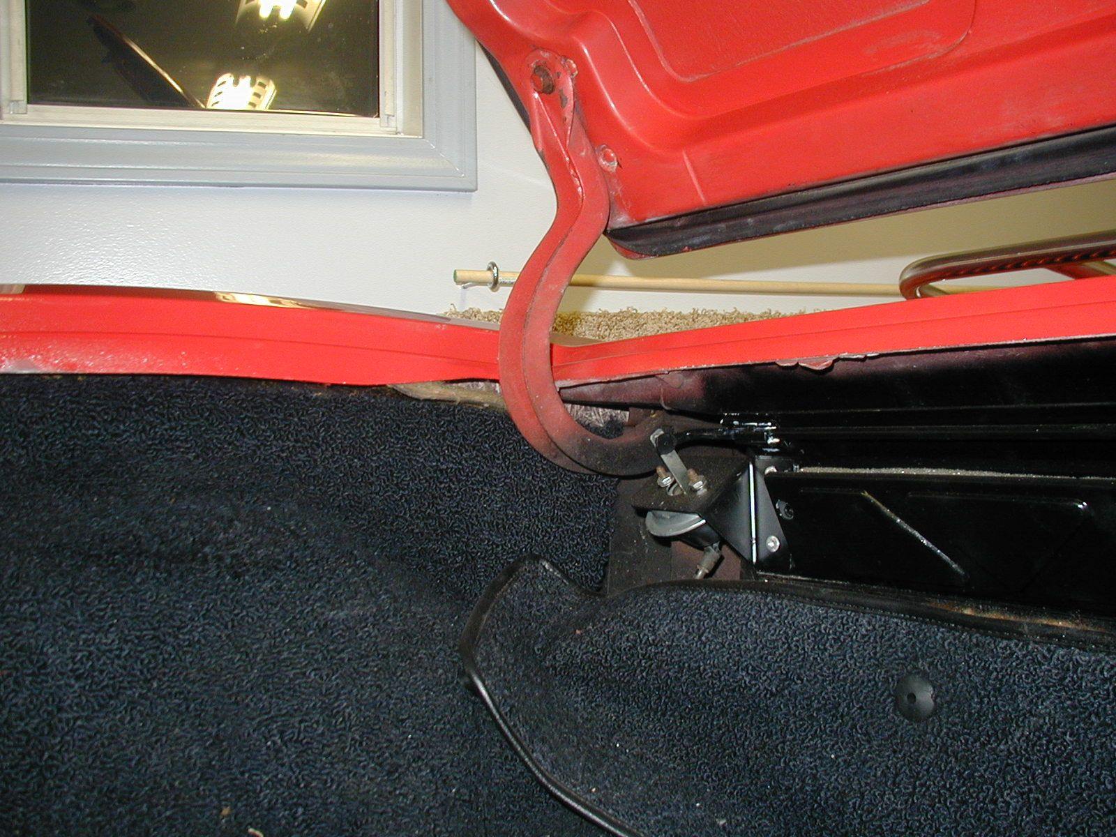

To Storage compartment main frame
Old Aug 31, 2018 | 07:45 PM
Duke94's Avatar
Duke94
Posts: 6,640
Likes: 287
From: Ann Arbor Michigan
Originally Posted by wolvercote
WOW!, car had no carpet in it when I got it. So that top bulkhead area is just not covered, were they all like that, I know the top edge is finished but had no idea. Thank you.
This is a 71' Convert I once had.
Old Aug 31, 2018 | 08:03 PM
wolvercote's Avatar
wolvercote
Joined: Jun 2018
Posts: 46
Saw that picture after you informed me, glad to see larger. Your never too old to learn
Old Aug 31, 2018 | 08:14 PM
ignatz's Avatar
ignatz
Joined: May 2004
Posts: 4,363
Likes: 1,587
The early coupes have a storage tray in that area for the rear window. No need for carpet there either. Not sure what your car is.
