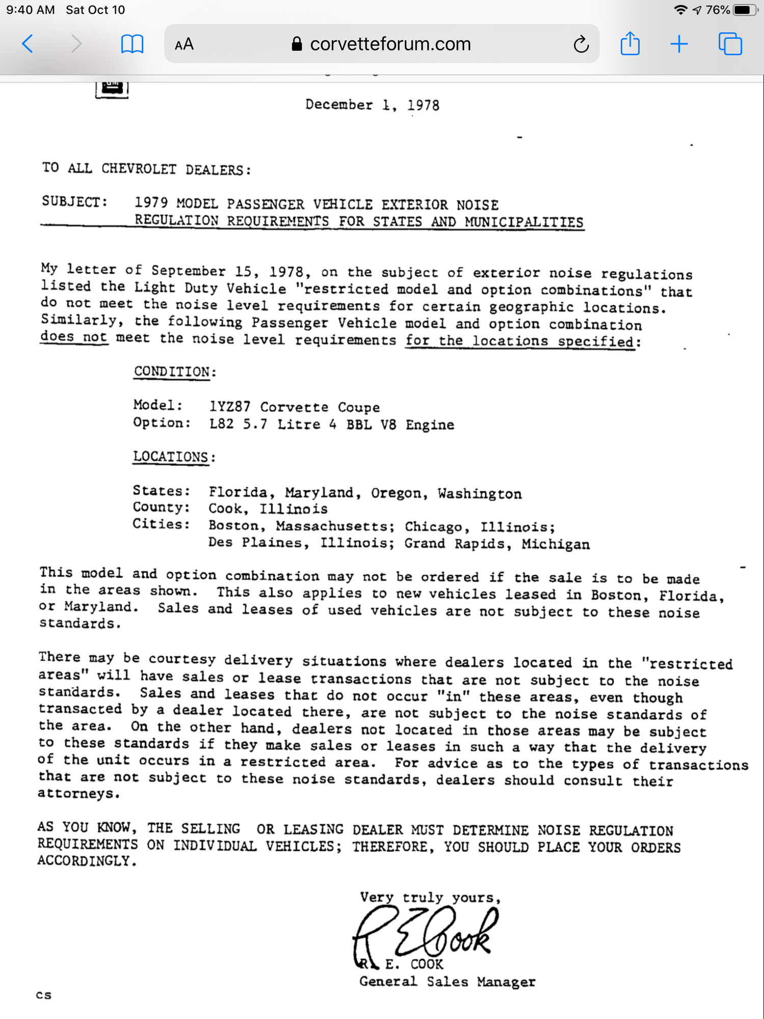

Old Oct 10, 2020 | 09:43 AM
interpon's Avatar
interpon
Joined: Jun 2019
Posts: 7,653
Likes: 2,468
From: Indiana
I had original mufflers on mine before cat delete and true duals dynomax st and they were not that quiet
from grand rapids who knew
