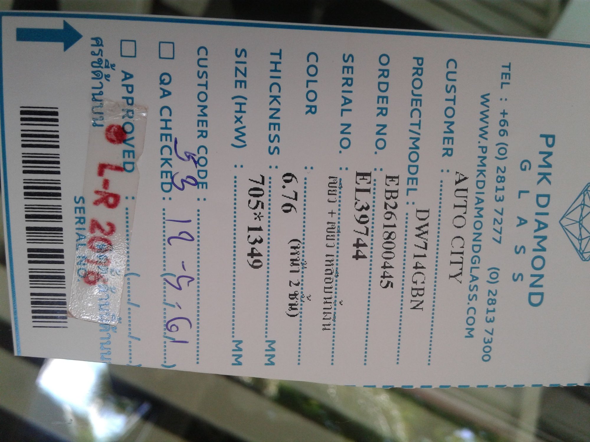

I just bought one from Auto City in Isanti, MN. Evidently all these windshields are made in Japan and imported by Pilkington. Here is a pic of the inspection sticker. Check the thickness at 6.76 mm.. I suggest using a 3/8" rope instead of 5/16. Your stainless will fit better.

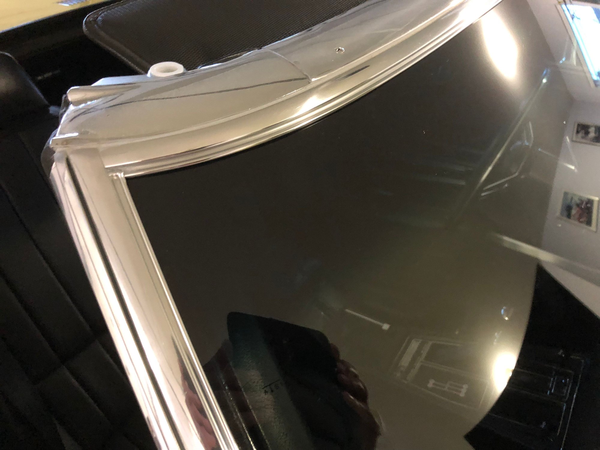

I replaced my 69 windshield in my garage this past winter. The original glass was .275" thick and the replacement glass was only .205". The factory damming strip is listed at 5/16" but with the thinner windshields you need a 3/8 strip or the windshield will sit too low resulting in a gap between the glass and stainless trim. The trim gaps came out perfect with the 3/8" strip.
