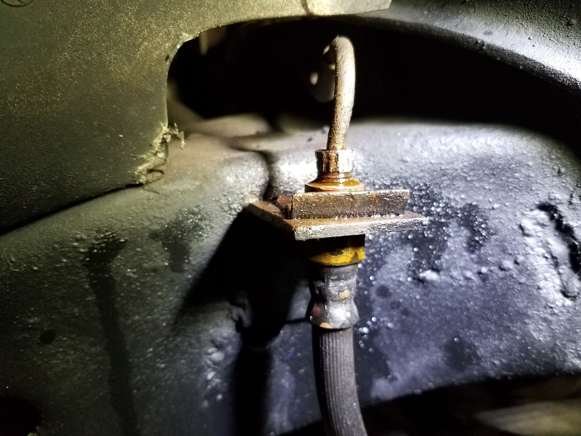

It took me forever to get the hard line in bolted. My first caliper replacement. I’m having my challenges, but I’m making progress. Can’t wait to get it back togther and back on the road. I love when it has new parts.

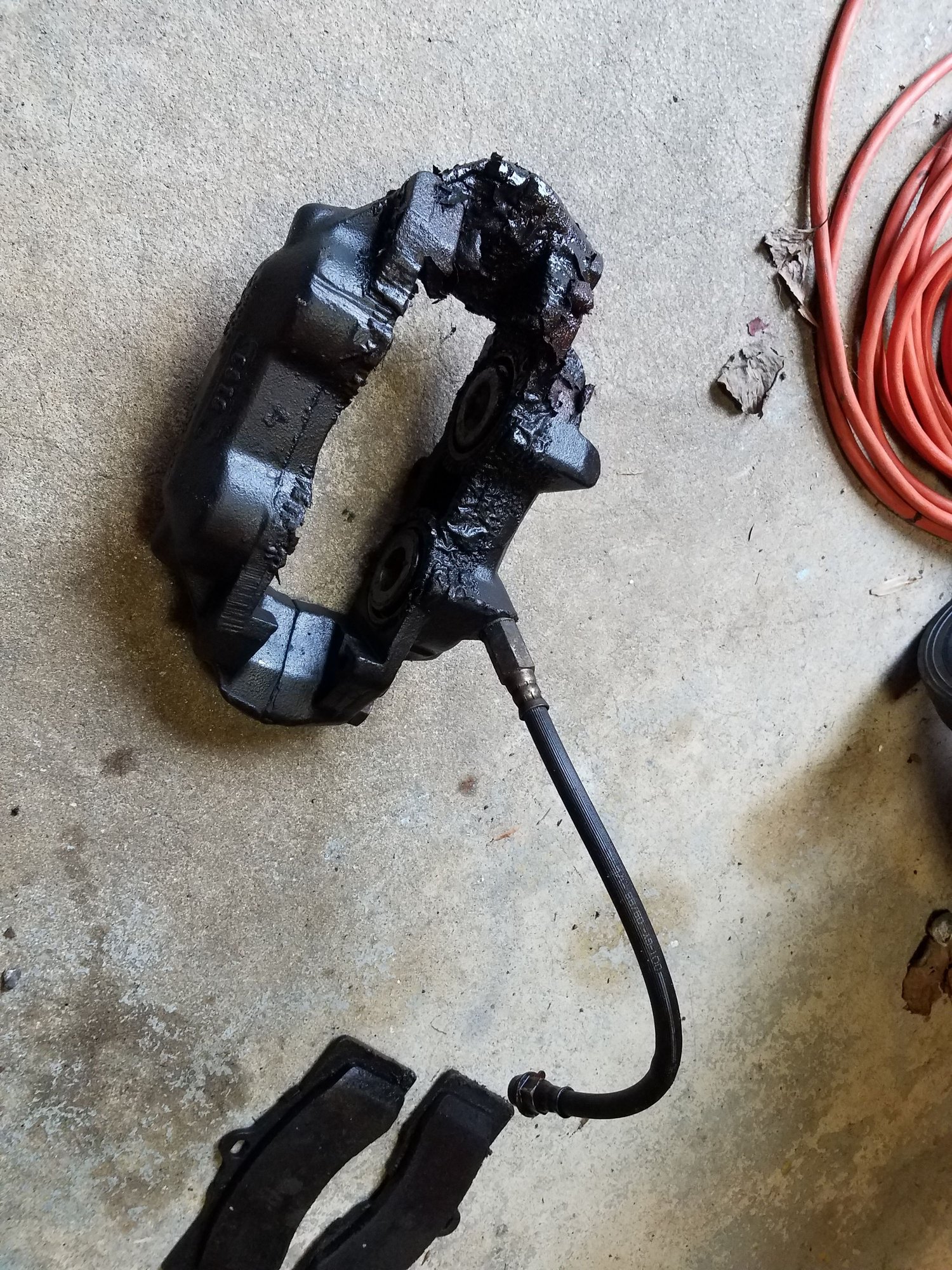

This was the trouble nut
Bad seal
Finally off
New caliper temp mounted
