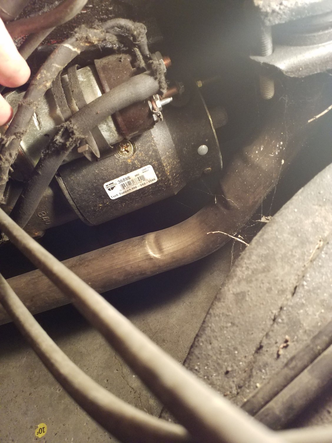

Old Nov 4, 2018 | 06:42 PM
Billenglish's Avatar
Billenglish
Joined: Nov 2018
Posts: 110
Likes: 15
From: Oregon, Ohio
Pretty ratty, eh?
Old Nov 4, 2018 | 07:36 PM
Hammerhead Fred's Avatar
Hammerhead Fred
Joined: Mar 2005
Posts: 2,094
Likes: 298
From: Midlothian VA
Originally Posted by Billenglish
Pretty ratty, eh?
Seen worse.
Did you find your short?
Is the insulation on the main +hot going to the starter there cut through by the cable retaining clip?
Tough to tell.

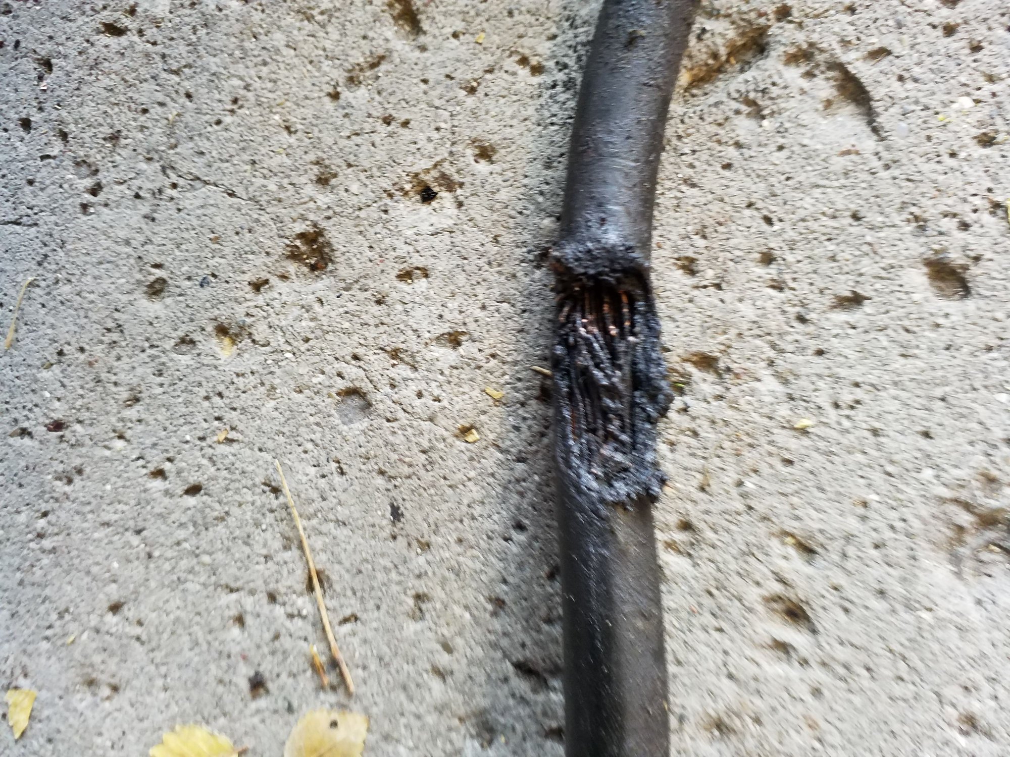

Old Nov 5, 2018 | 11:11 AM
Billenglish
Joined: Nov 2018
Posts: 110
Likes: 15
From: Oregon, Ohio
OK, think I found it. Dcd the starter, short still there. Tested battery, not there either. So, crawled under the car and started looking along the cable, and yes, found a worn spot where I can see copper poking out. This is on the cable where it is directly over the shifter. I'm going to just wrap some additional insulation around it for now until I get a replacement cable. Thinking of just buying some 00 wire and remaking the connections. Has anyone done this? Thanks for all of you help, this board is a very valuable resource for us newbies. Bill
Old Nov 5, 2018 | 12:56 PM
Billenglish
Joined: Nov 2018
Posts: 110
Likes: 15
From: Oregon, Ohio
There's
Ouch!
your problem right there! Went to Autozone, longest cable is 6 foot, way short. Looks like about 8 feet. Where can I get one?

I can tell you that I have installed enough positive battery cables that when you get the original one out make sure the new one is the exact same length or really close to it.
And when you start to install the new cable in the clamps...start clamping the cable at the starter and work toward the battery,
DUB

Ok, couldn't find a made up cable long enough. Bought 8 foot 2 gauge red cable, with a copper eye connector. Could not get the original starter end off the old cable. Anyway, mashed the eye on the end and bent it similar to the original. Attached this to the solenoid. Along the trans, zip tied it to the spedo cable. Could not get the old clip off without dropping the driveshaft, so I zip tied it to that as well. Put new ends on the battery ends (both) and that seemed to work. Finally got to drive the car! Almost afraid of it. Will start more threads about the running driving problems (seems to shift hard) (runs very rich) etc. Thanks again fellas, you've been a real help.

Old Nov 6, 2018 | 09:56 AM
DUB's Avatar
DUB
Joined: Apr 2009
Posts: 19,294
Likes: 2,754
From: Charlotte NC
I honestly hope you secured this new cable in well.
I know for me...because I do this for a living that I would have to install it as how it was assembled regardless of the pain in the backside it can involve.
The end of the cable that attaches to the solenoid can be removed and reinstalled on a new cable due to oftentimes the new cables do not have the correct terminal end on it as like it came with from the factory. I have ad to do this on many cables so I know it can be done with a drill bit....just to let others know if they choose to do it.
So as long as you KNOW for a fact that it is secured good and not going to be able to hit anything and wear again. I guess it is your car and if you are content with it....so am I.
DUB
