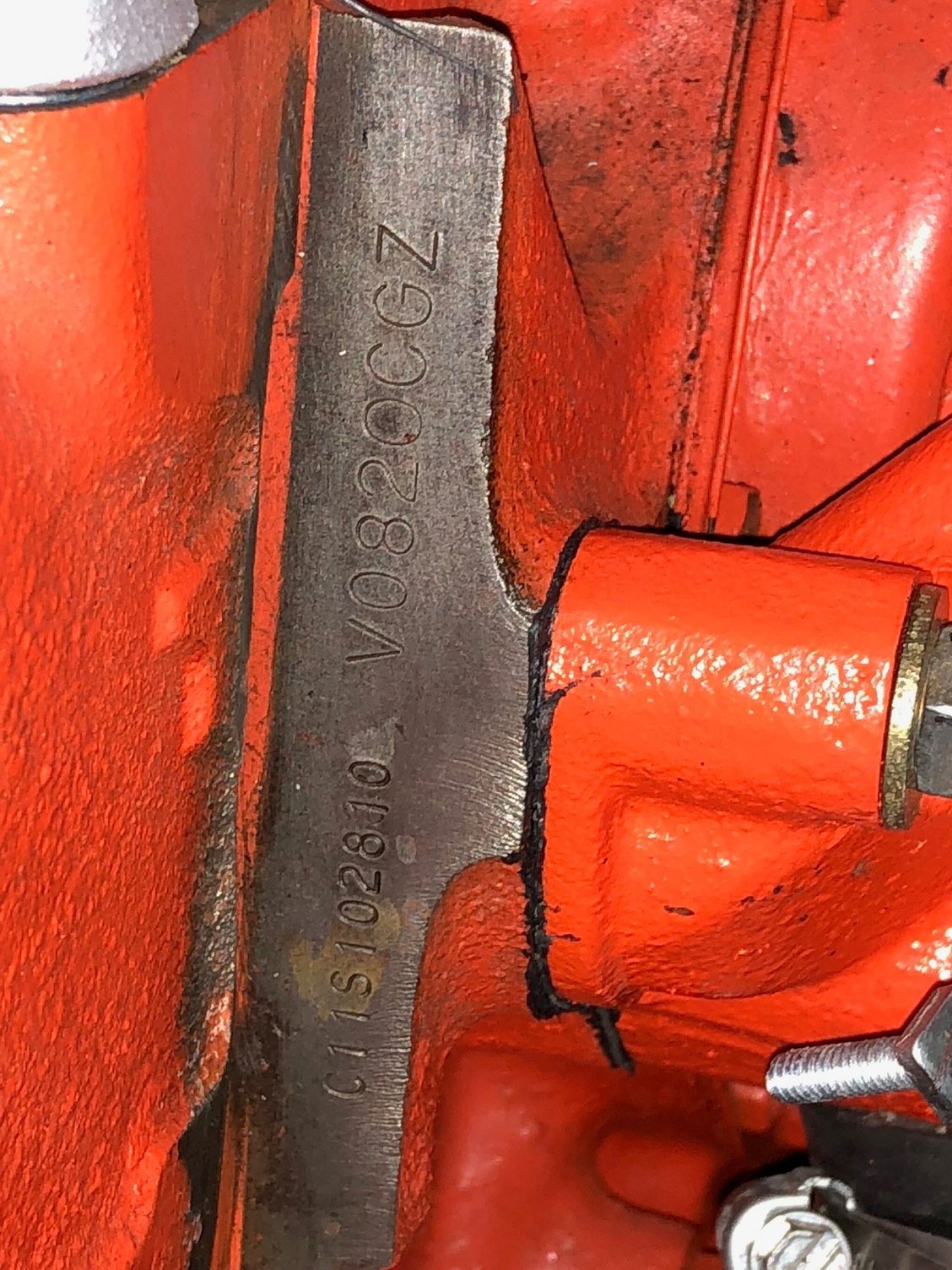

do you have a picture of the engine stamp pad in front of the passenger side cylinder head?

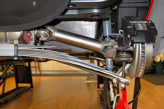

1. The rear spring is not the original or the correct type.

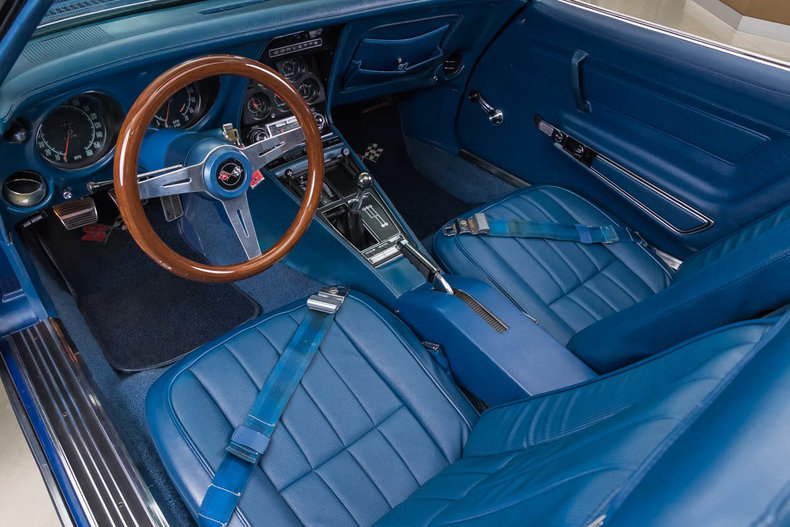

2. Non-factory steering wheel.
what is the correct type
Old Dec 15, 2017 | 02:56 PM
MelWff's Avatar
MelWff
Posts: 18,728
Likes: 2,579
a spring made from steel, that is a fiberglass spring and appears to be missing the heat shield to protect it from the exhaust pipes.

this is the stamp on the engine
Never seen a fibreglass spring with the original type steel clamps (shipping ? ) on it . has a "hold together bolt and nut " on it still as well .

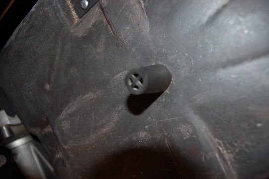

also missing the little battery compartment drain thingy ( for 50k , I would want one ! )

It's difficult to just what the spring on this car is from the single photo of it.
A picture of it from a different angle would help clear up what it is.
Here's a photo of a typical 9 leaf spring.
Regards,
Alan
The drain. A small inexpensive item

It's not that bad , but these guys will pick the hell out of a car , which is what any buyer would want so your not going into a deal with out full knowledge of what IT is or more realistically what's happened to it over the years .
Steel clamps on the spring , apparently put there by the original spring makers , and supposed to be taken off ( this is what I have read ) but some weren't , that car still has them , definitely not a bad thing .you can see the bottom of them ,one on each side
edit : as Alan says , you need a better pic to see if its the correct type (amount of leafs )
battery drain thingy , is just a small plastic tube that sits in the bottom of the battery compartment drain hole , I always thought of it as a venturi type thing to help suck the fumes out ! . cost about $5 or close . absolutely no deal breaker !
its the big one of these ,
http://www.zip-corvette.com/68-76-floor-pan-plugs.html

The plastic battery manifolds and hoses were to control the fumes in the battery compartment.
The drain was indeed a drain in case the battery was overfilled while the water level was being checked.

FWIW: this car was involved in the strike. Based on the engine assembly date, initial build was probably scheduled for September. #2810 was not assembled until December after production resumed.
