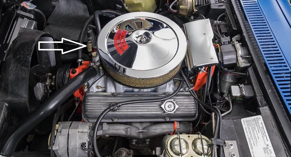

Originally Posted by Alan 71
Hi T,
The engine compartment is quite nice looking and 'tidy'.
A couple of things in the engine compartment though...
The 71 LT-! engine originally had an A.I.R. system on it that was part of the emission equipment on certain 71model year engines.
It appears that all the AIR equipment is missing.
You may not want to replace it but it was there originally....and is costly to replace.
The valve covers aren't for a 71 LT-!.... they had a black rubber push in oil filler cap. They required a different valve cover than what's on this engine.
The water pump on the car has a 'boss' with a plug in it. Water-pumps for 71 didn't have the boss or plug.
The white plastic washer bottle isn't in it's usual place and has no filler neck on it.
Regards,
Alan
Alan, I'm a bit confused. On the C3 registry, vin #102810 shows the AIR equipment. Maybe someone removed it.
https://www.c3registry.com/index.php...te&car_id=5702

looks like the A.I.R components came off some time after 2010 .
Also its says power brakes in the registry but it didn't have it in their pics as well. (no vacuum booster)

Hi 71 Green,
Yup, your right! The AIR equipment was still in place at the time Pro-Team took those photos.
I wonder what happened to it?
