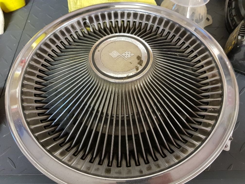

Originally Posted by brit vet
Not an experienced painter so it took me three attempts to get them to a quality that I'm happy with. It was all in the pre-paint prep !
Reminder of the starting material:
And now:
Wheels are off and just painted with silver argent so will have to wait a week to see them mounted
Beautiful

Originally Posted by pigag2
My comment was for Brit vet!
Sure pigag2
Disassembled all three parts and tossed the Impala ctr caps
Took a needle file to scuffed areas and some road rash on the edges.
Machine polished all the stainless and finned areas with a bench buffer and green polish block.
Stripped all existing paint (first attempt at painting failed as I left some paint on and it reacted)
Thorough clean with some car wash shampoo and very hot water.
Took some emery cloth and roughed up the areas to be painted.
Used an air line to blow out all the debris that collects in the backside crevices.
Masked off all non-painted areas and trimmed with a knife.
Wiped over with a tack cloth to remove any impurities.
Sprayed a mist coat, waited ten minutes and added the first coat, after ten more minutes added top coat. I used a semi matt paint.
Waited a couple of minutes to peal away masking tape and then allowed the paint to flatten out.
The replacement centre caps had no studs so I bought some 4BA machine screws, chopped the heads off and inserted them into the four fixing holes on the back of the caps which aligned perfectly with the fixing holes in the finned & back plates. Then reassemble with the original screws that I cleaned up on the buffer.
A potter’s wheel really helped especially with the masking which needs endless patience.
Stuart
