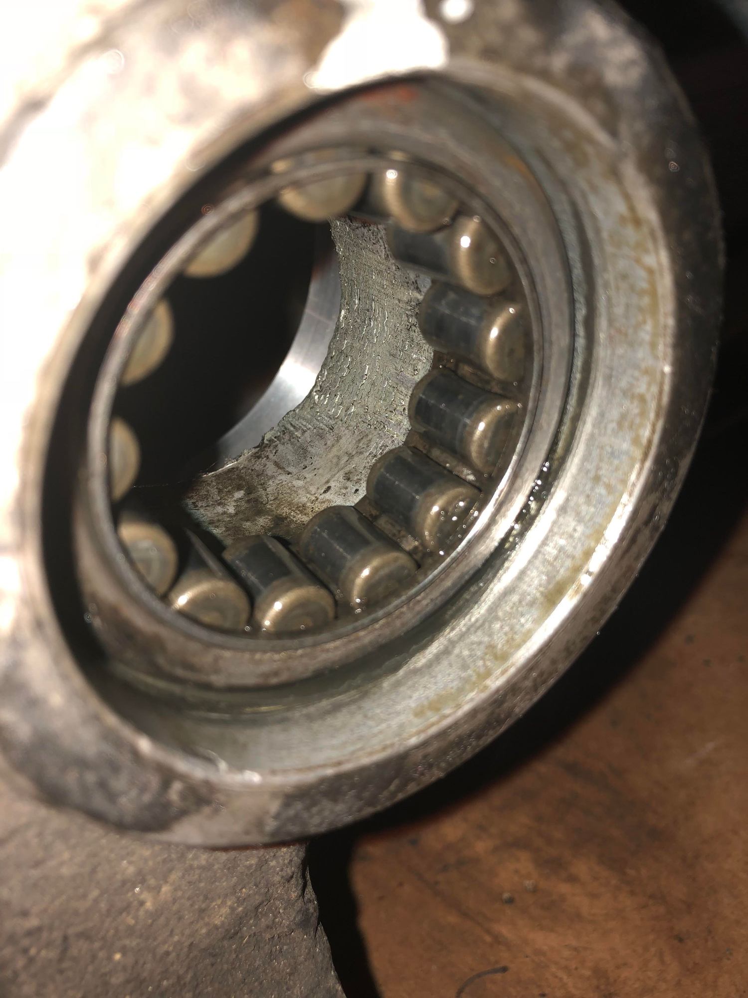

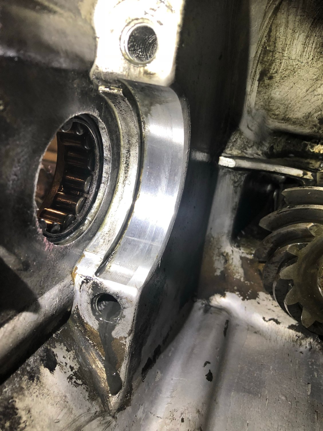

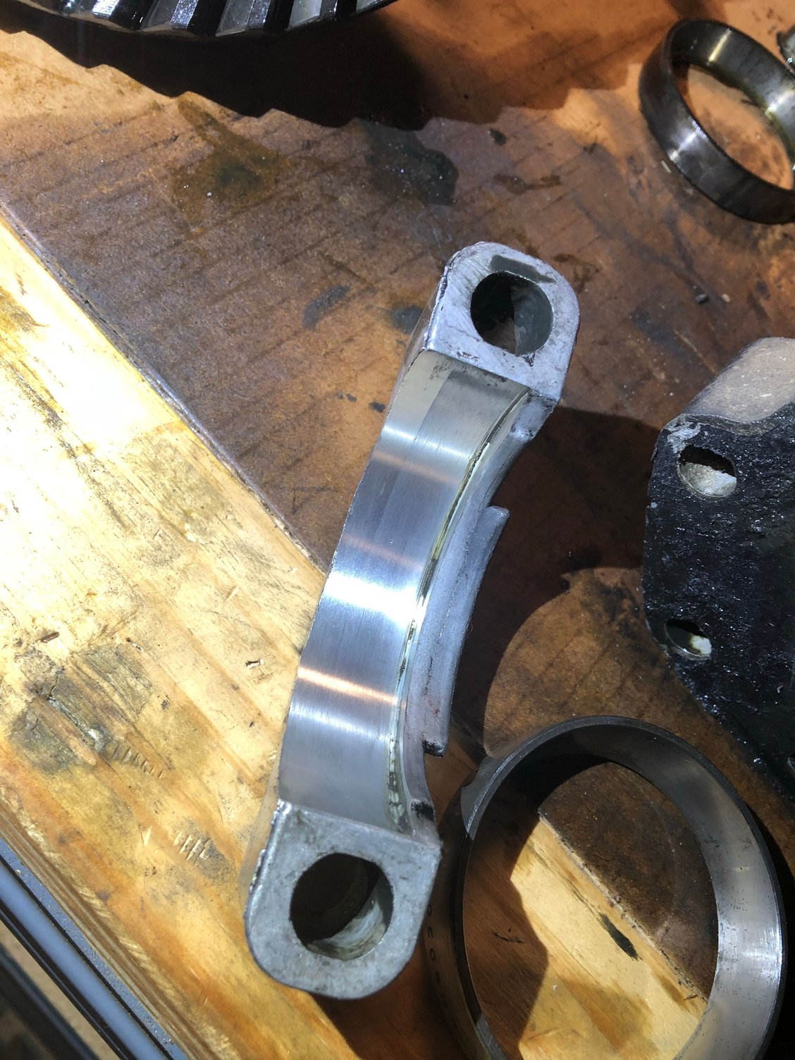

Update:
Got the carrier out tonight and was able to get a close look at the bearings. Everything turns out to be surprisingly solid! Only thing that concerns me is that the side yoke bearings are somewhat gritty and worn, I have attached pictures.

I am having to assume that these small specks are aluminum.
Normally I would say that the side yokes wore down so far that the dust shield on the side yoke is making contact with the area where the outer side yoke seals goes into the differential housing.....but by your photo and no comment on how bad the side yokes are...I doubt that is the case.....due to I can not see abrasive wear on the flat surface where the grease seal goes for the side yoke.
