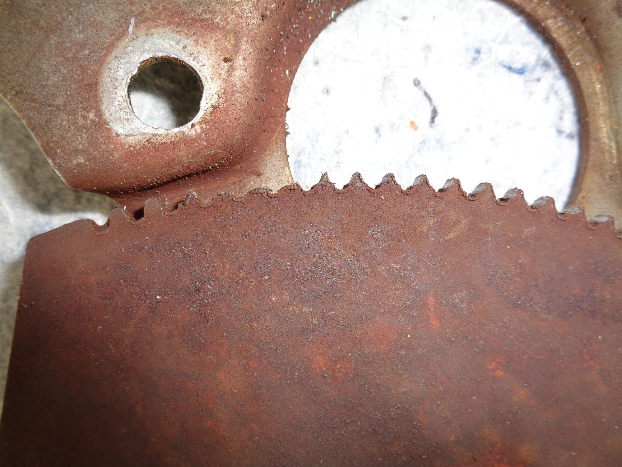

Sorry to hijack the thread, but I'm wondering how to tell if a manual regulator is bad or not. My 69 vert has manual windows. When I roll them up I have to pull them up with my other hand to help the windows get to the very top position. Nothing's obstructing them that I can tell. They just can't quite make it on their own. Then as I'm driving, they will gradually sag back down maybe a quarter of an inch over the drive. Is this a sign of a weak regulator spring? I've had the tracks out and cleaned/regreased them.
You might have a worn gear.
https://willcoxcorvette.com/68-79-wi...ild-kit-manual
