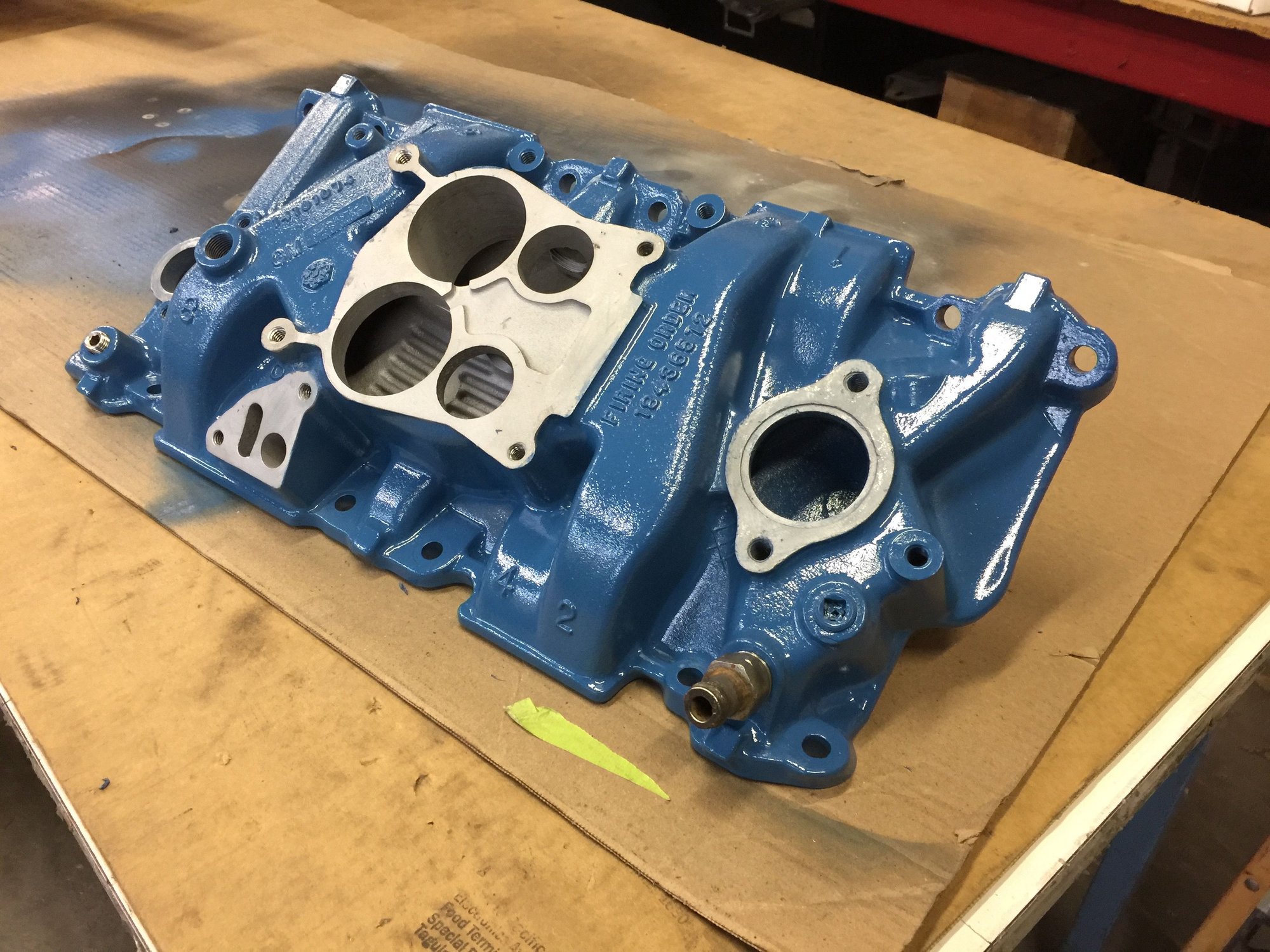

I'm assuming the reason your old intake won't fit is because the bolts go into the head at a different angle. If so, I ran into the opposite problem you're having a couple years ago. My uncle gave me an aluminum intake and I went to install it and found that it was meant for the '87+ 350. I had my dad machine some spacers to make it work, but I ended up switching back to the cast iron intake for reasons I don't remember. Anyway, I think the intake you need is the GM 14101074 intake (assuming you use a spread bore carb). Unfortunately I don't have it anymore, otherwise I'd send it your way.

The end 4 bolts fit fine. It is the middle 2 at funny angle. It is Bubbubbubutchery, but take an angle grinder and cut-off wheel and cut the middle screw holes to slots. Unless the intake is of any specialness. Most likely cast iron 4bbl and you don't worship it anyway. It will seal and run.
I considered this.... Maybe I should just go for it. I couldn't get myself to drill the aluminum intake. Better than not having a running car right?

Okay, you have an aluminum intake. You can just get up a burr for using for cylinder head work in aluminum heads. You chuck it up into a drill it'll turn fast enough to egg out those middle four bolts into the angle you need to use for those TBI heads. Drill bit will probably work too. And once the intake is back on correct heads, the butchery won't show.

Seeing as how the TBI heads have been out for 30 years now......just find the correct used intake on E-Bay......do some shopping........or you could slot the intake and buy some spacers to work. If you do slot everything and find or make spacers....I suggest using studs/nuts for the center four bolts to take the stress of uneven surfaces while tightening......this will save your ***......

Got the intake on there today! Just slotted it and you can't notice the butchery at all. Fit and sealed up perfectly.
