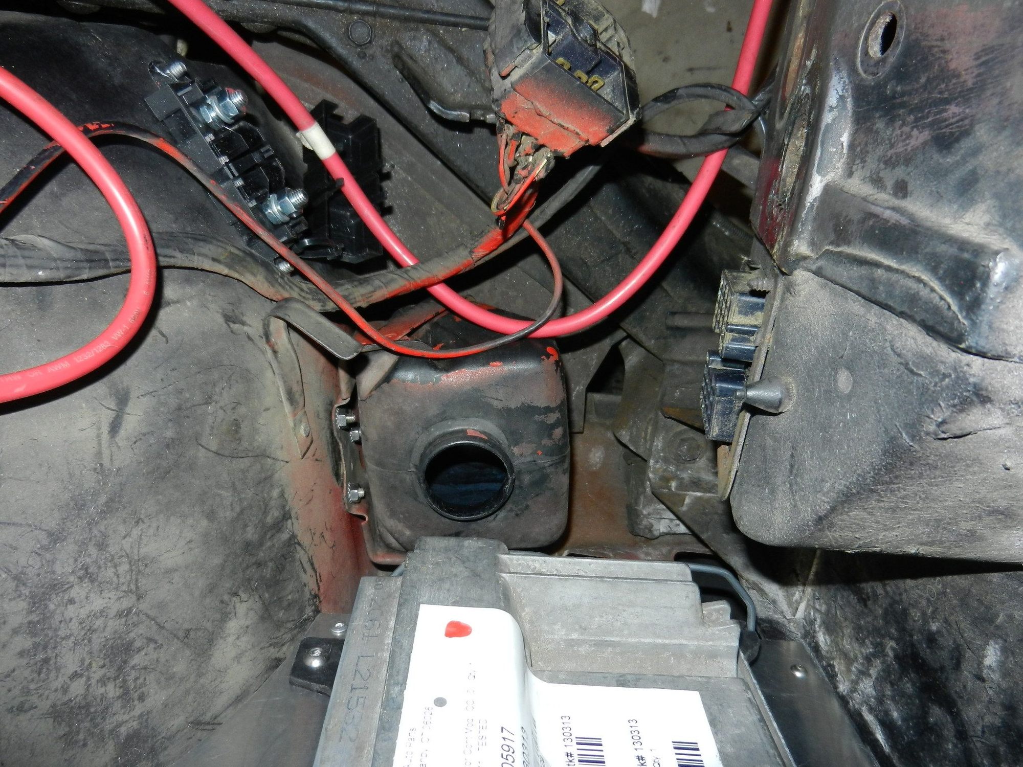

When I installed factory air in my non-air 69 coupe, I just moved the factory square plastic bottle and bracket to the opposite (drivers) side fender. Fits perfectly.
Is there any way you could post a picture of this?
Sorry but this is the only pic I currently have.
I was in the middle of installing EFI so I mounted the PCM in the LH fender at the same time I moved the washer bottle.
Elm
Washer bottle in LH fender.
