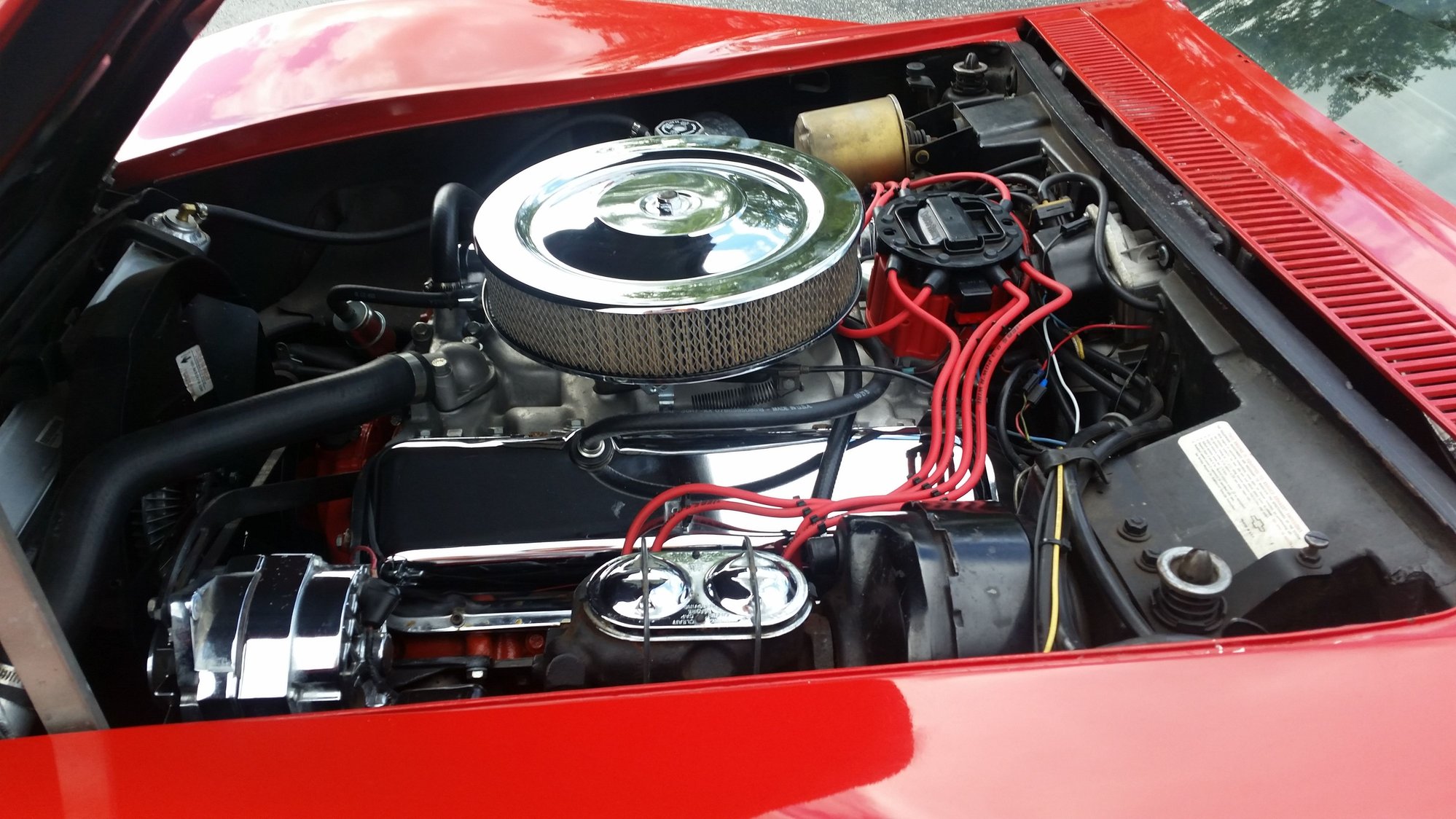

That is in fact the "REAR" … LOL
427 Cu in (on a stand) .. in the car is a 468 Cu in LS6 Heads, Winters Foundry intake , Custom Roller camshaft, ,,750 Demon … Muncie M22 … Wife drives the 79 Z28 pictured as well …

Mike, you have a beautiful Corvette, but get rid of the rubber fuel hose....don't want to see it go up in flames.

Good call 71 Green 454 ,,, I am in the process of replacing the gas tank and sending unit so I will DEFINITELY replace the hoses as well ….
