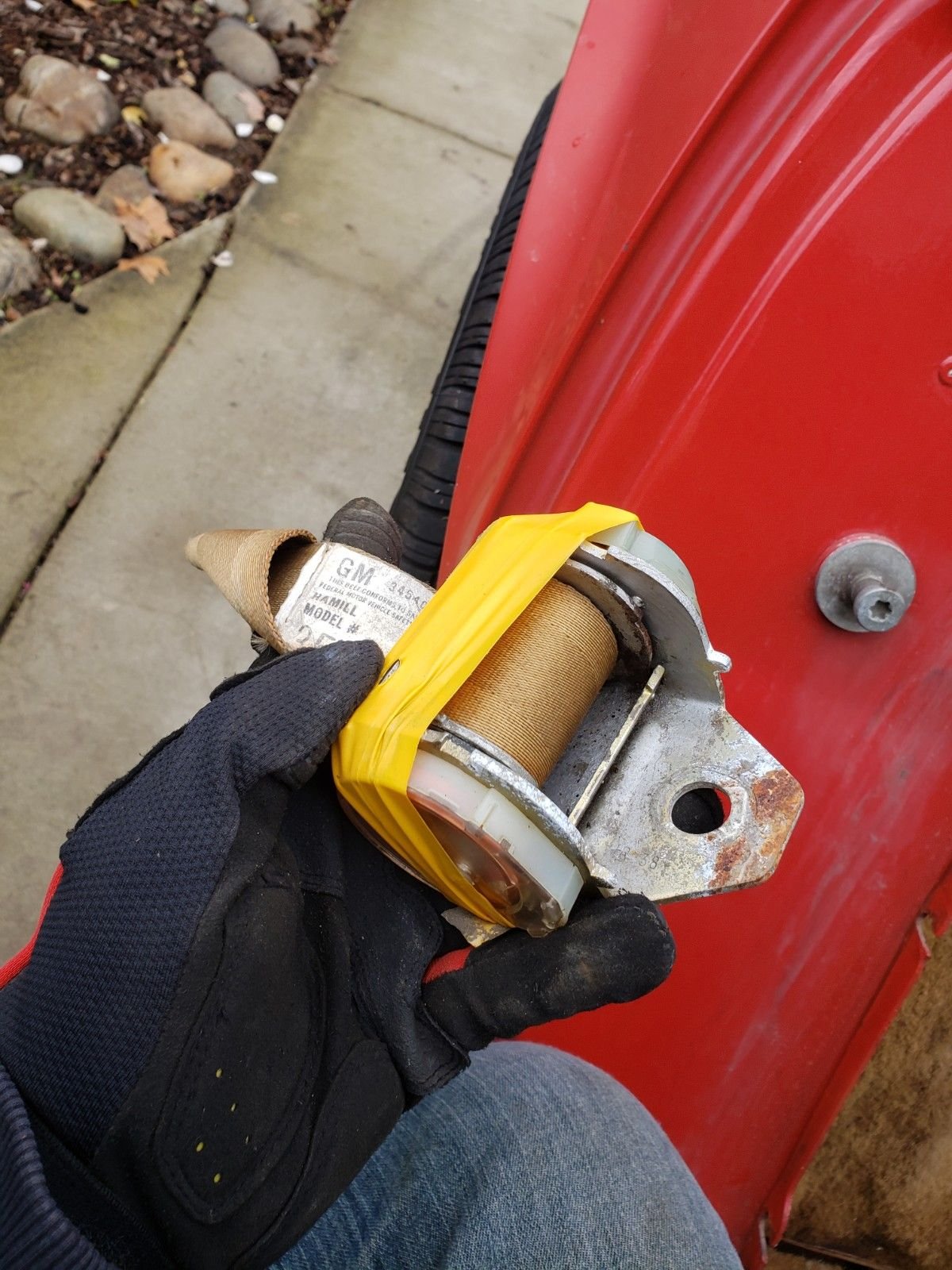

Apparently you can use electrical tape to hold the seat belt apparatus together! My wife was so happy to see this reinforcement.....

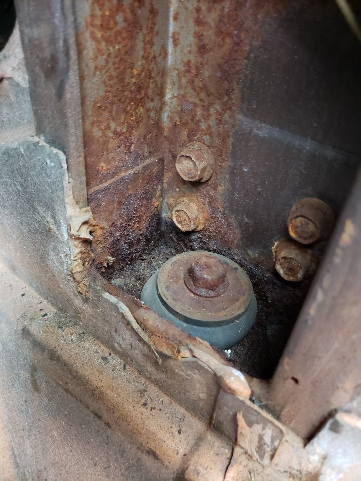

Kick panel rust... acceptable or not?

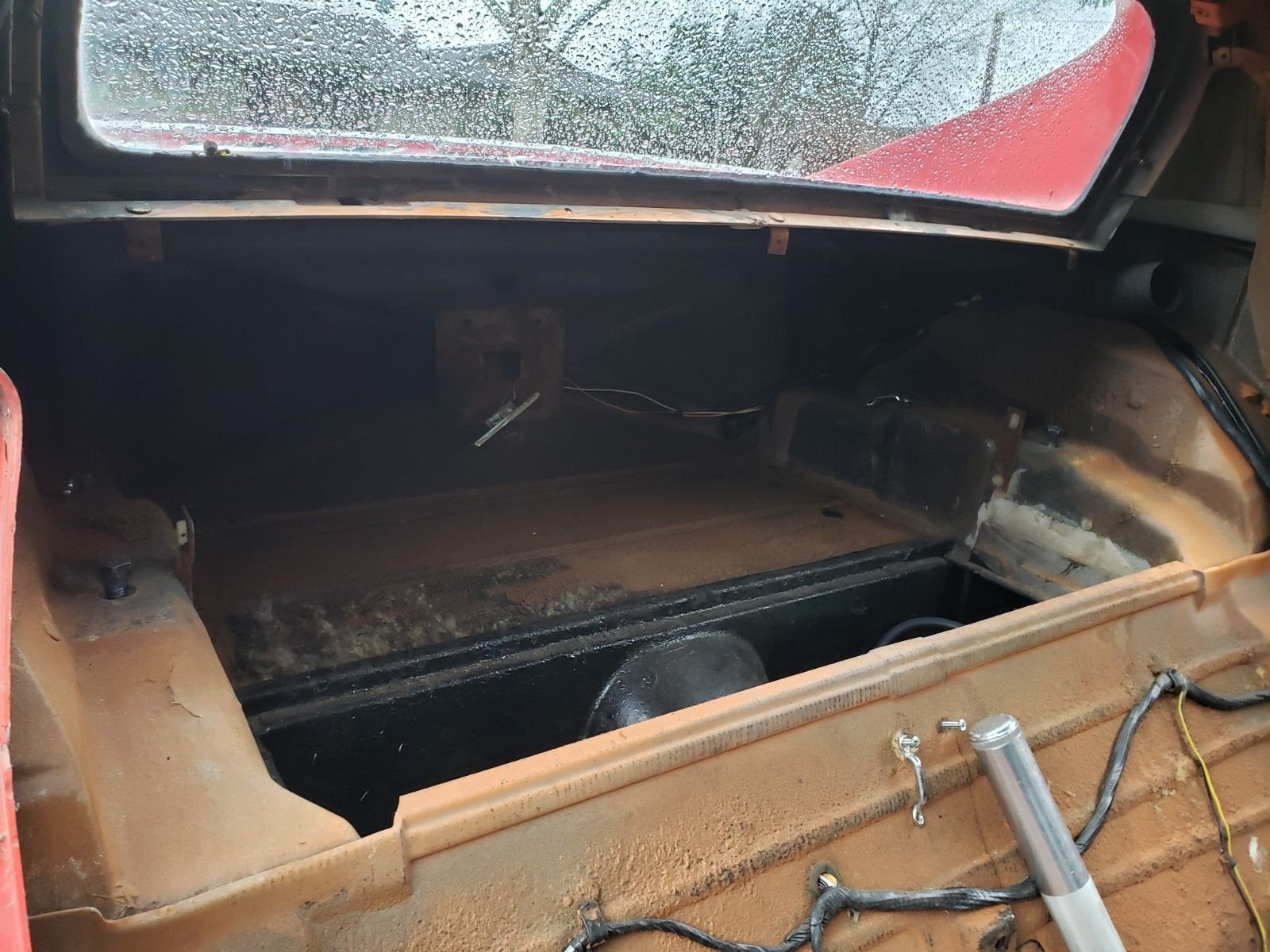

Cargo compartment... weeeeee!!!
