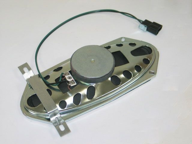

68s and 69s had 4x10s behind the kick panels when the optional radio was ordered. You can use the 4x10s if you want.

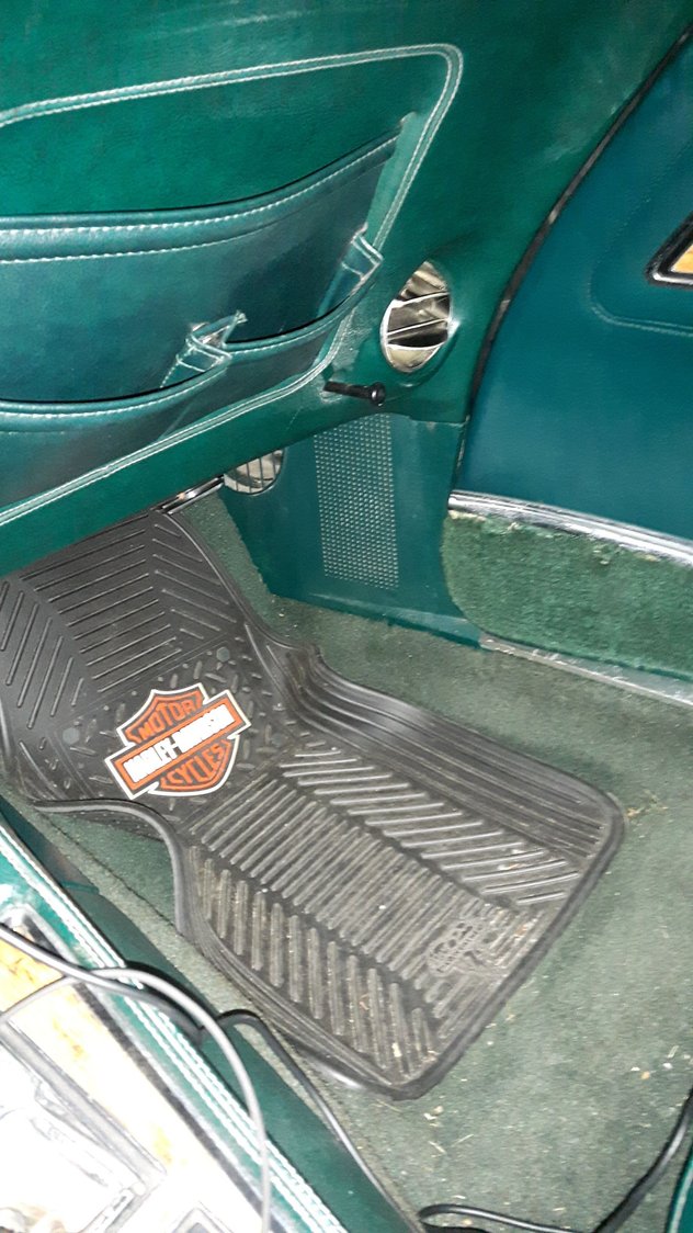

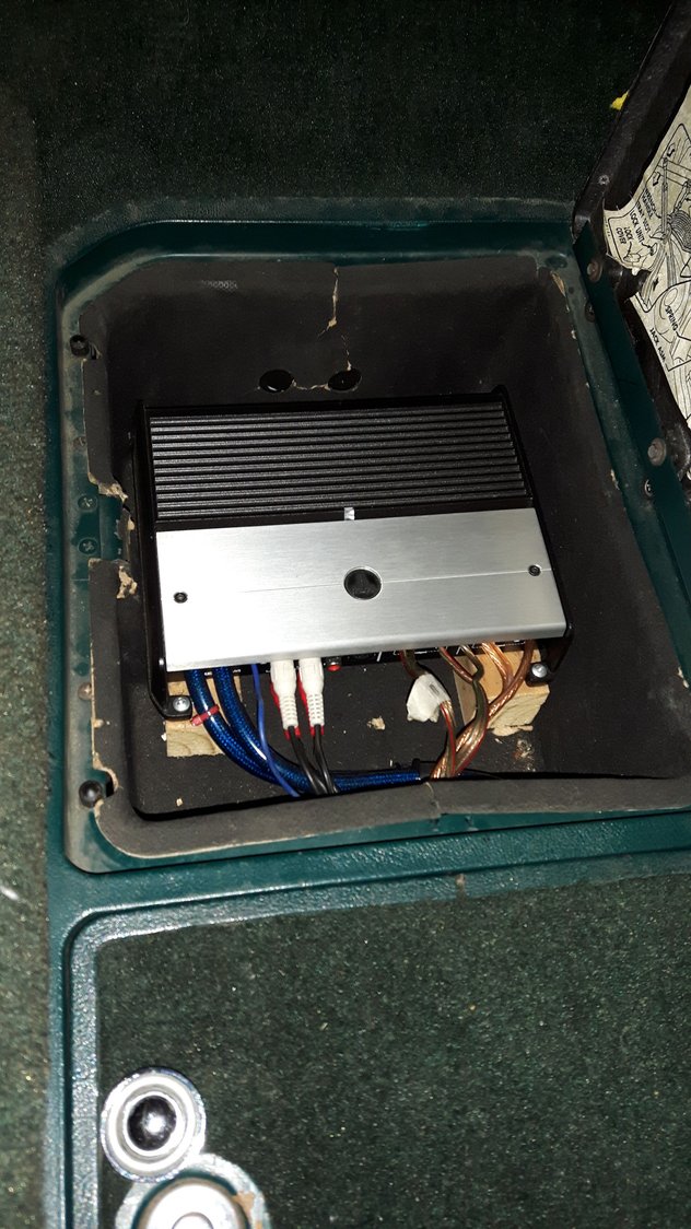

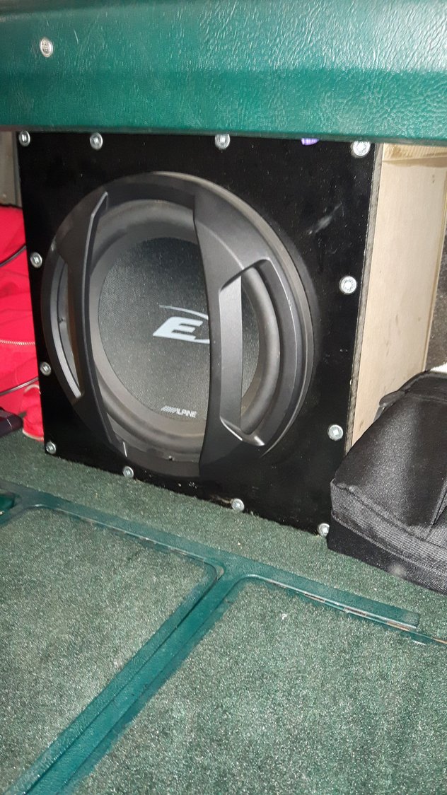

I have shallow 6-1/2" speakers behind the kick panel. No cutting of the opening required. But, I may have had to notch the speaker frame just a bit for a flush fit. Doesn't affect the sound whatsoever. So, a 5-1/4" should mount easier if the speaker depth is not to long. A few pics of my system install.

Very nice, I'd like to do something similar. On the speakers you bought, do you know the mounting depth or the speaker model so I could look it up?

My 4 channel amp is has the two front speakers on separate left and right channels and the other two channels are bridged for the sw. I think you could run front and rear speakers together on the same left and right channels and the other two bridged for sw. Or maybe a 6 channel amp? Two amps? Lol, lots of possibilities. But I will say this. I considered two rear speakers but didn't do it because the vette cockpit is so small I didn't think it would enhance the sound. I'm happy with what I have even though the sidepipes drown out everything, lol. The only thing I would do different is use front composite speakers with the tweeters in the dash. My kick panel speakers are Infinity's, model CS6032 ???? They are no longer available. I have two pairs of Focals, 6-1/2" and 5-1/4" to replace the Infinty's at some point down the road if I ever get the desire to do the swap.
