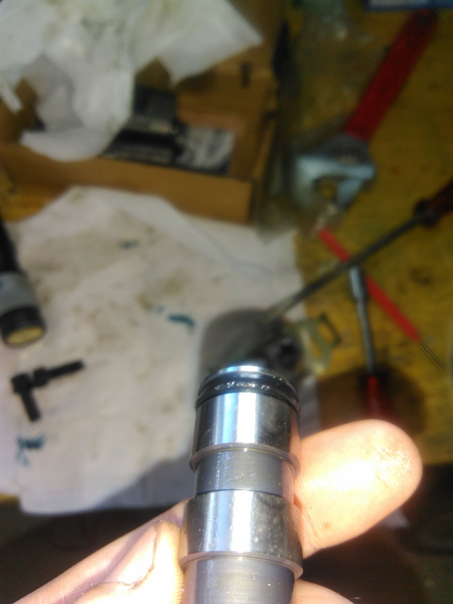

A few months ago a rebuilt my power steering control valve and shortly after found it to be leaking while at full lock. Didn't look at why until today as I needed the car running quickly so i just put a rebuilt valve on from a well know supplier.
The rebuilt valve leaks all the time. The cause for my rebuilt valve leaking appears to be a seal that I must have damaged while installing. Seems strange that the rebuilt valve was leaking as I would expect better quality from this supplier. (at the same time I also think if you want a job done right you should do it yourself) Is it likely there is some other problem on my car or have I just had a bad valve? My old valve leaked from the join between the two halfs (only while steering was on full lock). the rebuilt valve I bought leaks from the balance adjuster. (at all times)

Have just removed my new valve from the car. It was definitely NOT A Lonestar valve.
I opened it up to see why it was leaking. Found the seal at the balance adjustment end had been very badly damaged. There was a few other things that were a bit odd (but not necessarily bad) The bolts were all metric (spotted this before I had it off the car). The nyloc nut for the balance adjustment was thicker than normal (I wonder if this is partly to blame for the damaged seal)

Have rebuilt my original valve but haven't installed it yet. But should be good. I took my time and made sure things were right.
I took apart the new Valve completely for a bit of fun and found some other issues that i hadn't already found.
1st thing to note is that while i thought the nyloc nut for the balance adjustment was thicker than normal it was about the same; however it used an 10mm (0.394") socket for adjustment which is smaller than the factory nut (7/16" or 0.4375")
This is the seal that was leaking. It had similar damage all the way around.
This spring was installed upside-down. Which explains why once I started to pull the valve apart the ball stud seemed loose.
This was all of the grease used on the ball stud. I could be wrong but I would have expected more that than. The valve came with clear instructions that it had been correctly greased and if any additional grease was added it would void the warranty.
