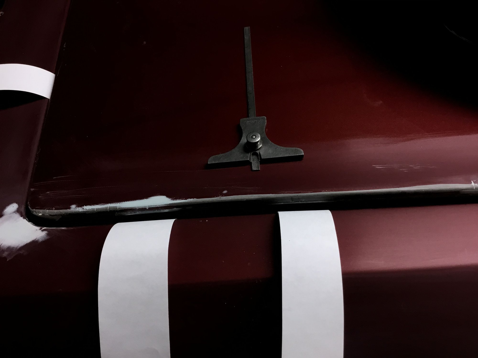

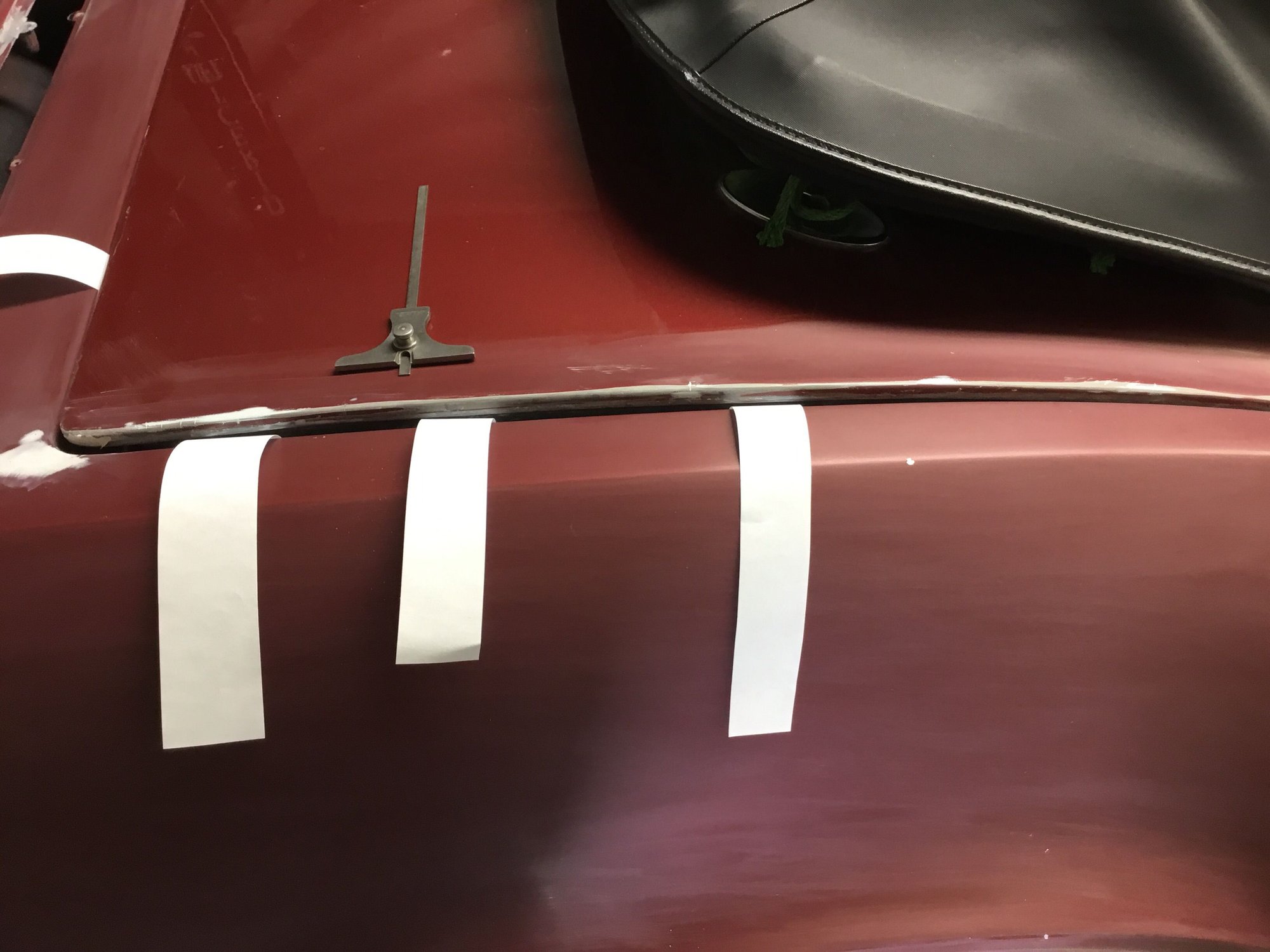

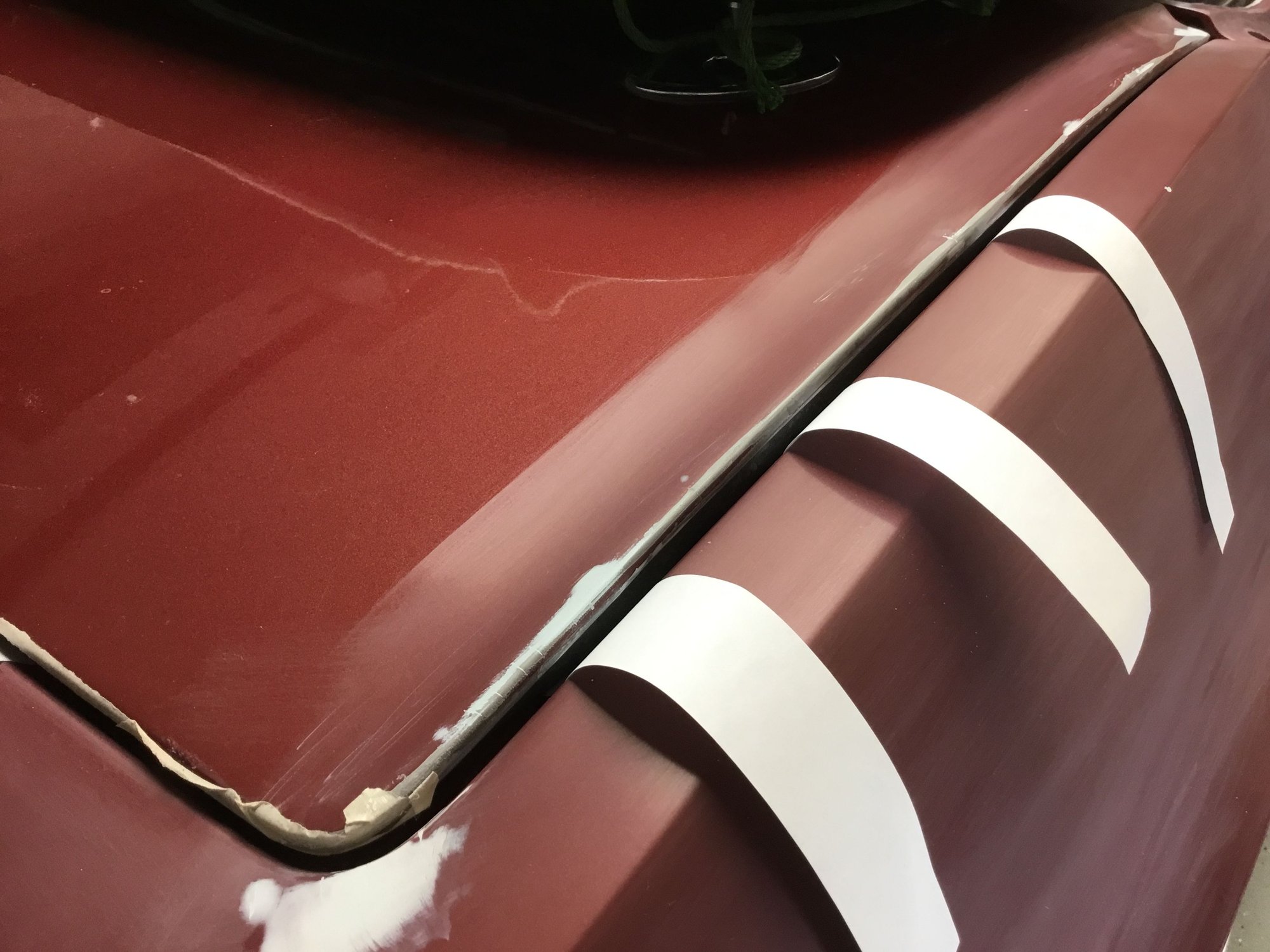

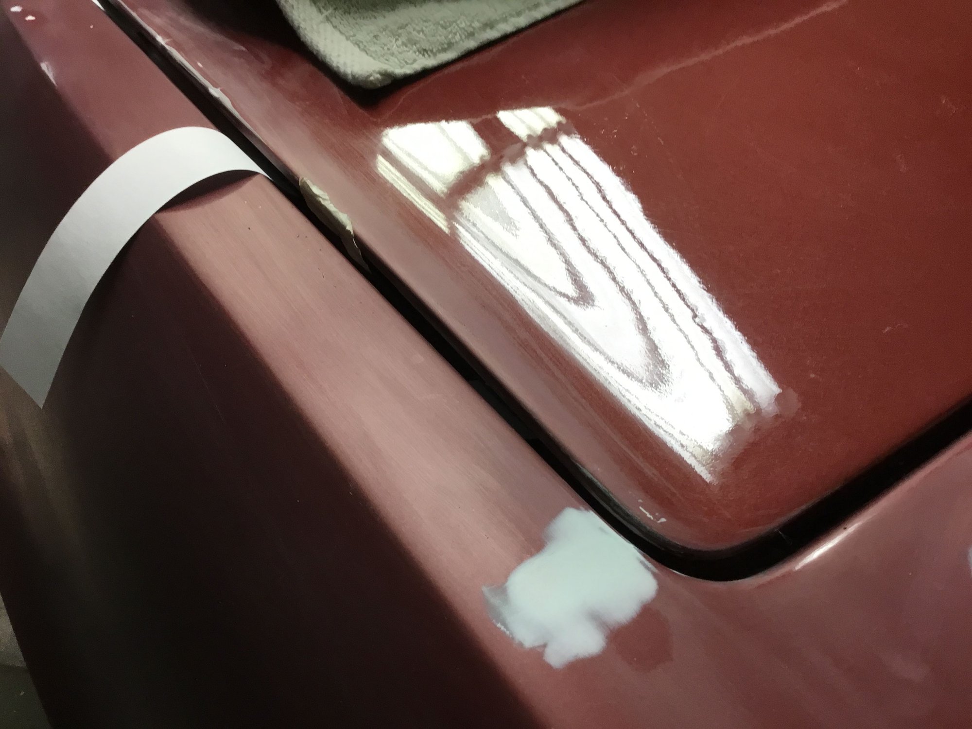

Default Deck lid pictures
Passenger side
Exact 1/4 inch to high
Driver side
Pictures.

Thanks for the photos.
HOW do the pieces of paper strips feel when you try to pull them out..... keeping in mind you want to put the same number of paper strips in the exact same area on the GOOD side to you have a reference to go off of.
Then peaking in under the deck lid in both areas where the paper strips were located and see if you can see any change in how this area looks in regards to the compression of the w/strip.
It all depends on how involved you want to get on this. Meaning if you can live with a shim that is up to you and do as 'Redvette2' did and move on if that fixes you issue. If you cannot live with the thick shim...then it will need more investigating to make it so you do not need a shim.
DUB
