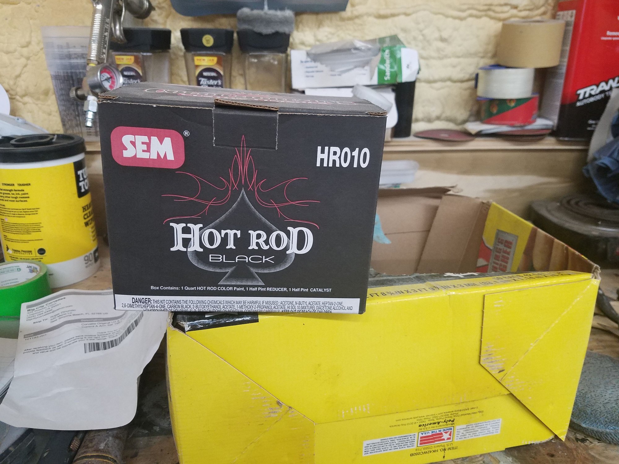

ZIO
Evercoat Finish Sand 4:1 not Slick Sand. Gun tip 2-2.5 @ 35 psi. To be compliant 320 - 420 grit to block.
Door primed, sealer, base and clear same as exterior body.
SEM black matte is closest to original look of many parts like hood, engine compartment.
To get correct War Bonnet Yellow shade needed to stay compliant with formula.
All of the above just to get the correct color shade. Sealer color was very important as well as the correct temperatures for where you are shooting.

You can use semi-gloss black for your 'blackout' paint, if you want. But the stock paint type is semi-FLAT (now called satin) black. Satin black will hide the surface imperfections better than semi-gloss.
If you are into finishing the surfaces of your engine compartment, then you might go with semi-gloss. Otherwise, satin black looks best, IMO.
