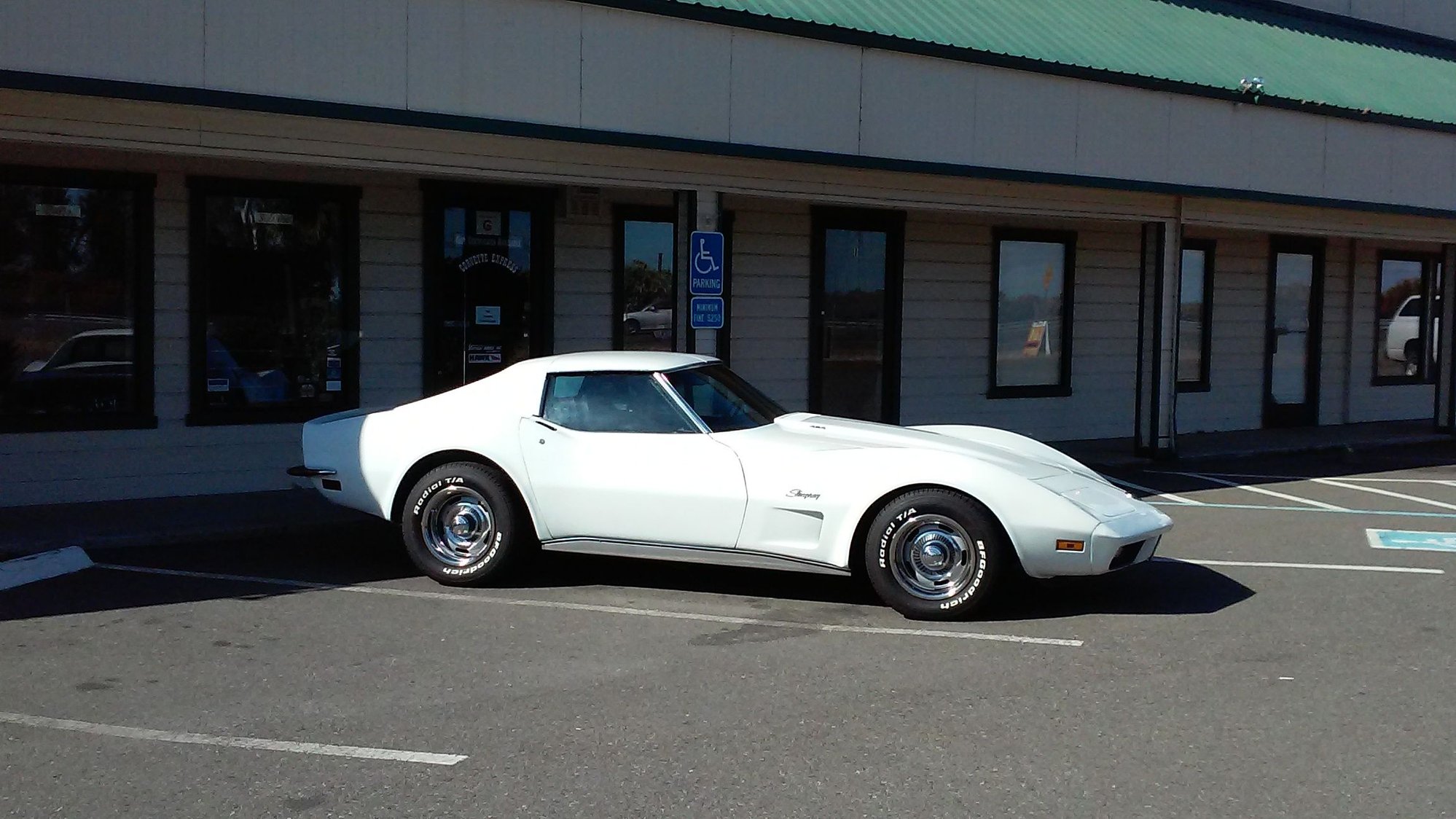

I know you are asking about a 68, but I have a 73 BB with 245-60-15's on the stock 8" rally wheels and they just kiss the frame when the wheels are at full lock.
