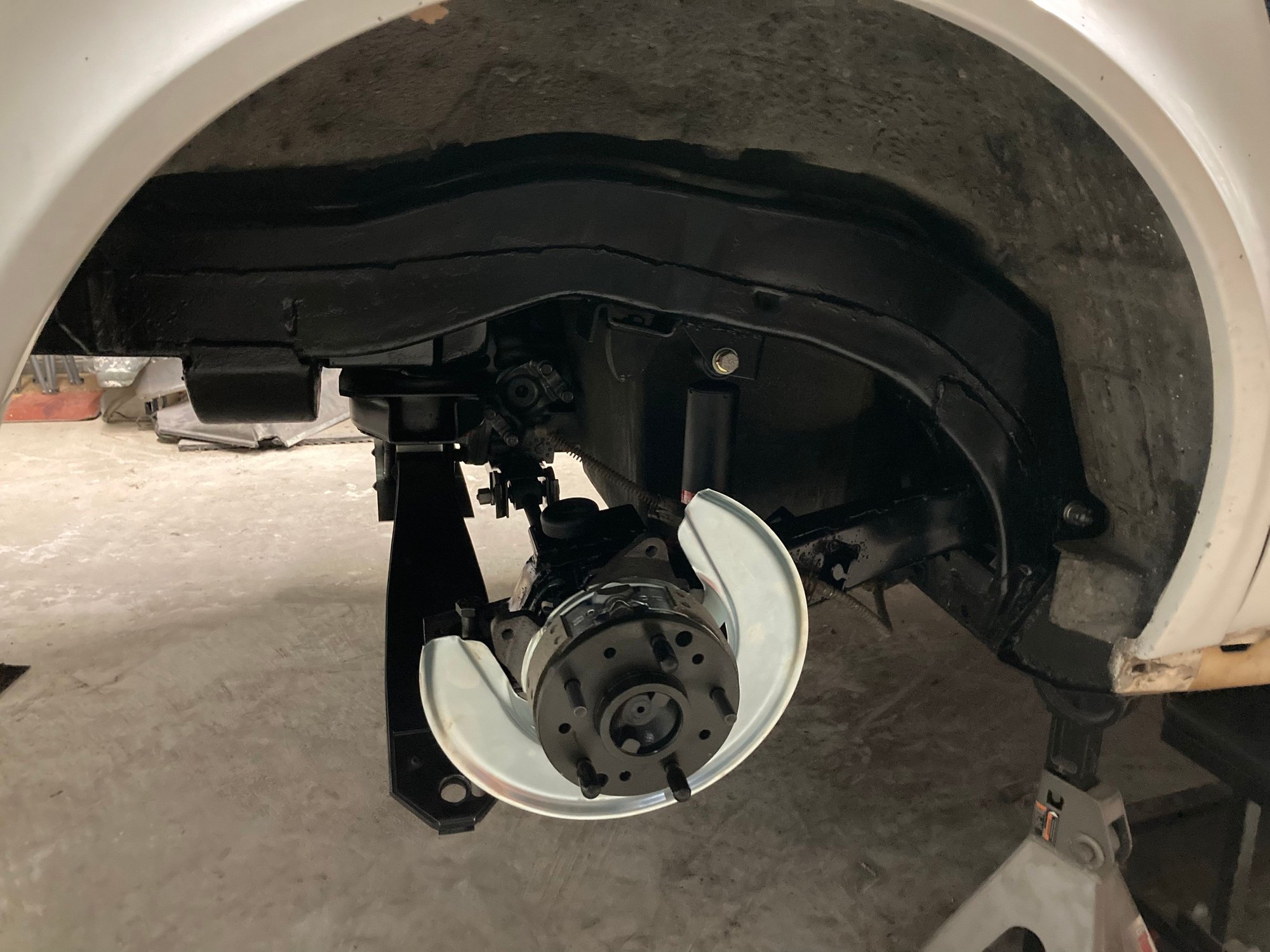

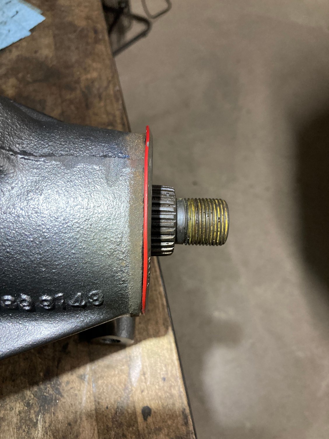

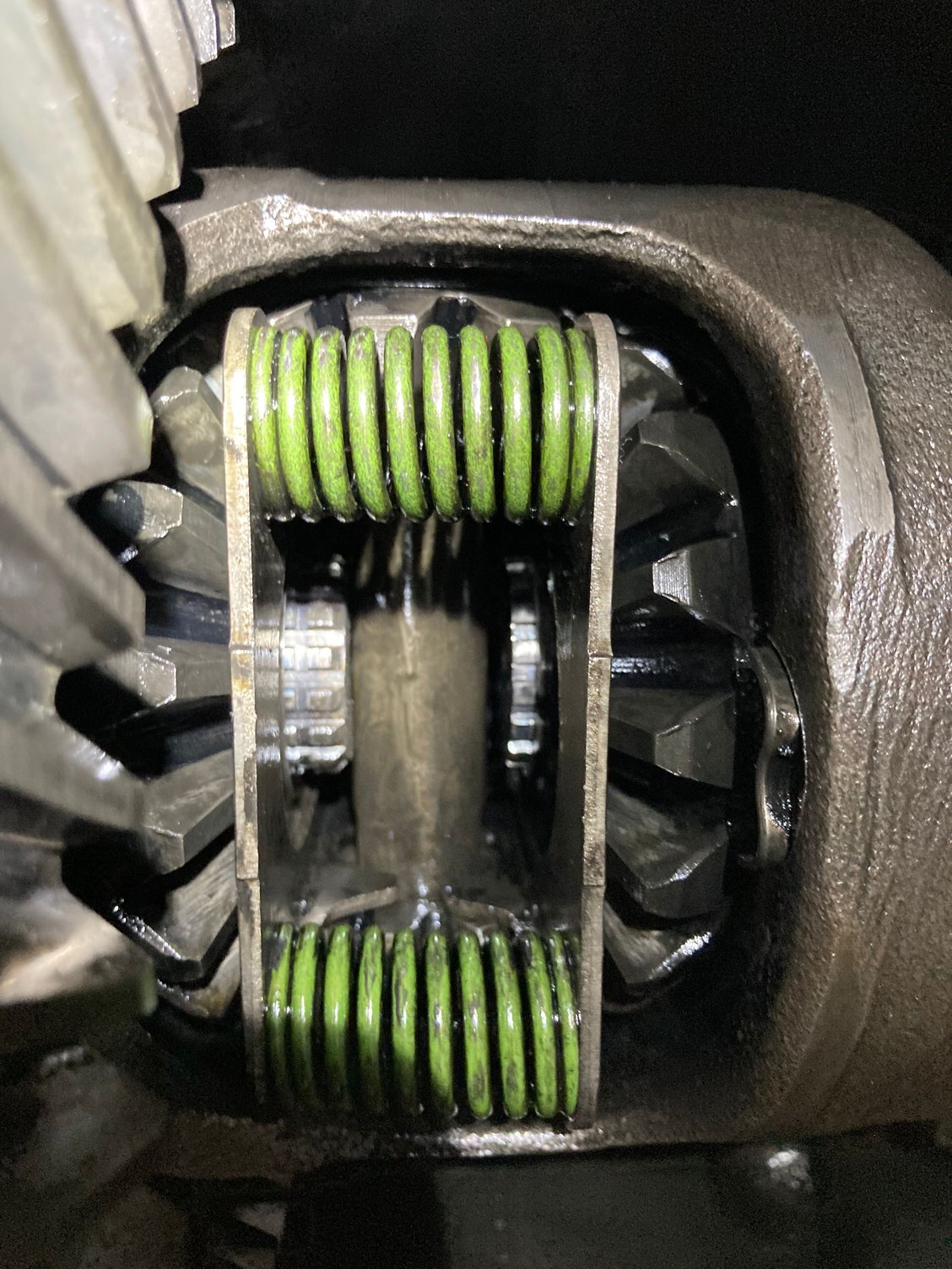

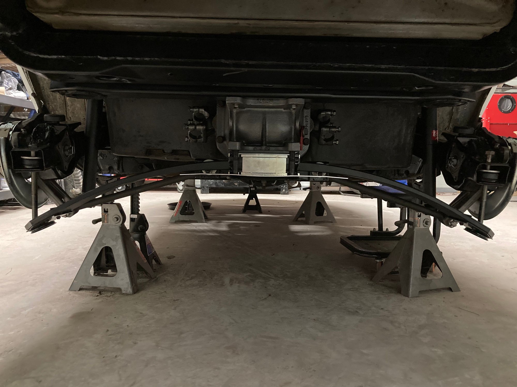

Checked the clutch pack to make sure the posi track was good. Also you’ll notice one side yoke was missing the retaining clip. It wasn’t seated properly by someone and sitting nicely in the bottom of the diff (wasn’t chewed up by the gears).
3 new seals

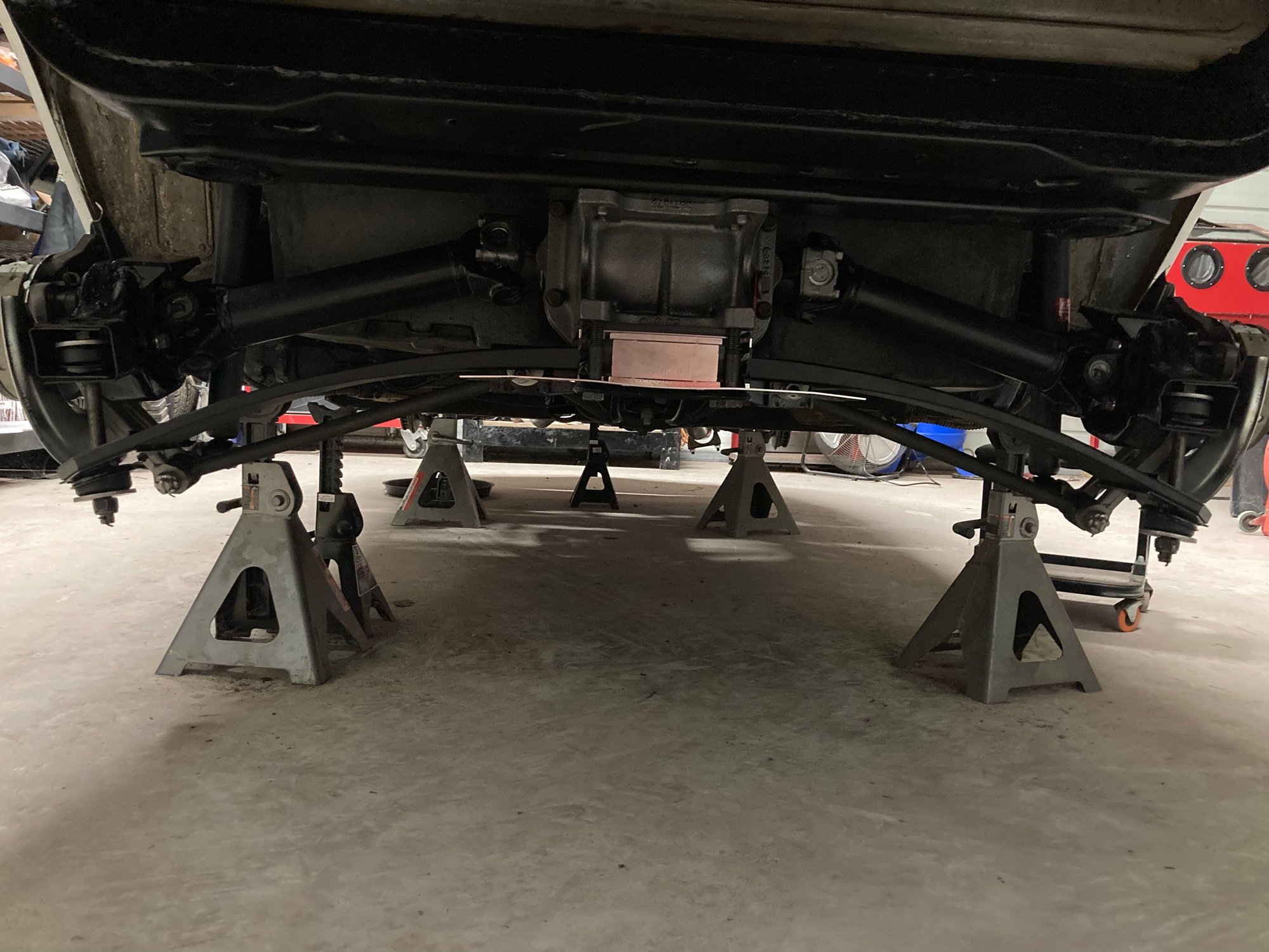

I took the wheel off, put the lug nuts back on to see if I could tell what was going on. I watched while my wife put it in drive (while on jacks) and I could see a noticeable "lump" as the rotor turned. Not sure where its coming from. Even my wife felt the thud as it came around (from the driver seat). I was thinking maybe stuck piston but when we depressed the brakes it was the only one that would still attempt to spin a little which tells me its not biting...but there were also no leaks! This is gonna take some investigating; any thoughts are welcome! (not sure if I can load the video I took of it or not)
Old Feb 3, 2022 | 03:26 PM
  #106
Skootter14's Avatar
Skootter14
Joined: Jan 2019
Posts: 131
Likes: 38
From: NC
Realized the car does not like being put in drive while rear suspension is at full droop. The rhythmic "thud" that was going on was the ever so slight "kissing" of the side diff yoke and the half shaft as it rotated. Got that fixed and also realized when I installed the rotor back on the freshly rebuilt trailing arm, I couldn't figure out why it didn't slide right on like the driver side did. Learn from my mistake: make sure you "reset" the adjustment cable for the parking brake under the center of the car. With new parking brake pads installed, even with the star adjustment pin (for the P brake) bottomed out, you still need to relax the adjustment under the car back to near zero so the cable can fully reset and not be partially activated even with the P brake handle down. Kind of a dummy move but I know now! haha

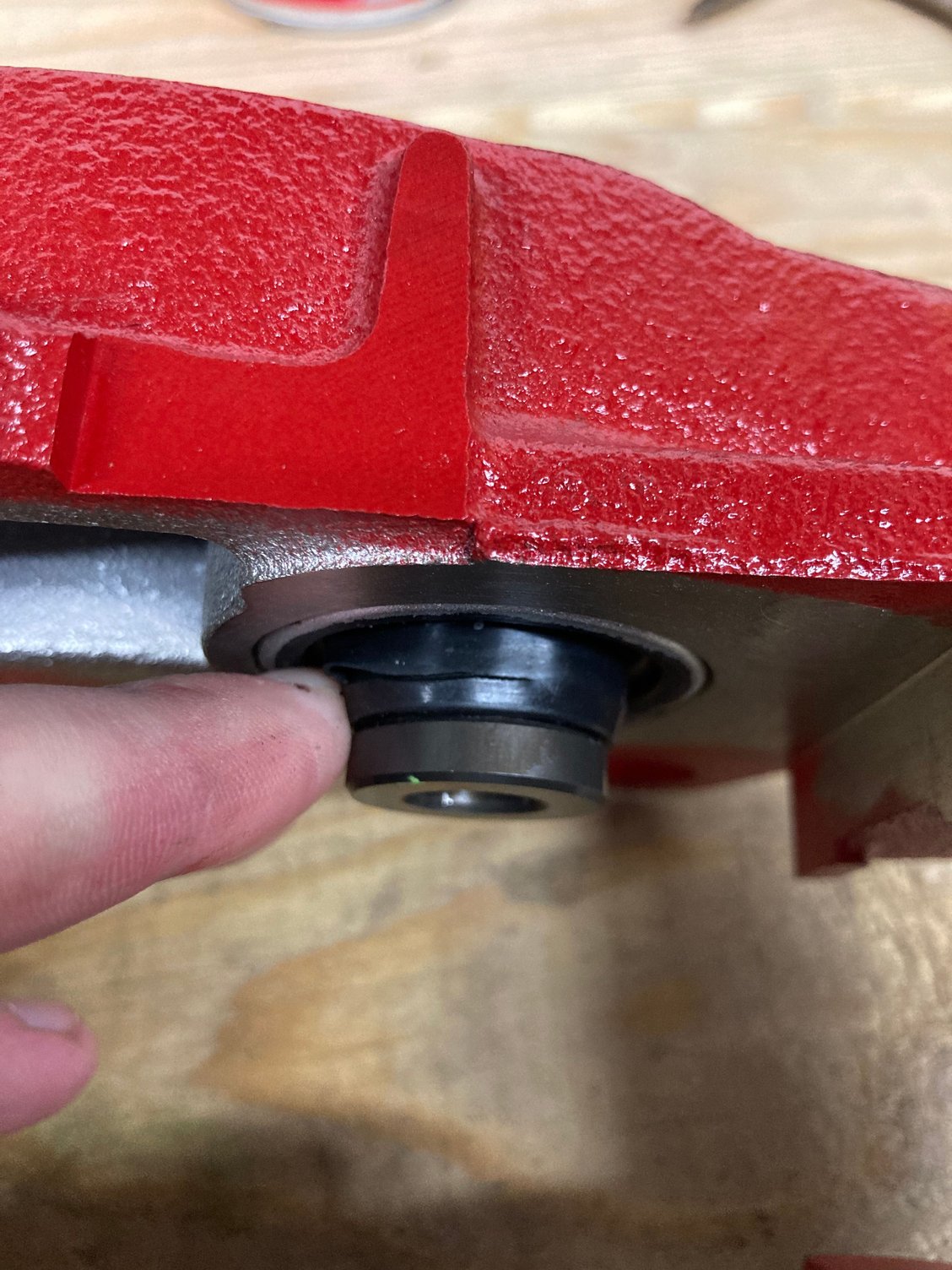

Thought I was going to FINALLY get the brakes all squared away with replacing all the calipers. This has been a process as I would find a leak at a caliper, swap it, bleed them, and 24-48 hours another one would decide to leak.
I figured once I fixed one, there was a new point of least resistance that the fluid would find, signal to me via small puddle, and I rinse and repeat.
Today, I was replacing the last 2 at the same time bc I’m sick of chasing these leaks. Now I know a lot of ppl seem to complain about quality of the remans and I’m no different…quality control has gone down the *******. As bummed as I am about this, looking for the silver lining, I am so glad I found this literally as I was walking it over to the car for install:
I wasted my time, brake cleaner, and caliper paint on this one but it was about 5 min away from this being an even more infuriating event.
ALWAYS check the parts ya get from auto stores thoroughly as I’m a firm believer you will save yourself much more time in the long run by doing so. On a different caliper, I ID’d an unevenly seated lip seal/skirt piece (the metal circle wasn’t flush with the inside of the caliper). That for sure would have leaked immediately. I tapped it back flush and all was good.
I say all that to say: we all know QC is no good anymore. Save yourself more frustration and double/triple check stuff before ya install it.

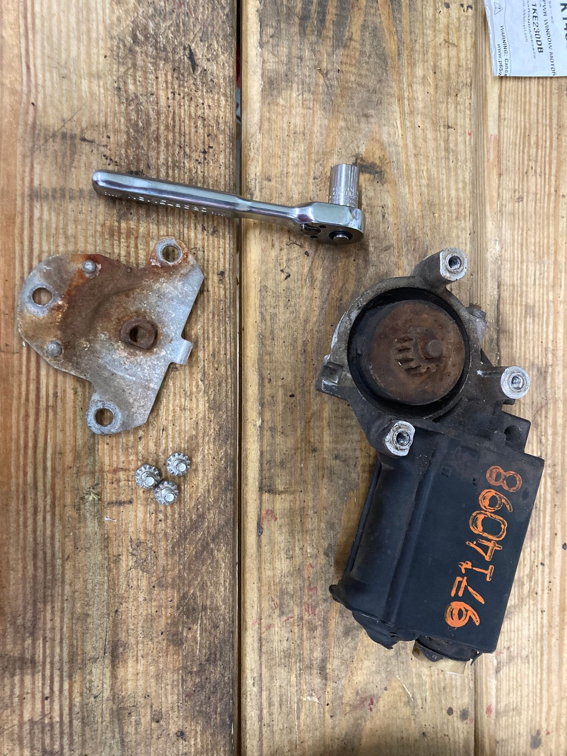

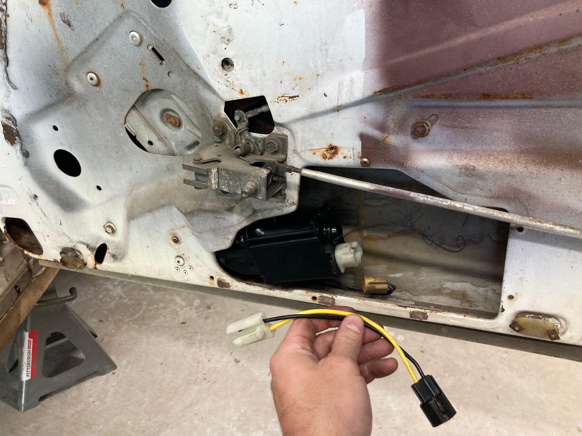

On a better note, my new passenger PW motor came in and I got it installed. I was able to only swap out motors and not have to remove window tracks or anything…so it CAN be done. I used some grips to hold the window in the UP position as that’s where mine was currently at.
(Make sure the window is secure if you do this method or the window will FALL when you remove the motor from the pie shaped metal plate that moves on the sprocket in the motor!)
Window goes up and down strong and quick. I tested everything between the switch and the motor to first determine everything was getting power and the motor was dead. Job took no more than 30 min.

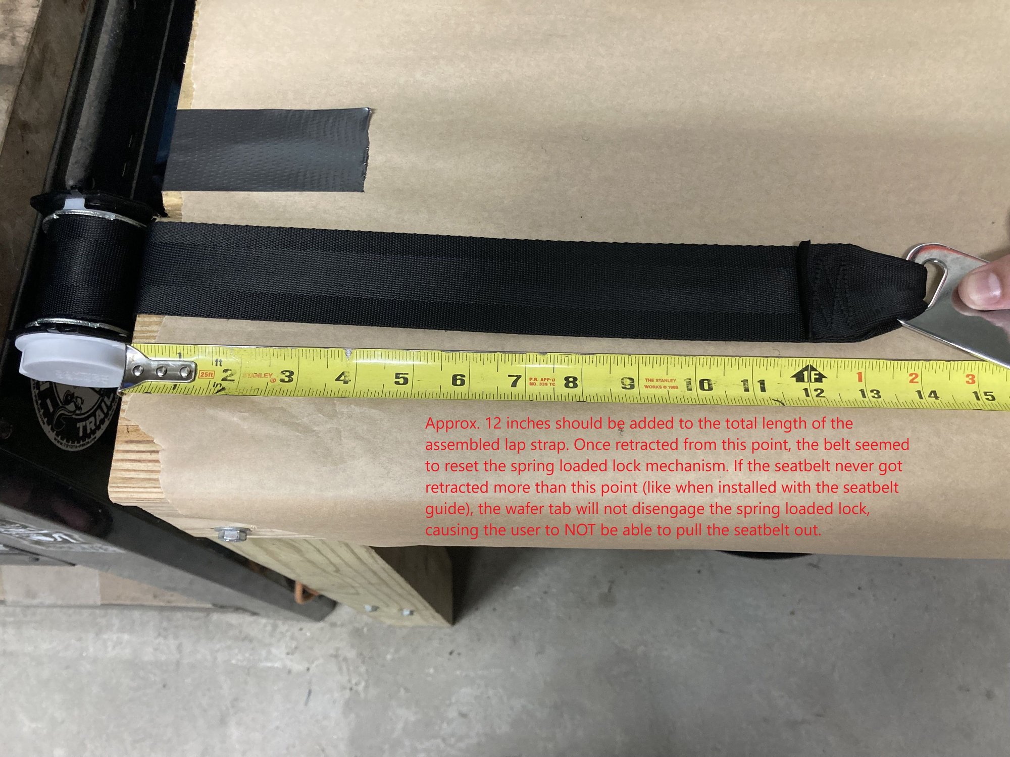

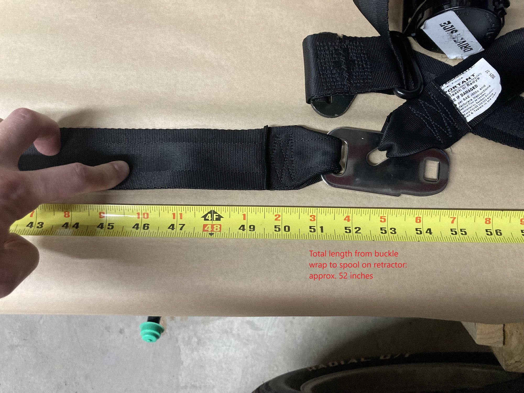

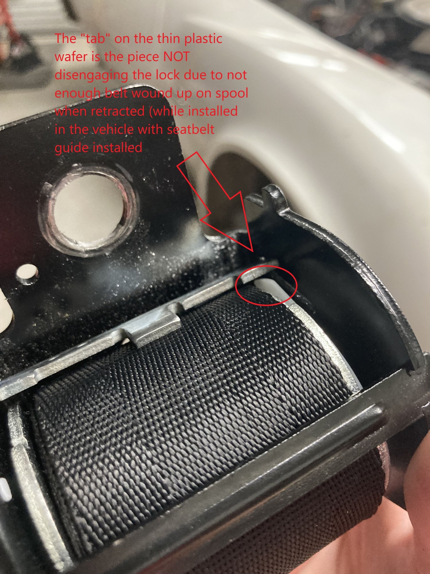

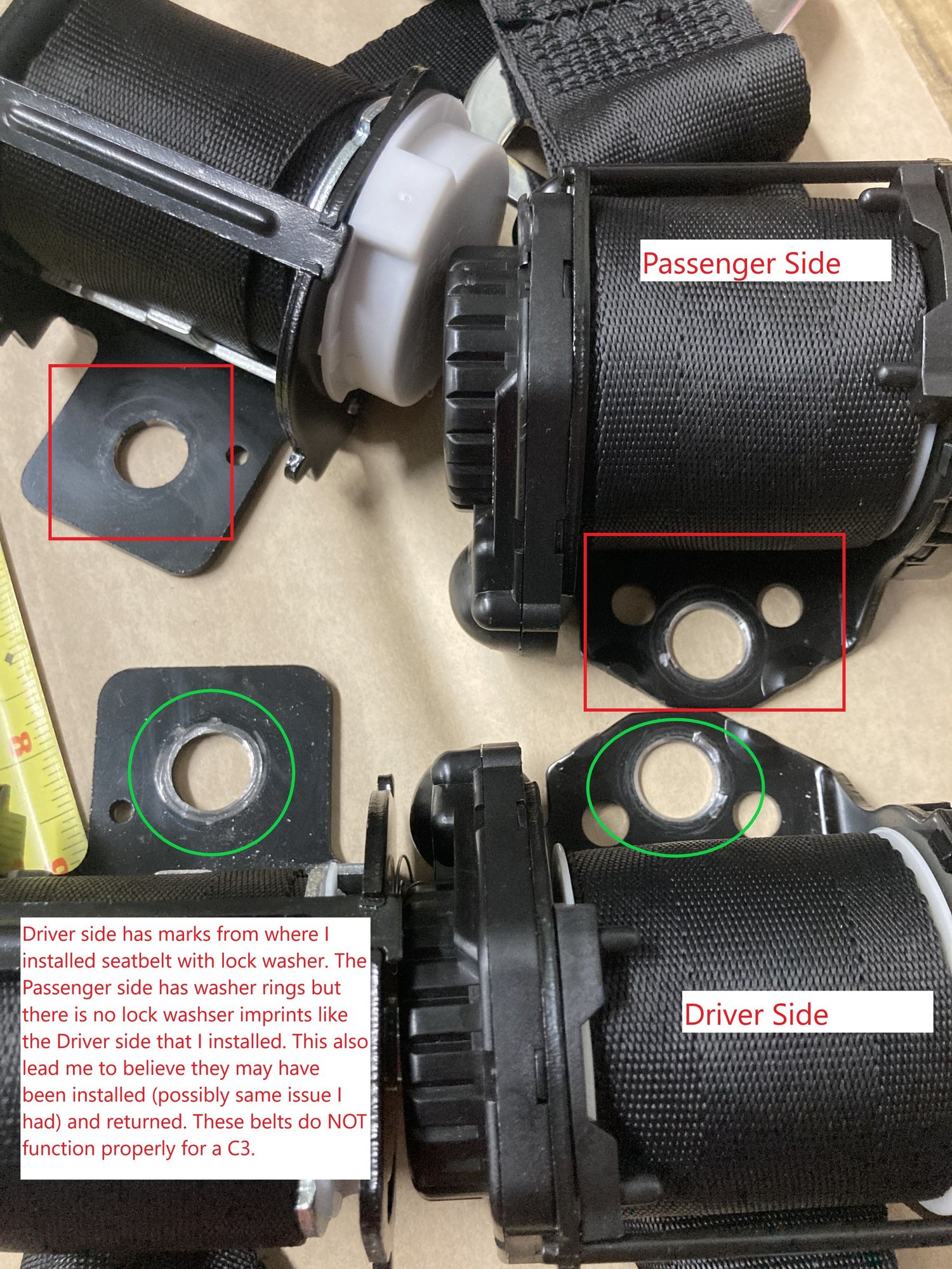

I'm still working through the seatbelt issue with Seatbelt Solutions. For the time being, I will just post what I have sent them (amongst phone calls) in my effort to try and HELP the company do the right thing. Once everything is complete I will go through the experience.
Video is also attached. I don't know what else more I can do.

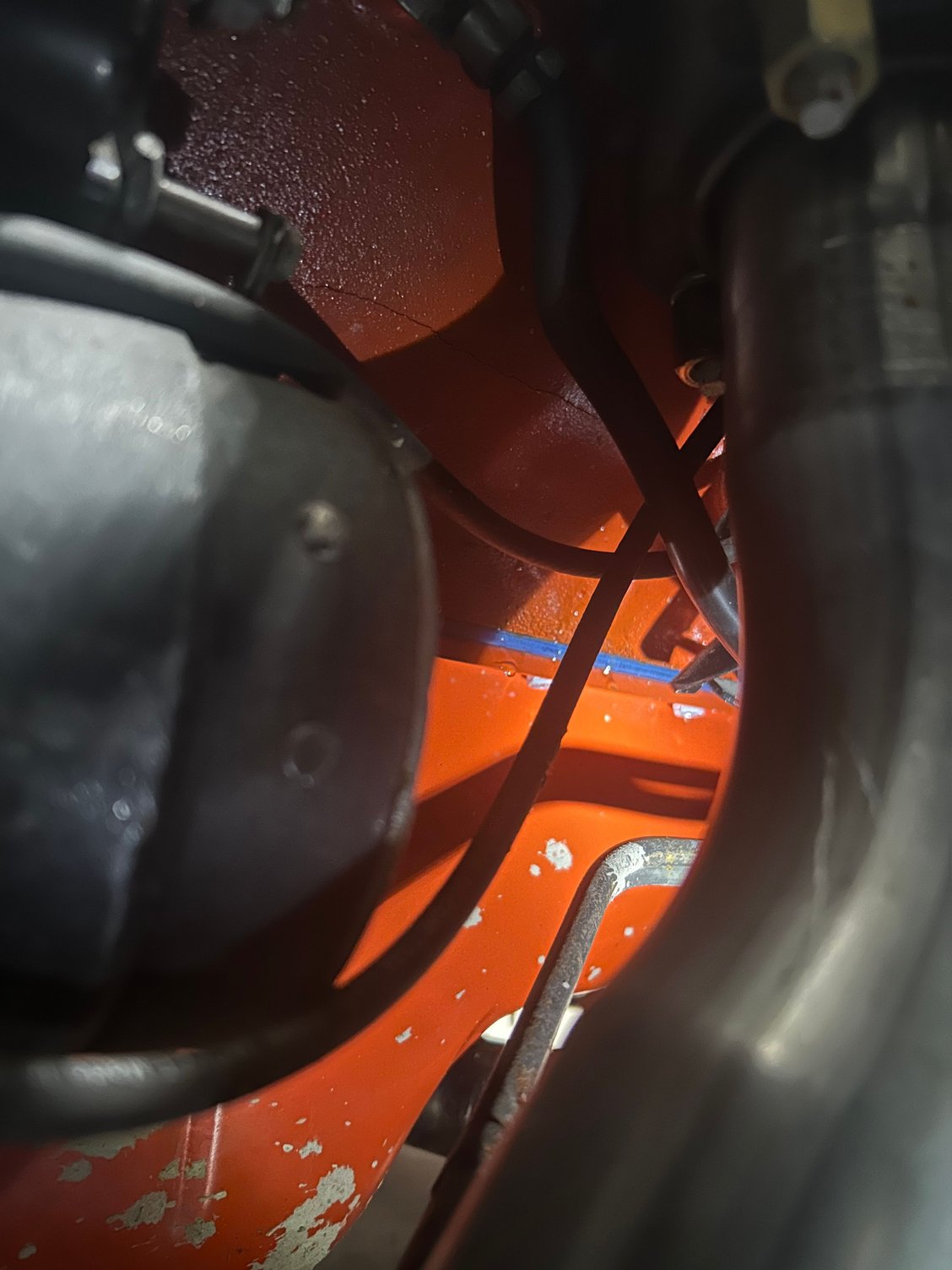

Been doing a lot of stuff in the last six months...just never updated this. I've moved on to cleaning/re dying the interior and FINALLY got the car driving to work on nice days. Got a fuel leak the other day...found out it was coming from the fuel vent that leads to the charcoal cannister on the driver side. The bottom of that vent cracked and was just spilling fuel out after filling up the tank.
Dropped the tank, replaced the vent (today) and as I was reinstalling the tank and connecting the lines, I discovered a trail of water coming from under the car. Thought "great, I have yet ANOTHER heater hose leak." I wish it were that.
I identified the fluid coming from the cracks on both sides of the engine block................................... .....my build is now dead in the water. I now have to figure out what direction to go in as this is my first restoration. Merry Christmas to me I guess. Thanks to this crazy cold wave through the south.
If anyone wants to put a 350 SBC block on the "Pay it Forward" thread...I know a guy who could use one......numbers matching '74 is out the window.

Are you sure the block is cracked?
Could it just be the head gaskets or freeze plugs?
Even if it is the block, 350 sbc blocks can be found at almost any speed/machine/engine shop for under $500.00 that have been cleaned, checked and ready for a build.
If you reuse most of your oem internal components, heads etc, you can usually get everything done for around $2,500.00.
Better to find it now than later.

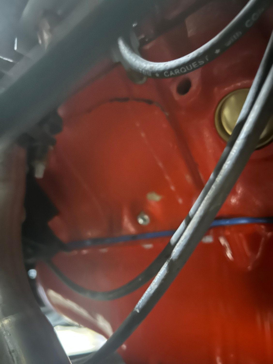

Unfortunately there was a dead giveaway:
Passenger side
Driver side
Once I get over this huge set back, I plan on gutting this engine and putting everything from it into another block, once bored 30 over. I don’t know how much the block will cost but I better be in it under 2500 if I’m rebuilding my own engine!!!
