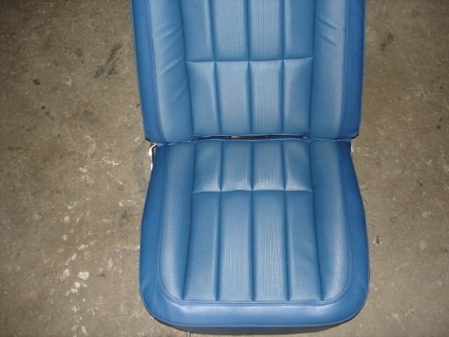

I've never needed to use a heat gun to install vinyl (or leather) seats on a car, compression of the foam as mentioned above is critical but what is even more important is that your roll the cover over the back instead of trying to pull it over. If you pull it over (and I've made this mistake years ago) you'll tear the stitching out of the cover.
The videos are awesome on how to install the covers and while they make it look easy there are a few other tricks to doing the installation. I'm working on a page to go along with the video with a few of these tricks but I'll cross them here for now but remember that guy in the video does one job... he install's seat covers.... My gosh, look at how large his hands are... catcher's mitt comes to mind... so he uses these hands constantly.
Okay... so a little info, they only let me do two jobs here in the shop and both are because I'm too old and tired to teach it to the younger guys... One of them is soft tops (which I hate... did I say hate... yeah I hate doing the tops and have three scheduled in the spring) and the other one is seat covers which I like.
In the video the guy that calls out the clips sizes makes mistakes on the size of the clips... so it is very important to make notes of the original clips when you take the covers apart. It's funny(well it's really not funny I'm just used to the issue) I have boxes of these clips and have marked on the outside what they actually are and also what the CA guy calls them by... it avoids confusion for me and best as I can, remember I do all seat covers so remembering which one installs which way caused me to type up a sheet for each year.... but since the videos came out, if I get confused (and admitting so... yeah I often do), I just take the laptop on the install table and fire up the video...
A few tips.
The Z clips that hold the covers to the frame.... If you use two screw drivers and bend them open a bit they slide in place easy.... Once installed on the binding you can then crimp them tight with your hog ring pliers assuming you have a pro set of pliers. The cheapo's won't do it.
While I made a tool years ago to install the clips, the hook tool is a must... it's funny but the reproduction tool is almost 100 percent like what I fashioned years ago from watching another installer do the install.... that tool is a must.
When installing the & clips (I guess that's a good way to call them) but the clips that hood to the rods and listing to the back of the seat covers... there is a cheat trick to them as well... Take a pair of pliers and twist them just a tiny bit.... this gives you an open style loop and makes it easier to install though the listing. BUT.... you should also take a pick and poke a hole in the listing before you install them. because that makes installation even easier.... You don't need to worry about closing them up when you install them the tension when installed will keep the clips intact. The listings changed about a year ago and while I like them they are also harder to pierce with the clip so this will give you an advantage.
Watch the video, the guy makes it look easy but one mistake that most customers make is the size issue caused by the guy on the video calling the clip the wrong size but the major issue is the use of the clip tool. If you watch the video closely you'll see that he doesn't pull the clip up and over.... and if you do you'll break clips. You don't pull them up and over, you pull them up and flip them over with the hook tool. If you don't do this you'll break clips and swear they are too short.... All the clips are 100 percent correct in the CA installation sets.
While you'll think the cover won't roll over the backside, it will... just take your time and roll it.. .don't pull it. And... vinyl covers will split way faster than the leather covers.
Amy more questions, just post back... I've probably done 15 sets last year and three since Jan.
