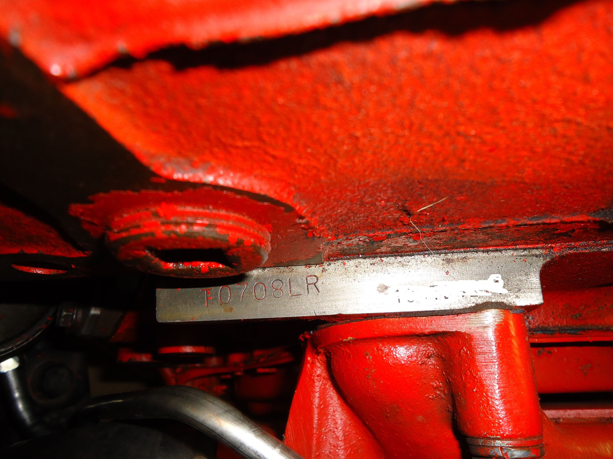

The date and engine code are on the block deck in front of the right cylinder head. This is my 435, July 8, 1969. I did blur out the vin, but your vin stamp should match the vin on the windshield pillar. I don't know how visible a 427 with a/c is.

Thank you for the photo, I found that spot, but it is completely smooth. I cleaned it off and looked with a very bright flashlight but it is just smooth and shiny. With the upcoming weather I'm going to finally get some photos up. Sorry for the suspense, I've just been very busy lately.
