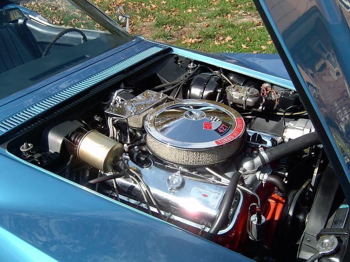

On my 68, you can see it just to the right of the master cylinder.
