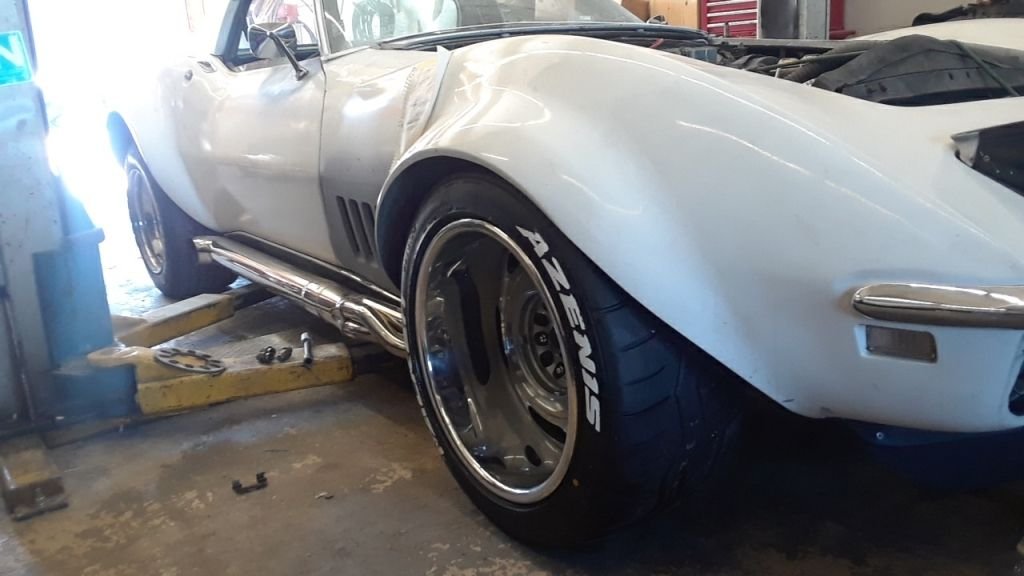

Hey guys, is there any preference for spray paint for doing touch up? I need to paint the areas of the side gills and side view mirrors since they were glassed in and those areas are gray

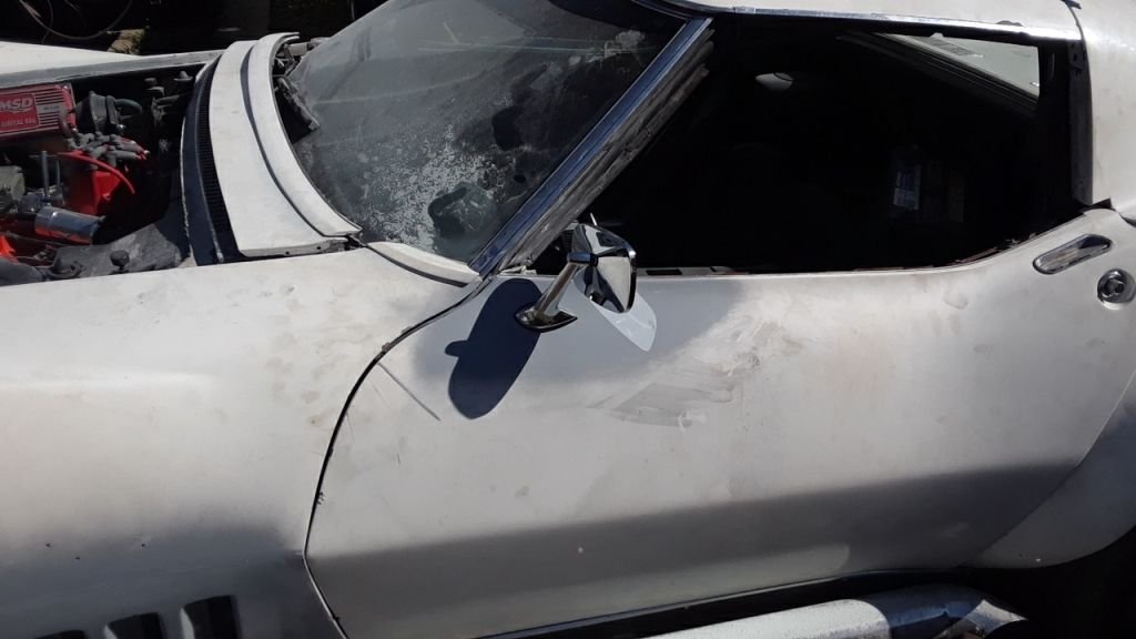

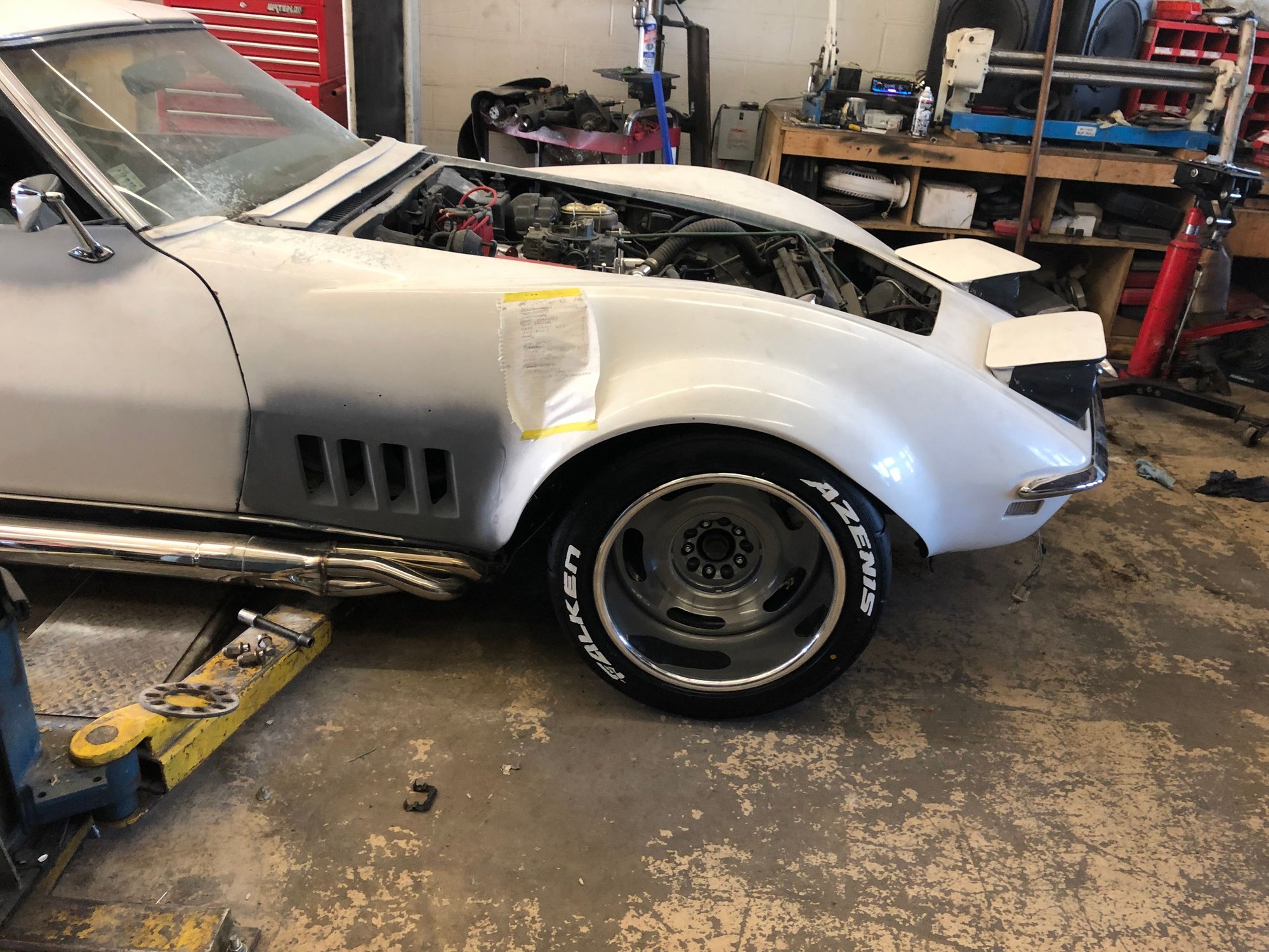

I have no clue what kind of paint it is. Underneath the white I can see dark blue where it’s been chipped and behind the door panels it’s a copper orange colour.
The paint is bad, the clear is coming off on some parts exposing a matte finish. The quotes I got for paint are $5000 plus and I don’t have that much to spend in the near future.
Here are are some more photos.
