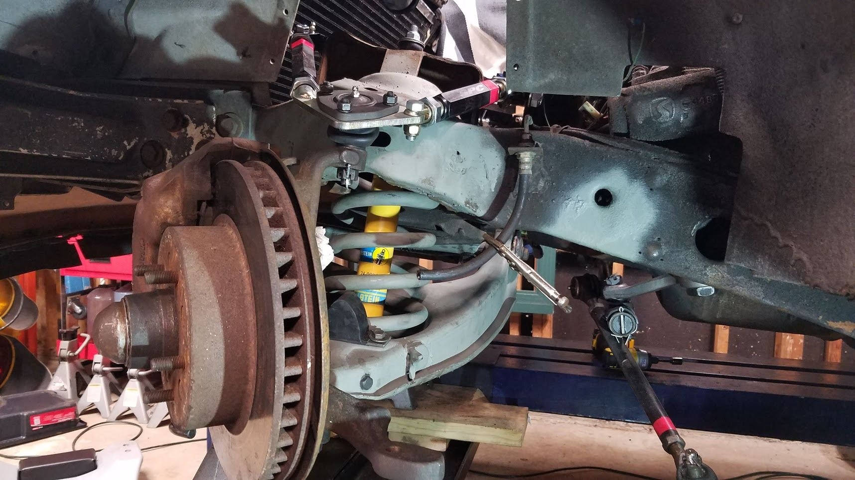

I just did mine! (Photo below).
Read this thread first (not my thread, but useful):
https://www.corvetteforum.com/forums...all-joint.html
The tool that saved the day can be bought separately, or part of a kit, like the kit I bought from Amazon.
Though I do have an air impact wrench, DeWalt makes a great 3/4" impact that takes the 20V Max batteries that I already had an investment in. Not cheap, but there's no hose to drag around. I paid a bit less, and it came with a battery on sale at Home Depot. This made taking the old arms off a LOT easier.
Finally, I installed 550 lb springs, which were just short enough to make it easy to get the upper and lower A-Arm together without too much grief. I left the shock in during the uninstall of the old spring (much more dangerous, but it worked out), and put the new (Bilstein HD) shock in during the install of the new spring (much easier). In the photo, I'm on jackstands on top of a Kwik-Lift. Working from jackstands on the ground might actually be easier, as you can drop the other end of the lower control arm down to relieve spring pressure.
I had a set of arms prepared beforehand, so I didn't have to do anything to rebuild my old arms. My upper A-arm was new, and my lower had already had the ball-joint replaced, so I didn't have to grind any rivets, just bolt it together. Good choice on the Moog components. I had a set of ball-joints kicking around from a front-end rebuild kit, but the old set lasted for 40 years and 120K miles...

Great ideas! Thanks everybody! Pic looks awesome!
