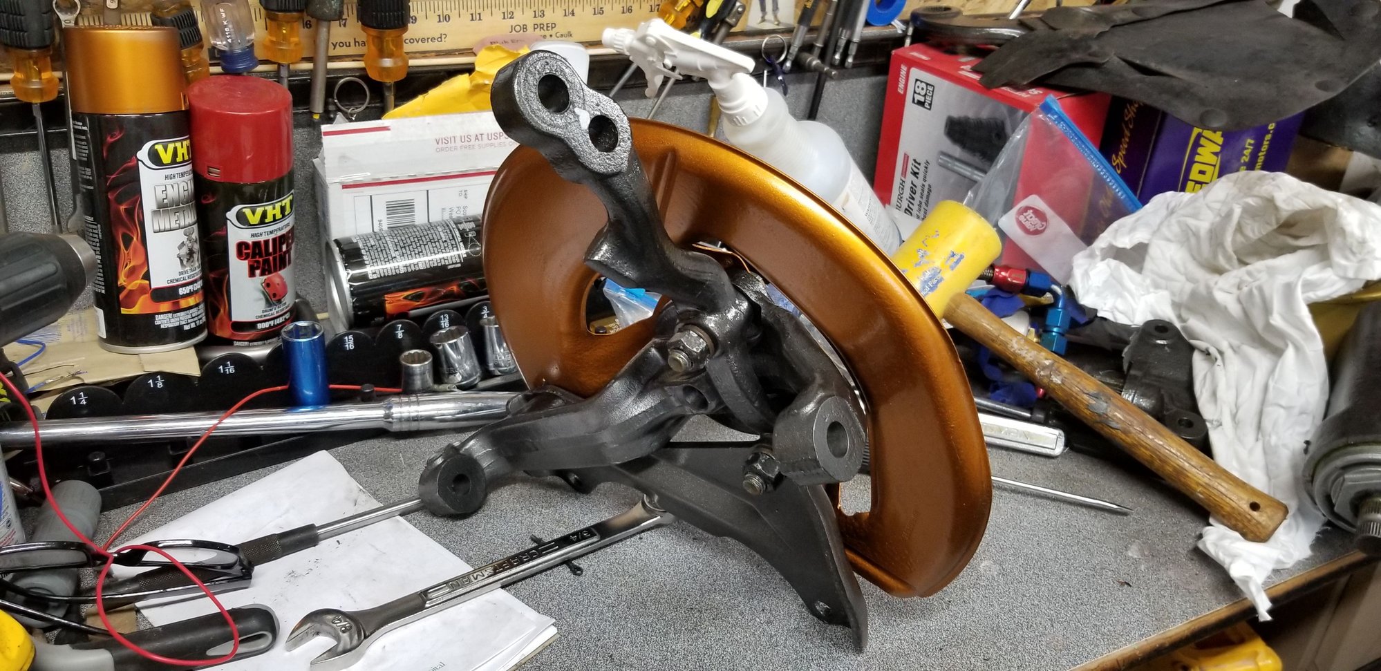

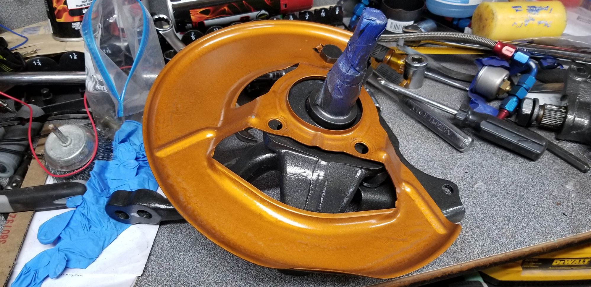

on both front hub assemblies , the steering arm that the tie rod end goes in has 2 holes the hole at the end is the manual or slow steering ratio. The inner hole is the faster and power steering hole
this is a view from the bottom
Ok I understand now. I wondered why there were tie rod end holes on the spindles.

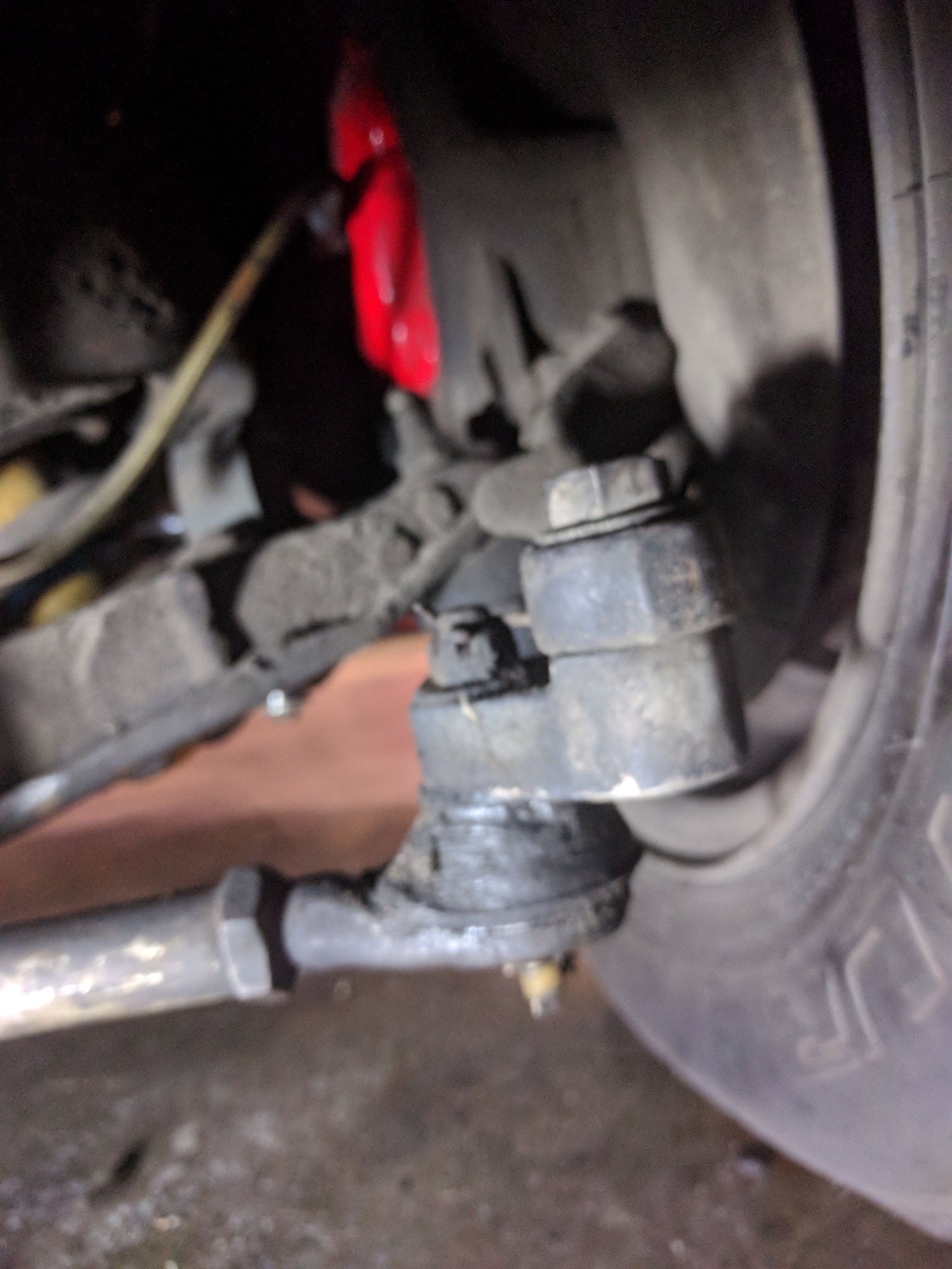

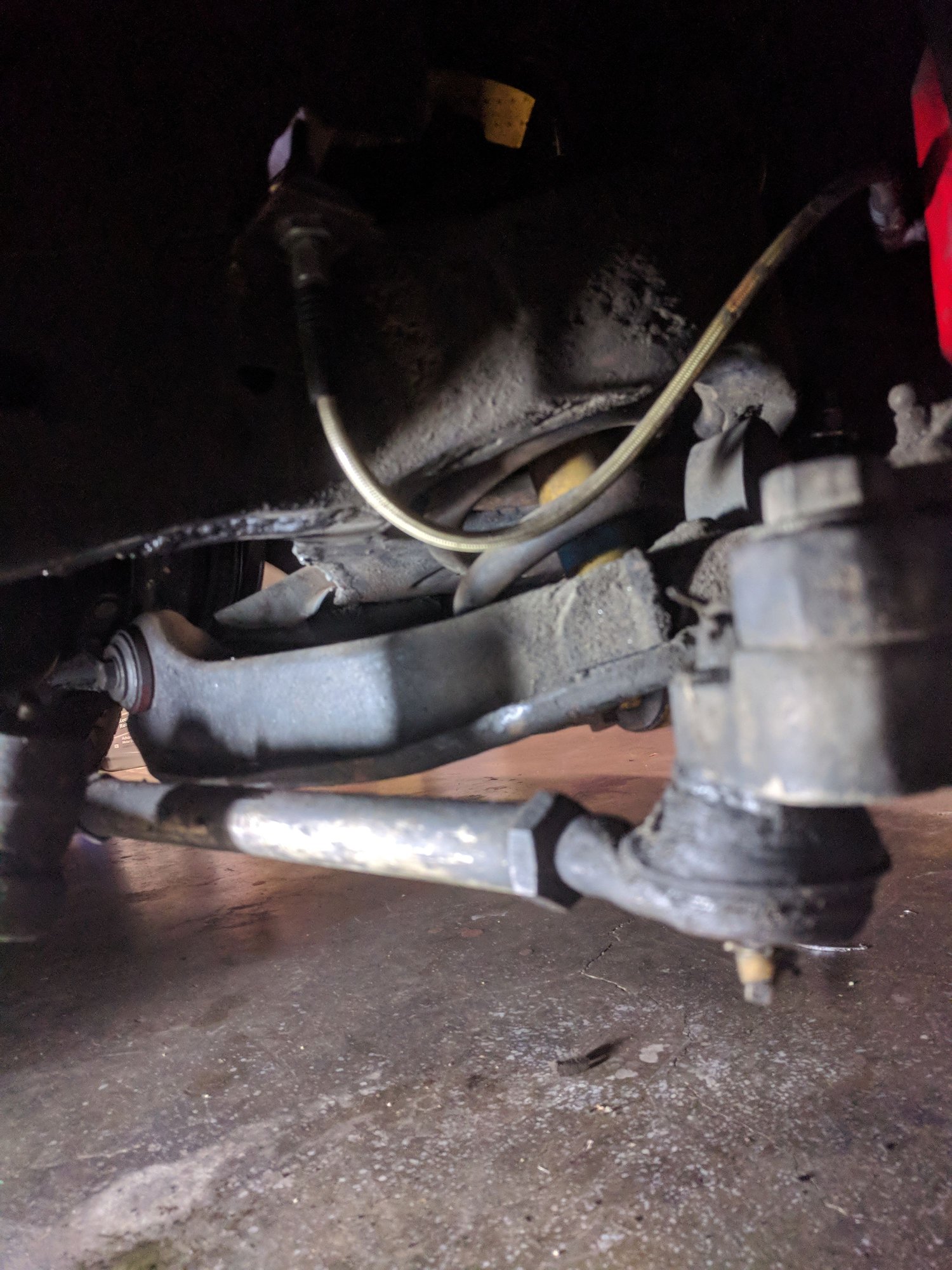

Y'all made me curious. When I bought mine it came with a bunch of little mods. Including this bracket and the adjusters and some bushings (you can see the red bushing in the back ground).
I converted to power steering ages ago but did not reposition anything and kept the bracket as installed.

SO, I kept looking and it looks my bracket thing is an "anti-bumpsteer kit" made by Guldstrand sometime. Car did come with a bunch of Guldstrand paperwork. I guess it's a good thing.

As Martha Stewart would say, "It's a good thing". I got mine from VBP and made measurements to check. Yes they do work but it puts the tie rod end in-between the two holes so you don't get all of the fast steering ratio. However with a Borgeson installed I think you get most or all of it back.
