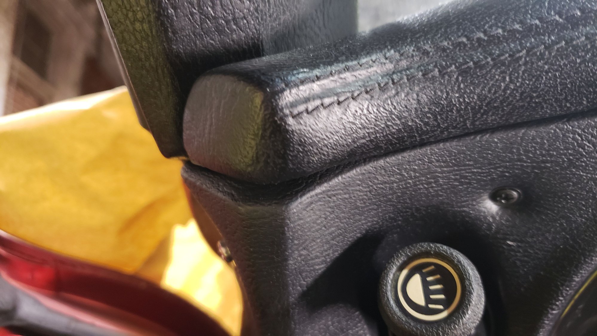

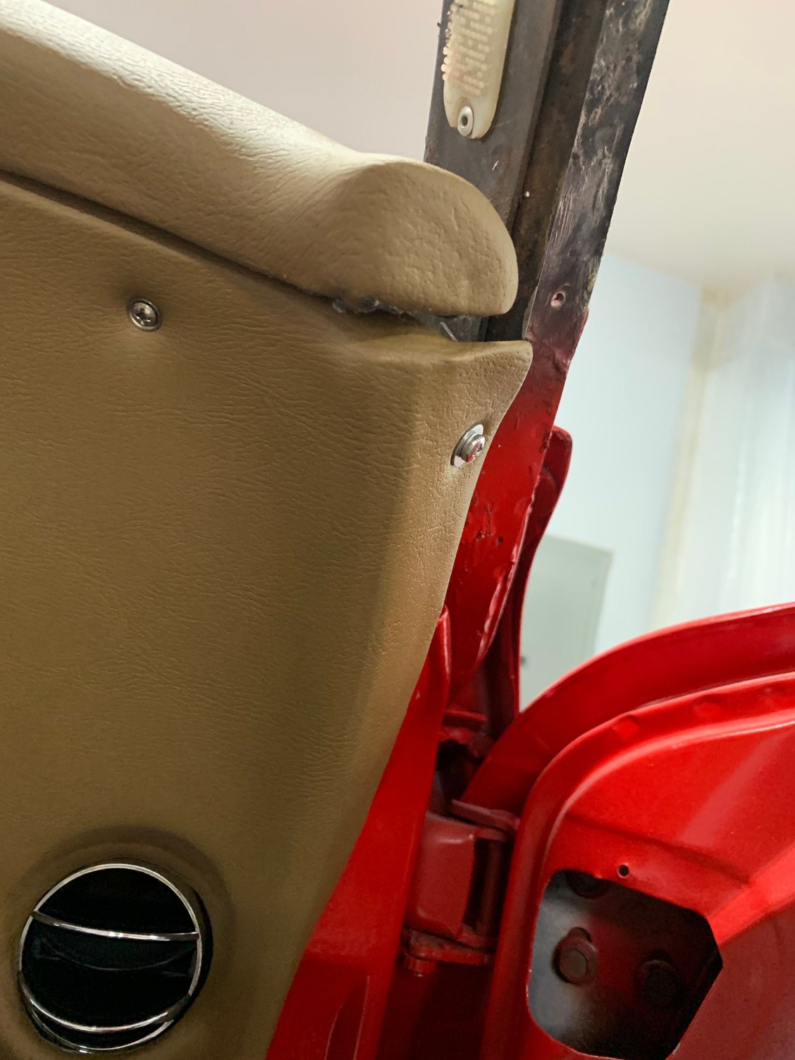

Any if you out there replaced your dash (top and the two lower piece)? I’m curious to see your corner fitment between the top dash corners and the lower pieces at the door jamb.

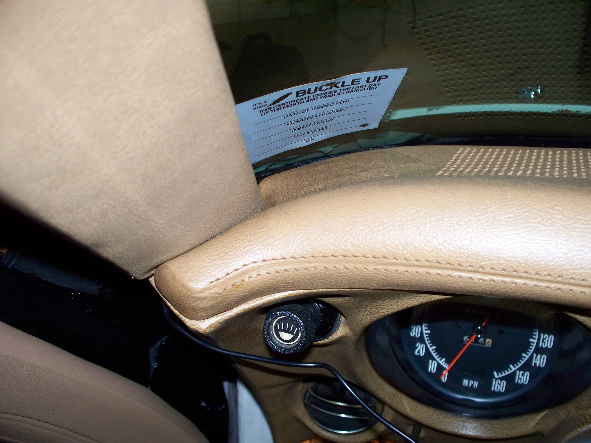

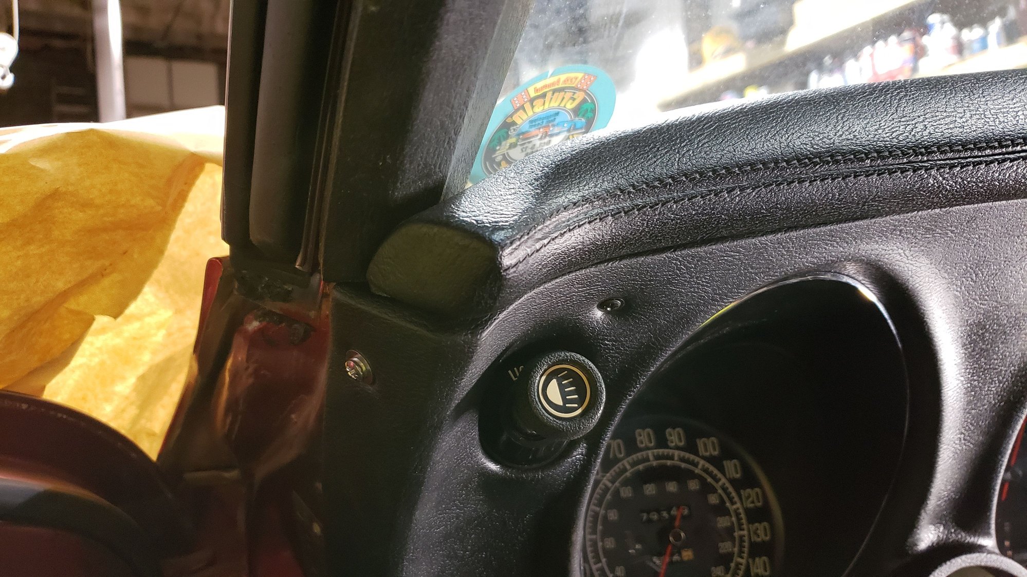

I replaced my top dash and both window trim pieces but kept both lower dash parts.
Fit and finish seems perfect to me.

What does it look like looking at the front door jam? Portion that meets up with the lower dash

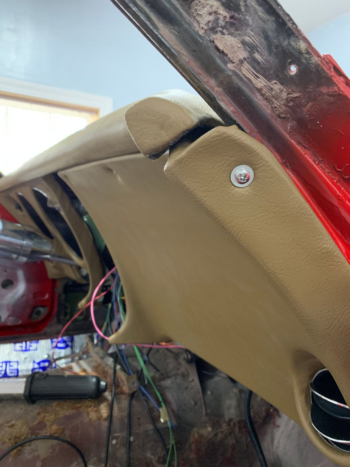

Both sides have horrible gaps... quite agravating... they are from corvette america, which i thought they were the one to get for best fitment....

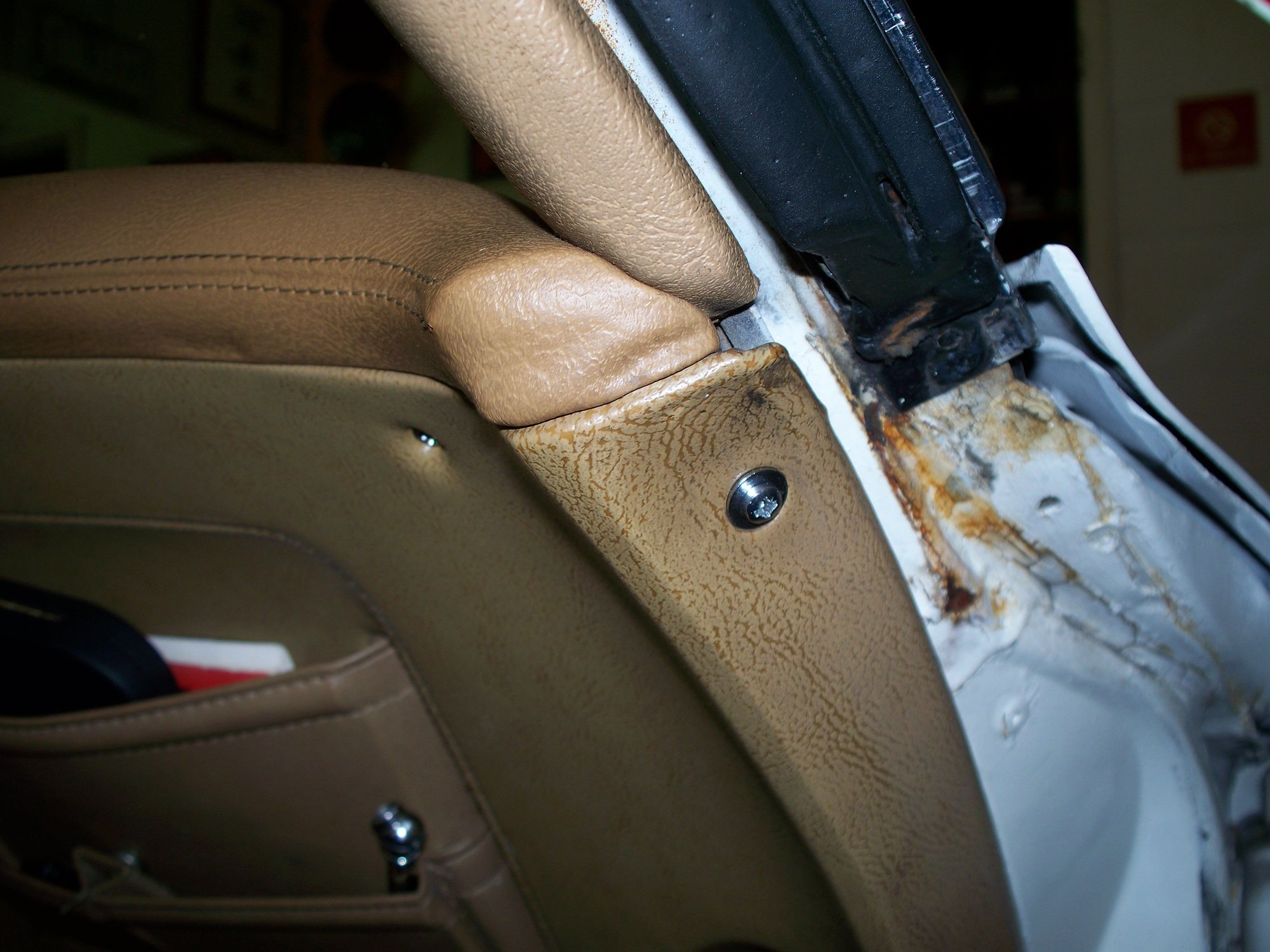

I replaced my lower driver side, and it's fitment is better than the stock one, you should check your screw mounting points on the upper, you should have no trouble pulling the upper dash down to the lower
the upper dash is original
ive been very happy with CA's repro's, the door skins are better than the original as well... mates perfectly and matches to the dash and rear lines

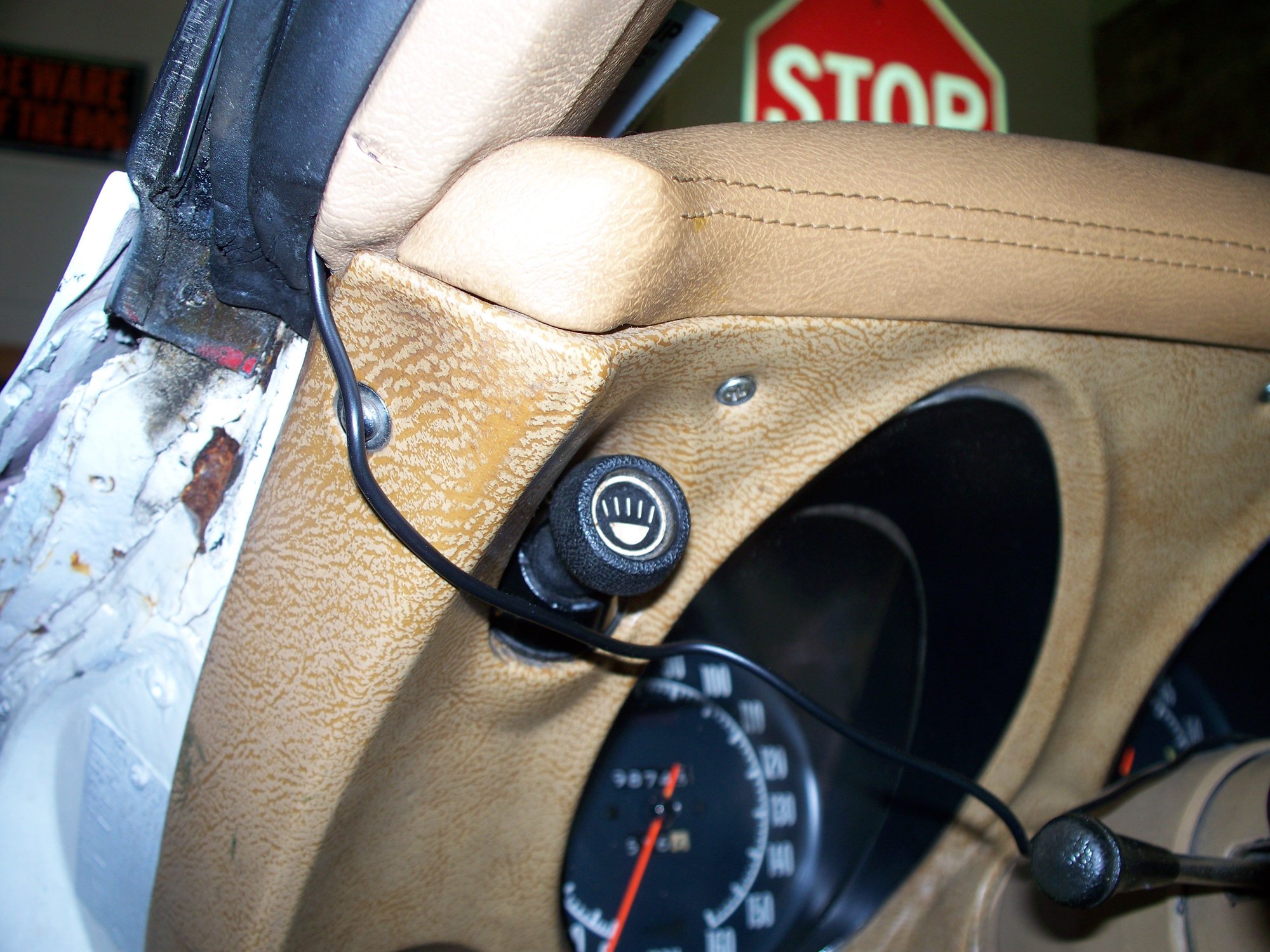

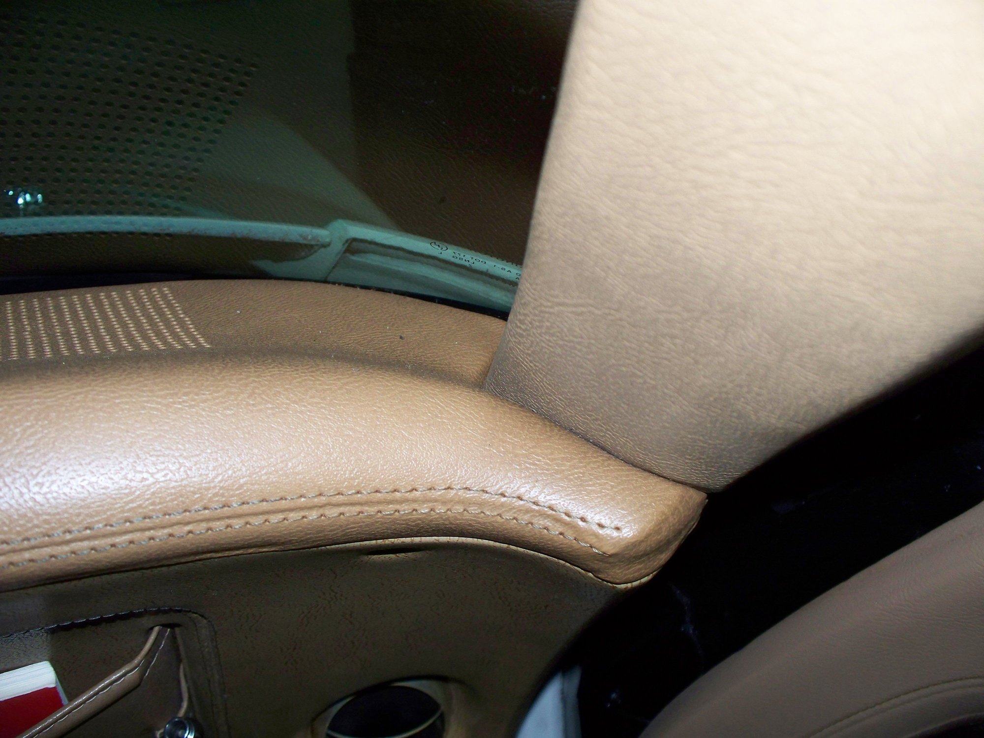

My lower parts came with the car when I bought it so I'll guess that they are original.
The wire is for the mirror-cam.
Any suggestions on what to do in the 'armpit' area?

oh wow that fits nicely... im suspicious of my upper dash creeling slightly from some prior owner putting new speakers in, and didn't get all the clips under the lip... and I think it's turned up ever so slightly on the ends... I guess I could slowly heat them up and bend them down... buut… eh

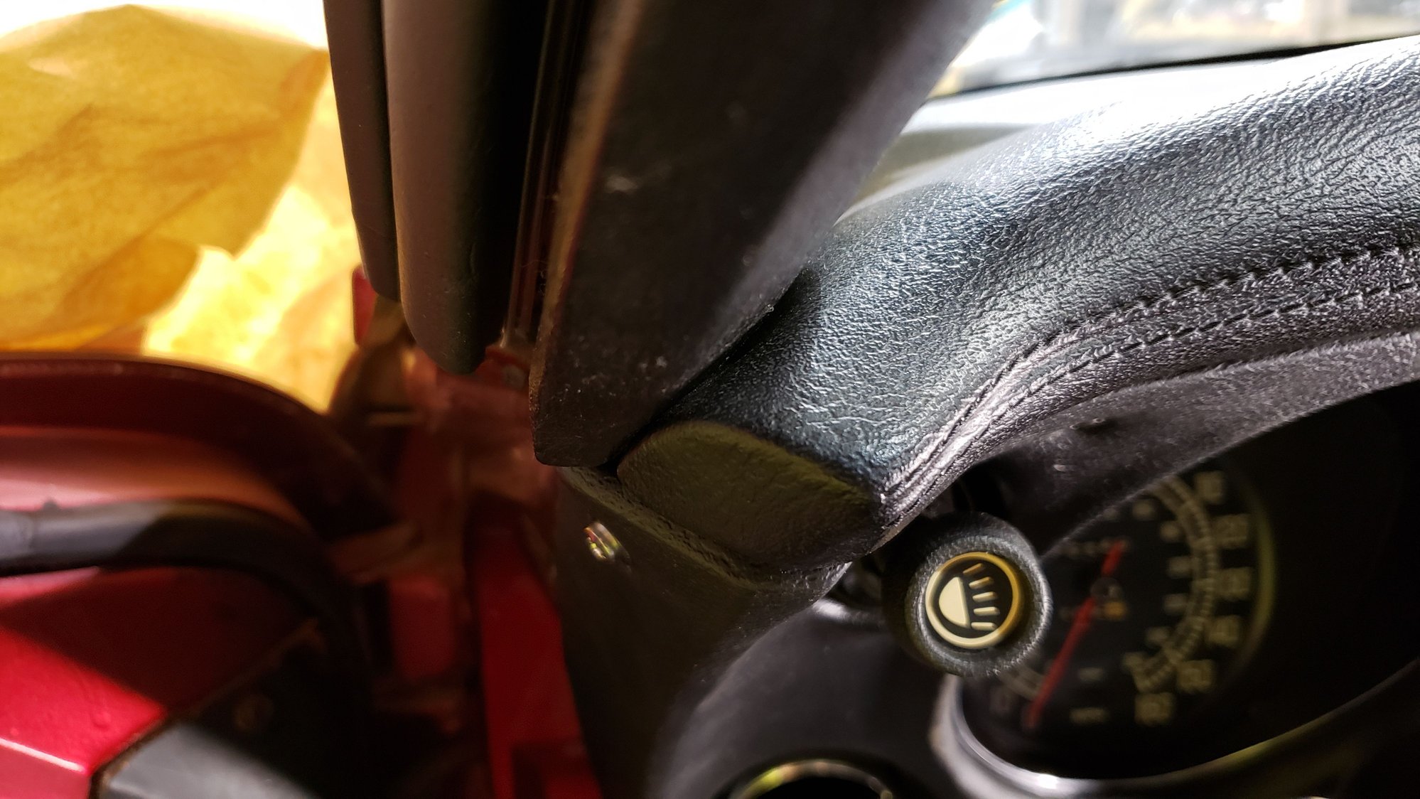

not sure what you mean, all the screws are tight and the rest of the dash lines up good:

I had a lot of trouble lining up the lower until I got the wires out of the way over the top of the gages, was about 1/3 of an inch closer after I got it sorted out, before it looked like yours, I also had to put pressure on the upper left corner of the lower dash to get the upper A pillar screw to line up

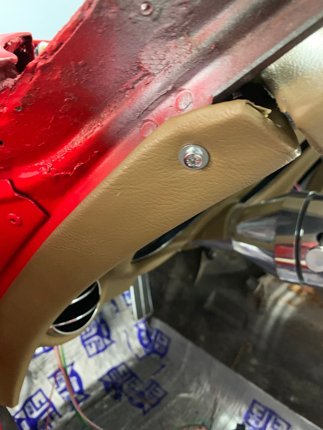

I run after market gauges so I have a catV wire to on gauge and that's it...the rest of the harness goes over by the top of the gauges and that is not factory either...I'll check for interference just in case but the 3 bolts went in fine and both pieces up together nicely....seems that it is the the corner of the upper dash that aren't done correctly...I know they supposetly updated their tooling but maybe not for 68 since it is a one off piece with the ignition switch in there...
I might try a heat gun at the dash corners and see if the A pillar molding adds any pressure down onto it.

I played with it some more this afternoon...driver side is better but pass side is the same as before. Seems like the panel corners are not tall enough to meet with the dash... sent an email to Corvette America Sunday afternoon to my contact there who is taking care of my "sub par" show "quality" bumper but I have not heard back from him today. Not sure what can be done. I put my stock pass side lower panel on and the fit is much tighter... I hope their door panels are better than that or I'm gonna have a conniption...lots of money for all those new parts and I'm not impressed...
