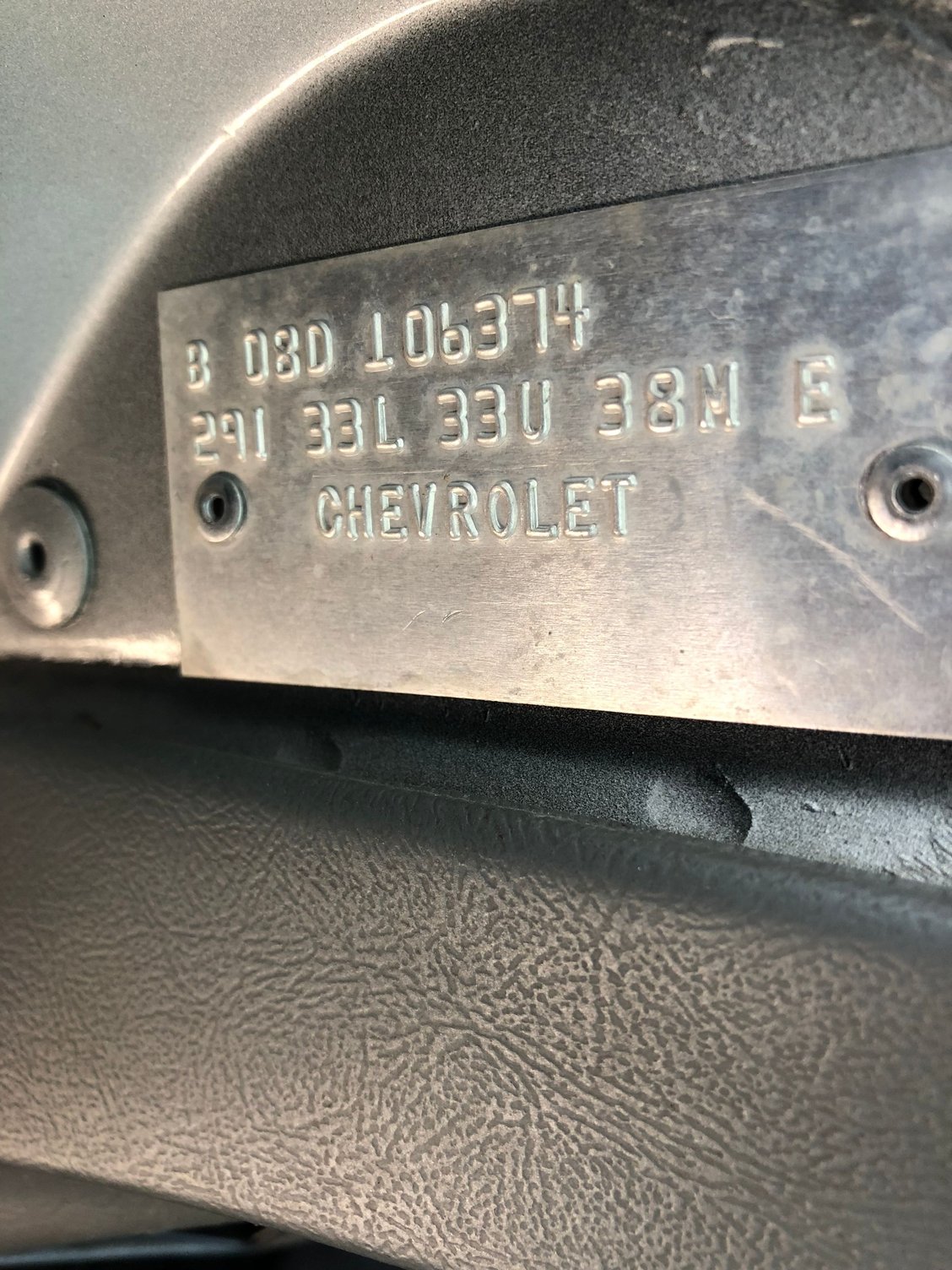

I’m trying to determine the color of my interior so I can buy replacement parts. It looks silver and also looks grey. Can anyone help me with this?

66,
Including the year of your car can save a lot of time.
This looks like a Bowling Green built 1981?
33L 33U = Silver Metallic paint over 38M Dark Blue Metallic paint.
29I = Dark Blue Leather or Vinyl interior. The BG trim tags didn't specify which material was used, only color.

Greg,
sorry about that. I should have put a little more information in.
Well it sure isn’t blue inside. Every single thing inside the car is a silver/grey color. I guess someone went through a lot of trouble changing the interior to a whole new color. I definitely need to replace the seats and door panels, just wasn’t sure what color I had so I’d know what to order

Yes, looks to me like it might have been changed. You could go either way now I suppose.
