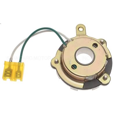

Just an FYI item to check. On old vehicles with an HEI distributor, it's not uncommon for one of the two wires connecting the pickup coil to the ignition module to fatigue/break due to the wires flexing every time the vacuum advance canister rotates the "breaker" plate. Perhaps a resistance/continuity check of the pickup coil while moving the "breaker" plate might be an item to consider checking.

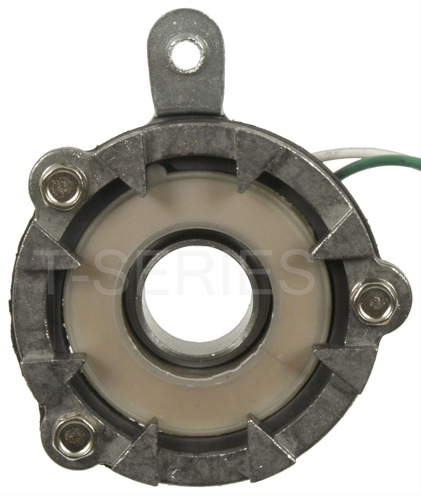

replace distributor pickup assembly ... Standard Ignition pn LX-302 ... or ... LX-302T
