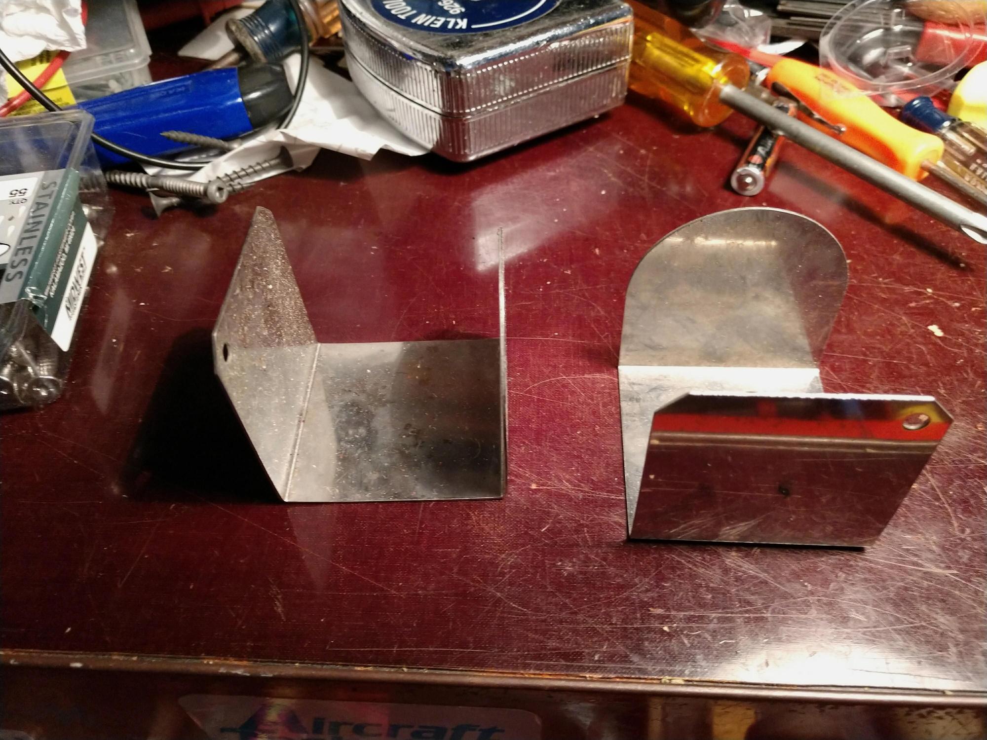

The pistons will pop out as there is a spring behind them. Make or buy the piston clips that hold the pistons in place when changing the pads. The nice part about our brake calipers is the pads can be replaced without removing them.
My piston clips:
