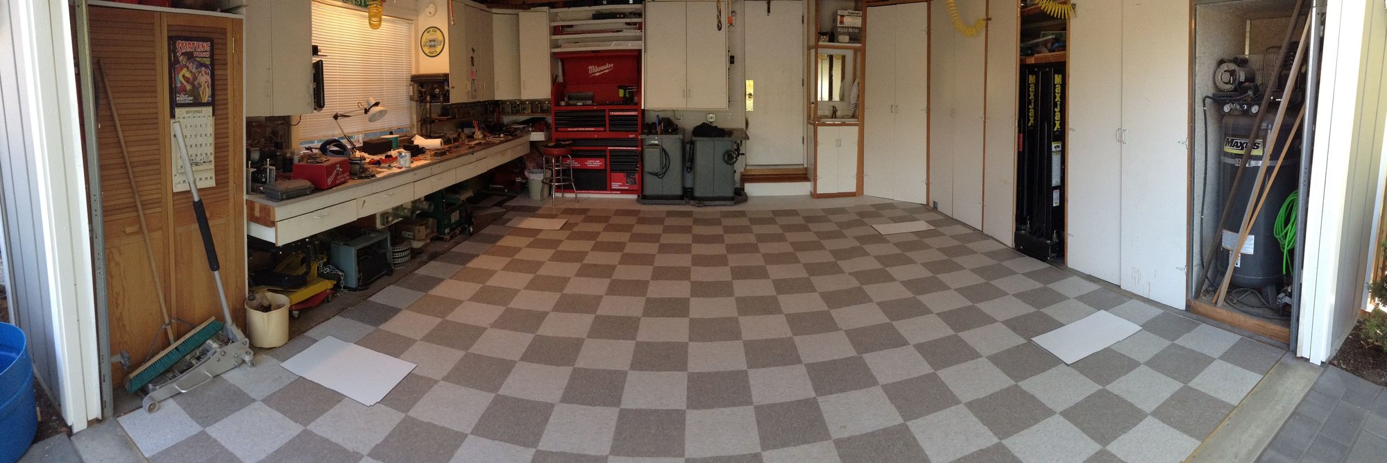

I went with Armstrong Vinyl Composition Tile (VCT) because it was cheap and I could do it myself. Looks good or good enough. Only regret is I didn't wait long enough and some tiles moved around when I parked the cars. The white rectangles are temporary slip pads for the tires I put down after some movement. BTW I spent zero time worrying about what had soaked into my concrete floor over all these years.
