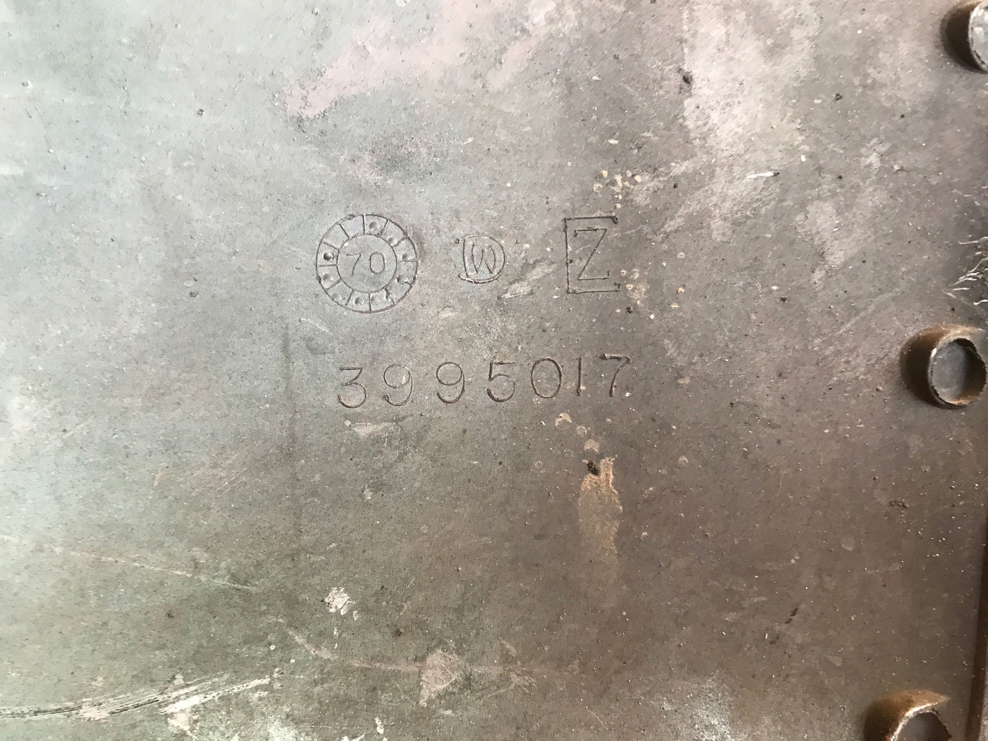

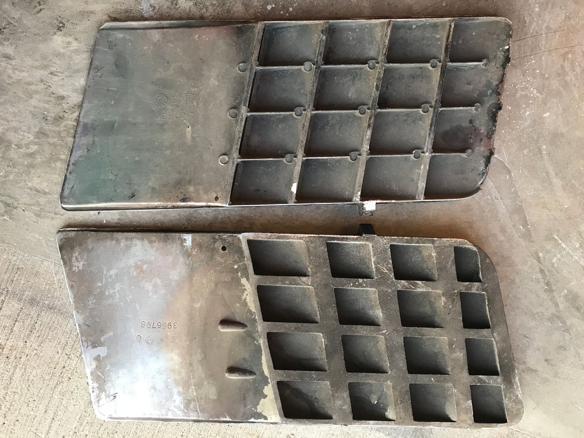

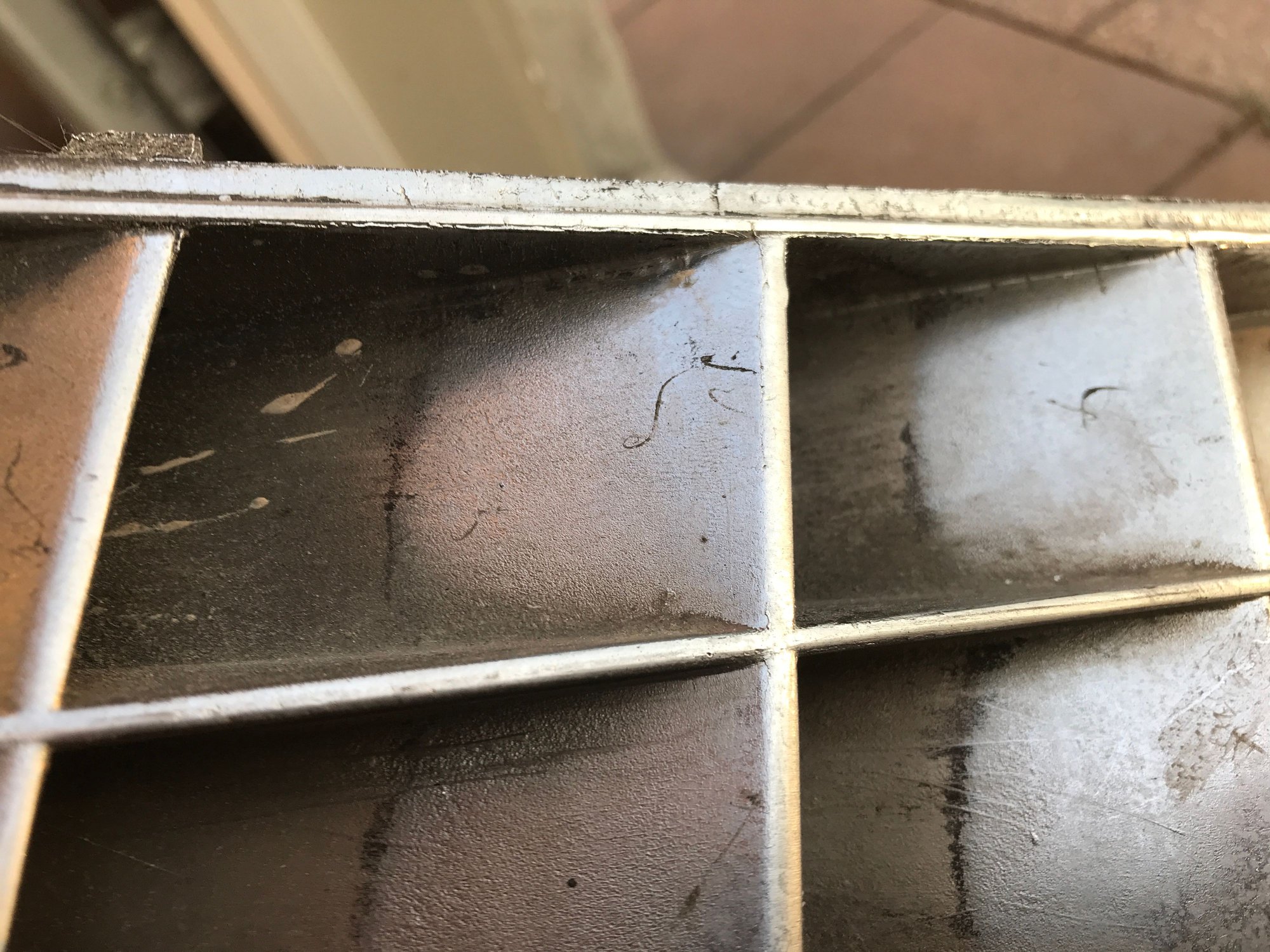

This may be a bit long winded but I think this may answer your question. I have what looks like 1 70 on one side and a 71 on the other side.
This is what I believe is the 1970....
1970 Right
1970
1971 Left side
1971
1970 is the one on the bottom.....
When you compare the two, the 70 looks cheap, with limited detail. If I hadn’t of checked the part number on the 70 I would have thought it was a cheap knock off/reproduction.
3966797 1970 Left Side
3966798 1970 Right Side
3995017 1971 Left Side
3995018 1971 Right Side
I am now in search of a 71 right side

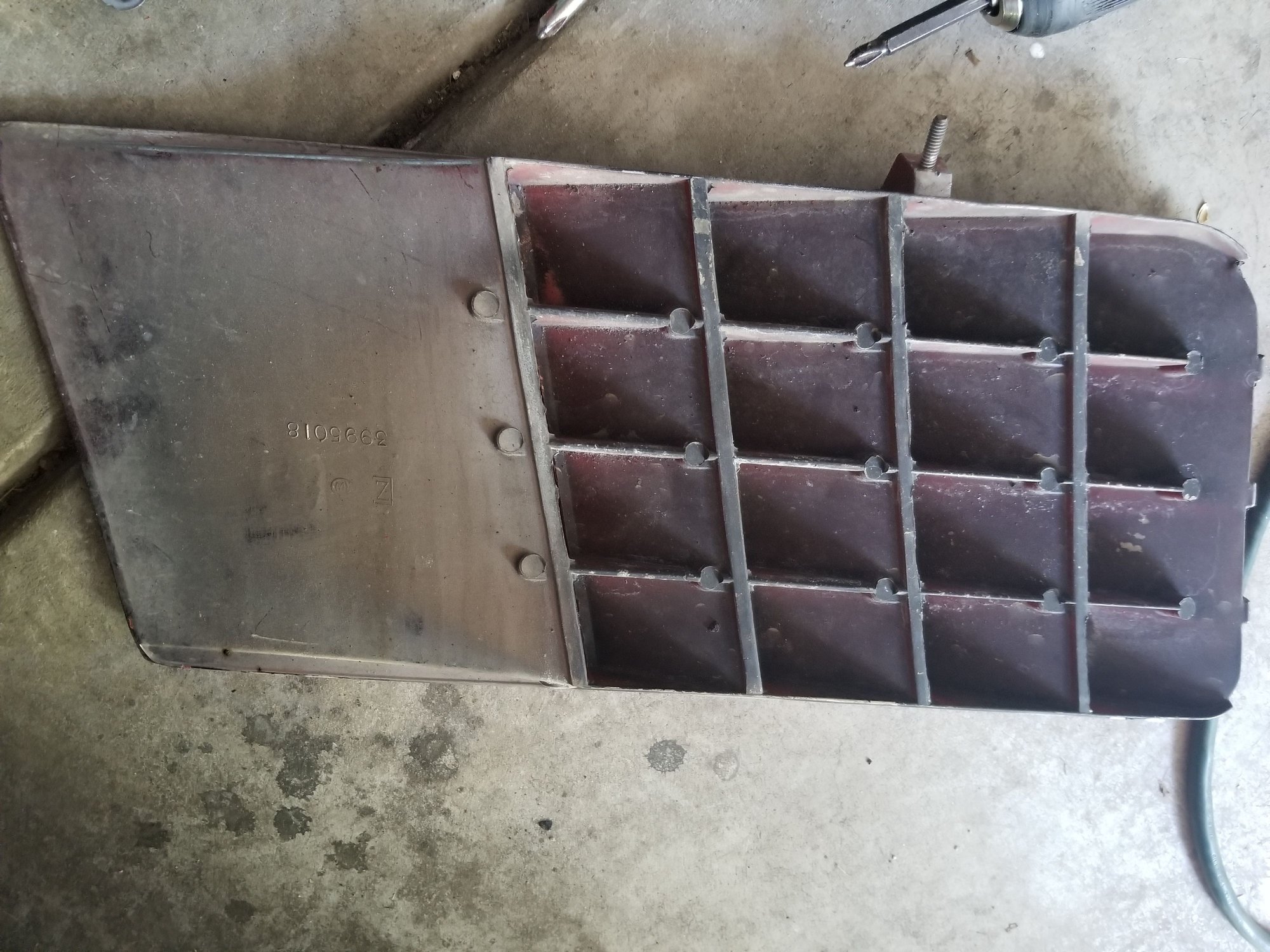

Here is a photo of my louver. June built 1970, original factory paint.

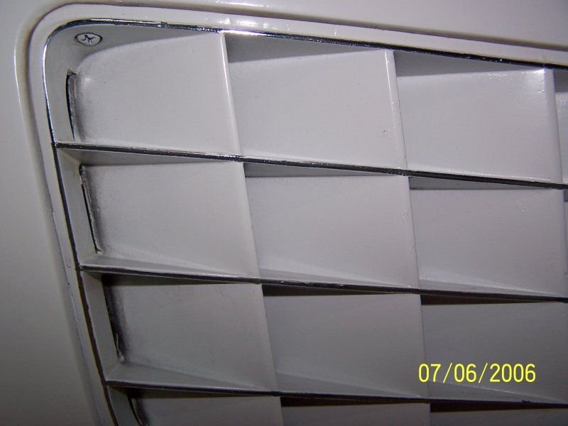

1971 original in primer
and painted
Never seen the design on the back posted above so maybe that was unique to 1970 ?

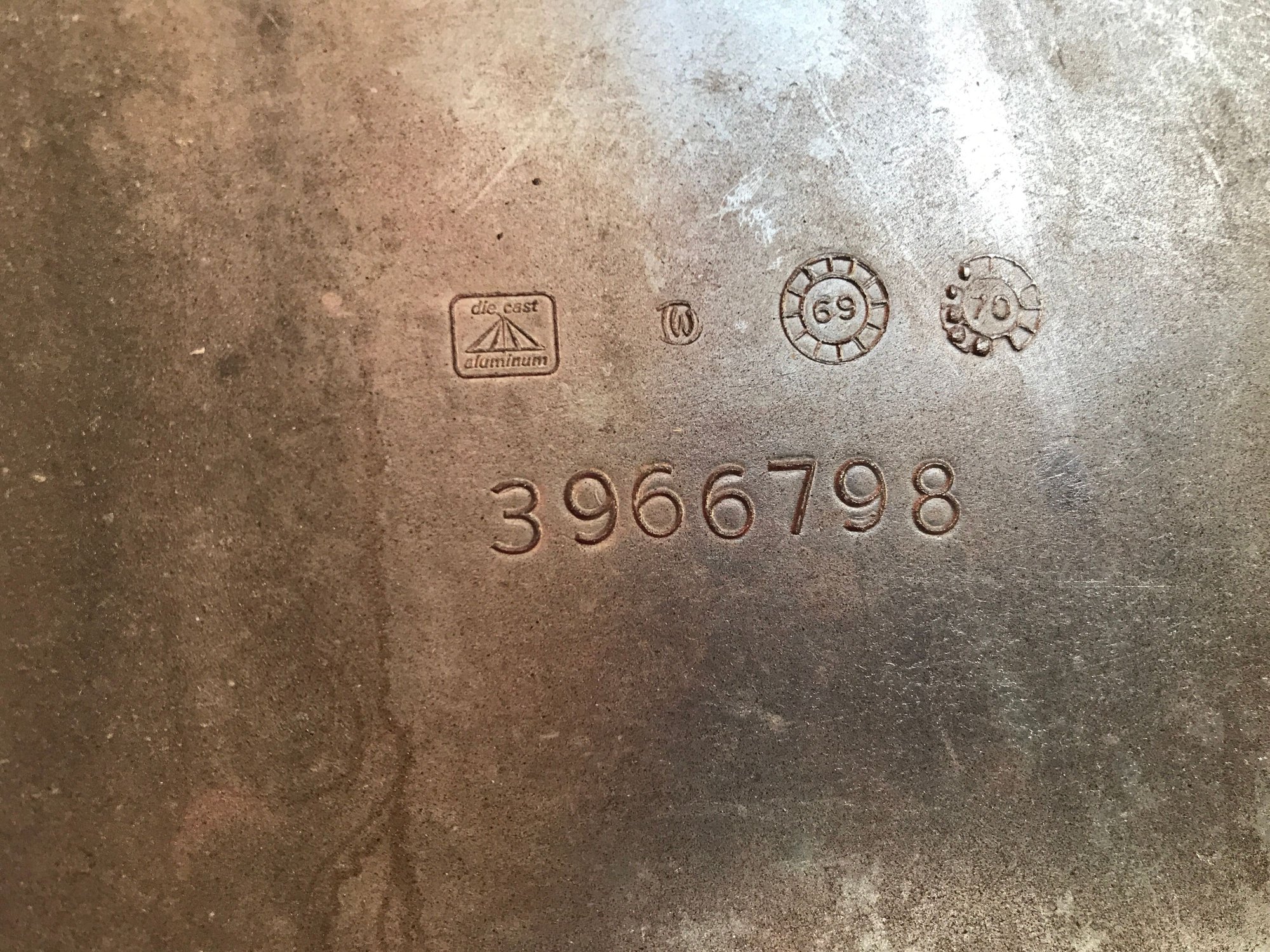

If you take a picture of the casting number and other cast information near the casting number, we can give you an extremely well-educated guess as to whether they are original to your car or not.
Pics like Norm07 posted will work.

Thank you. I confirmed the louvers on my car have part numbers 3995017 and 3995018 so they are the later ones. It sounds like they may be original to the car since my car is a late 1970, but i think i'm still going to try to pick up a pair of nice 1970 ones. Same thing with my front grill actually.

You should keep the parts on your car that came with it from the factory. The date codes on the inside surface of those louvers will verify that they are original.
The only reason that a late '70 car would have had '71-72 design louvers on it would be that the production run of '70 louvers had ceased and ONLY '71-72 parts would have been available for the factory to use. And, I suspect that was the case. So, if you switch over to '71-72 louvers so it will LOOK correct, the irony is that it will definitely NOT be correct, as no '70 car after a specific S/N would have been built with them.
Check your part's date codes. If they were made before your car was built, they are original to the car and should be retained.

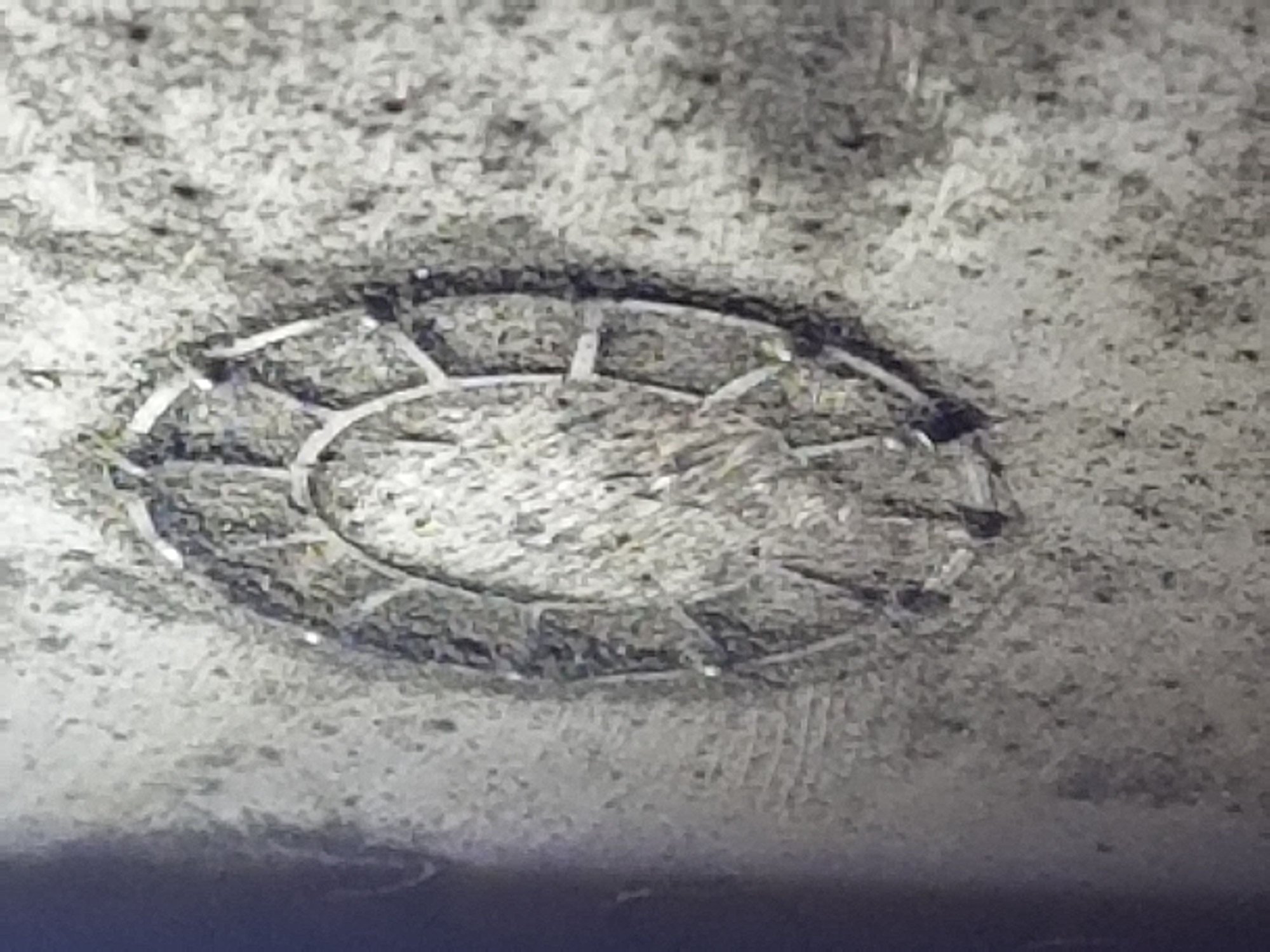

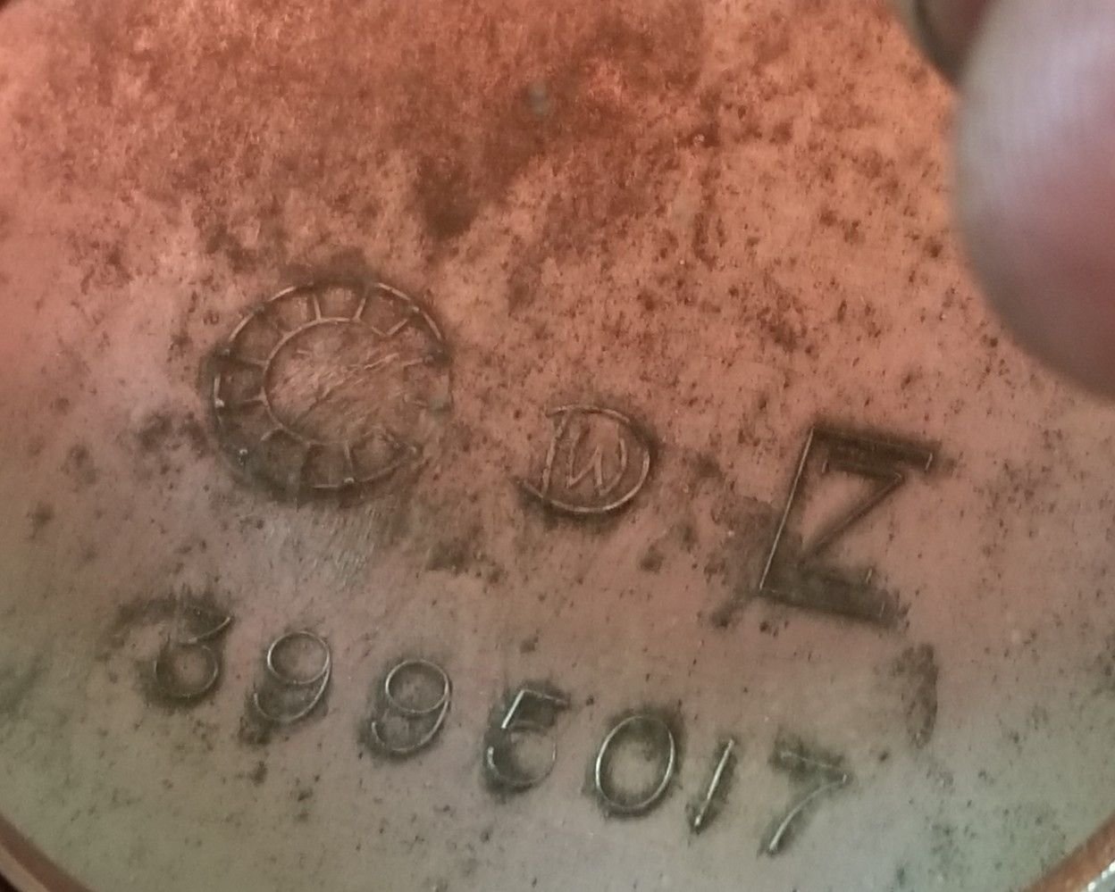

I didn't realize the louvers had date codes on them...i only saw a part number. Here are some pictures...
Old Jul 21, 2019 | 04:26 PM
BarryB72's Avatar
BarryB72
Joined: Nov 2013
Posts: 1,806
Likes: 258
From: Dublin Ohio
Does the 5018 have the circle with the year in the center?
Does the 5017 say 72 in the middle?

Here's a close up of the 517...it so hard to tell, it almost looks like someone scratched off the date.
5018 the whole freaking circle is scratched out. i'm going to go out on a limb and say they've been replaced

They definitely removed the entire date code...but why?
