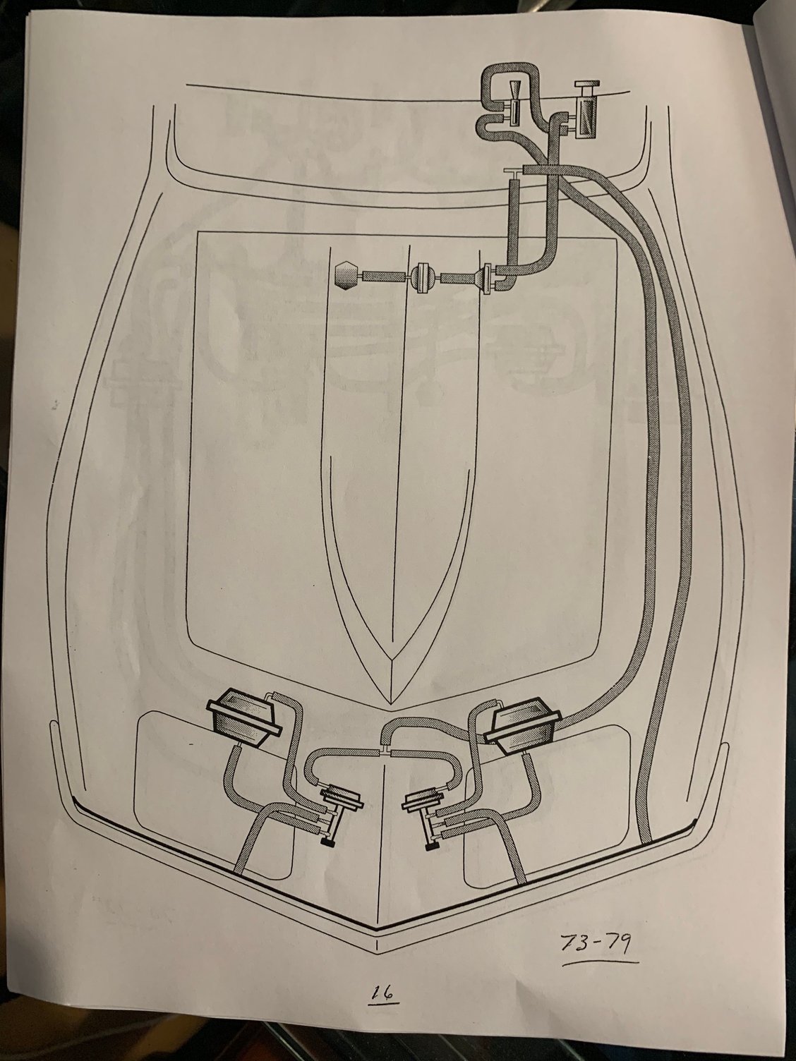

Wilcox and Ecklers has lots of great information and detailed diagrams for all C3 vacuum systems... they helped me fix my whipper door that wouldn’t go down...👍🏻

Likes: 161
Thanks! I’ve used all of those resources too and I have to say, if they hadn’t been available I would have been really intimidated by the project. With the write up in the FAQ sticky in C3 Tech/Performance, the Corvette101 write up and the Willcox site it has been a fun project! Oh, and the MightyVac paid for itself on this. Anyone who works on C3s should invest in one. Well worth the money!
