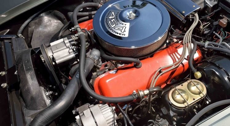

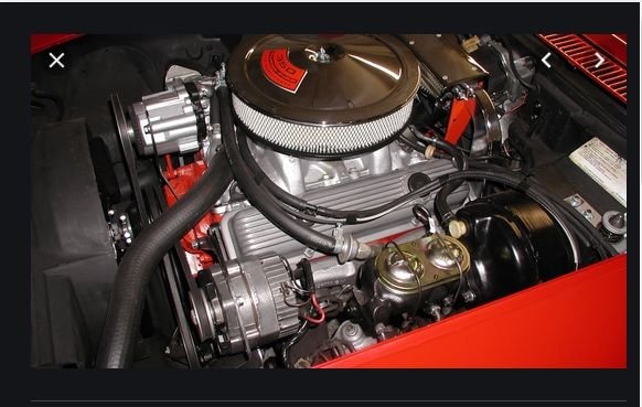

If you have a 1971 LT1 or an LS6, then yes, it came with a smog pump.
If you don't, then yours didn't come with a smog pump.
LT1
LS6
