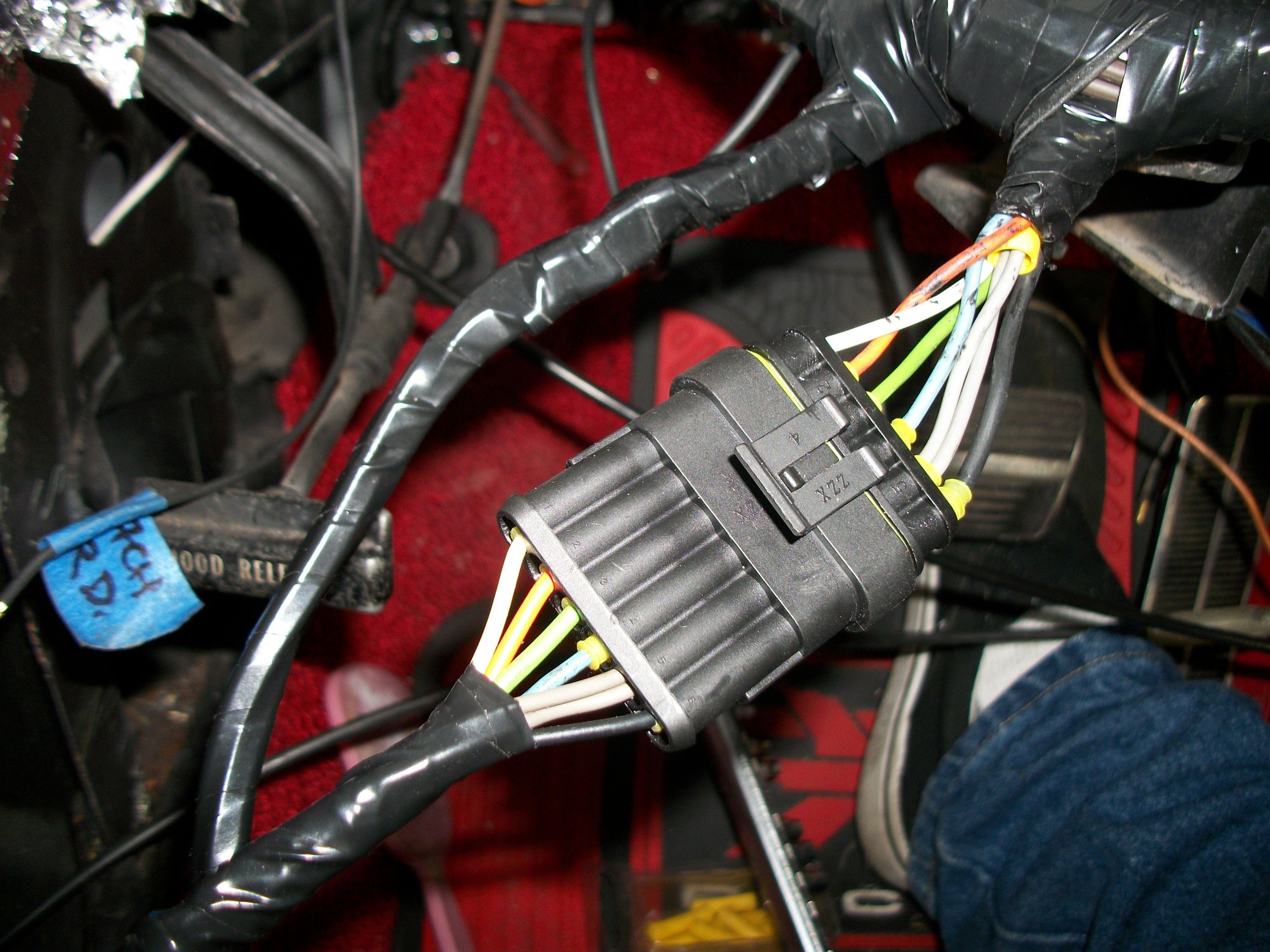

I'm not concerned about NCRS and plan on keeping my basket-case so I added 12" to each wire and joined them with molex plugs. Now I can pull out any section of the dash as work/replace gauges/bulbs with no hassle of reinstalling the dash sections.
extra length was added to left side of quick disconnect plug.
