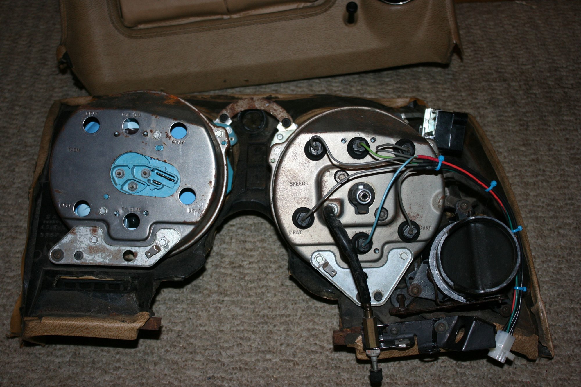

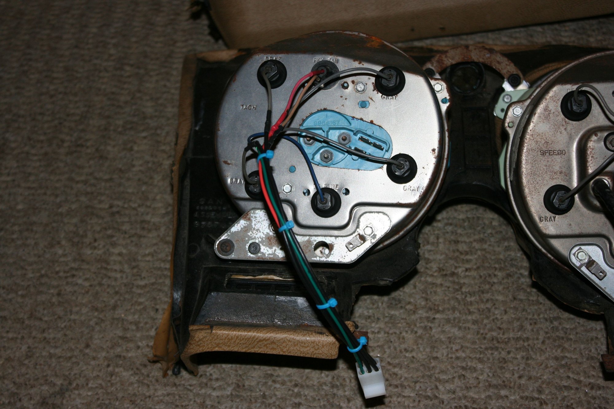

I split the wiring harness at the speedo and tach and put them on molex plugs.

I like how you split the wiring behind the speedo and tach. Looks like it will fit much better than the OEM harness and trying to crush it in there when reinstalling. I might have to try that on mine.
I have small small hands and it was still a pain trying to hook up all the lights and get them in the right place. This way you can install the dash and hook it up later. Molex plugs are inexpensive and I used to get them at Radio Shack but there are other places. I solder all connections and I only use them on inside projects as they aren't weatherproof.

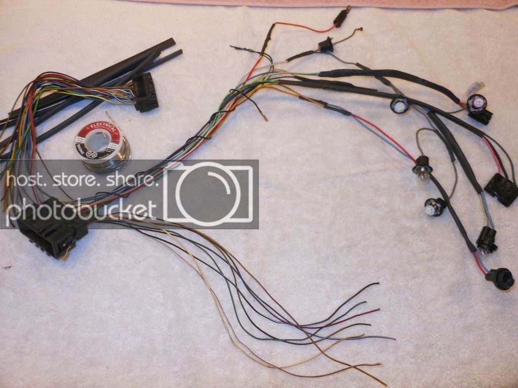

The molex plug has been mentioned- I like to go to the junkyard and get some really good ones for a few bucks- my choice is the 90's BMW before CAN BUS- the connectors are top quality
BEFORE you redo the wiring- take a serious look at this piece- prints on heat shrink tubing- BEST way to identify the wires!!!

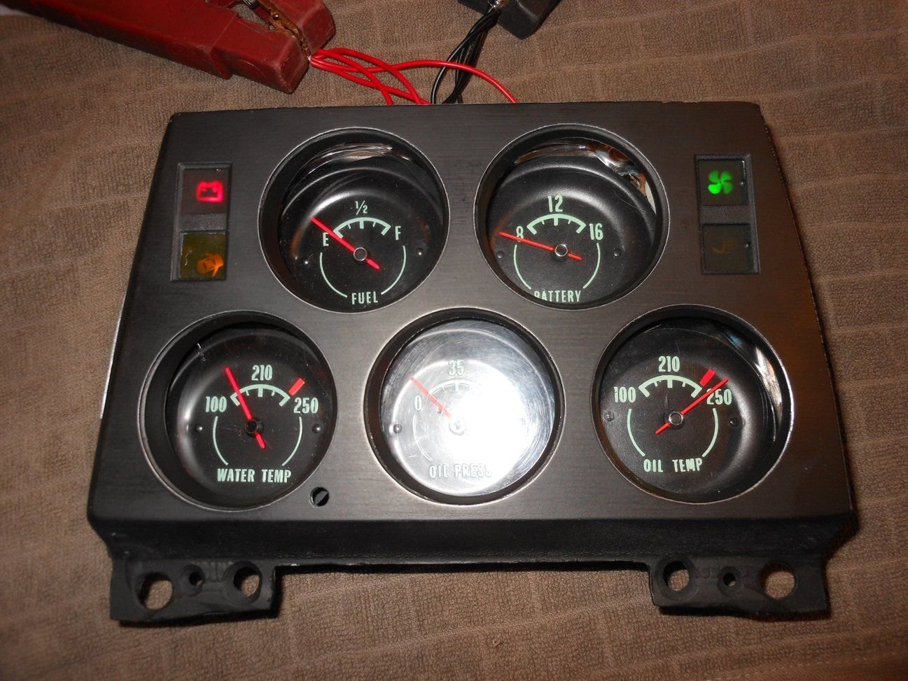

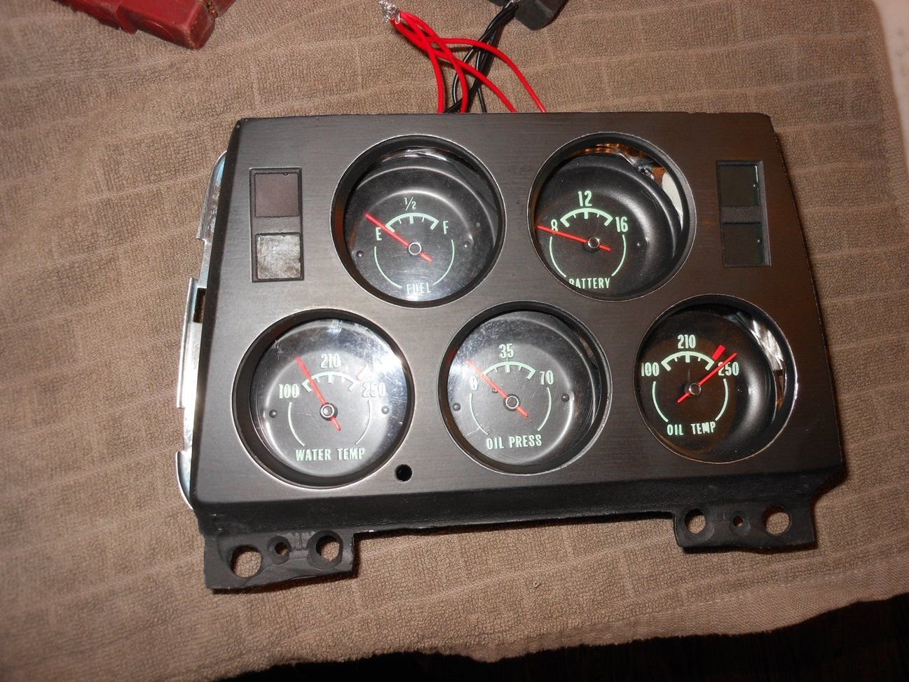

I added an oil temp gauge and changed to a voltmeter which I highly recommend if you change /upgrade under the hood.
Also got rid of the fasten seat belt light
Here's the final idiot lights I ended up with-
alt/charge light-Door open- Fan ( lights when on and use the hole for the clock as a switch to over ride it)- headlights not open- even though I did an electric headlight conversion- this still functions.

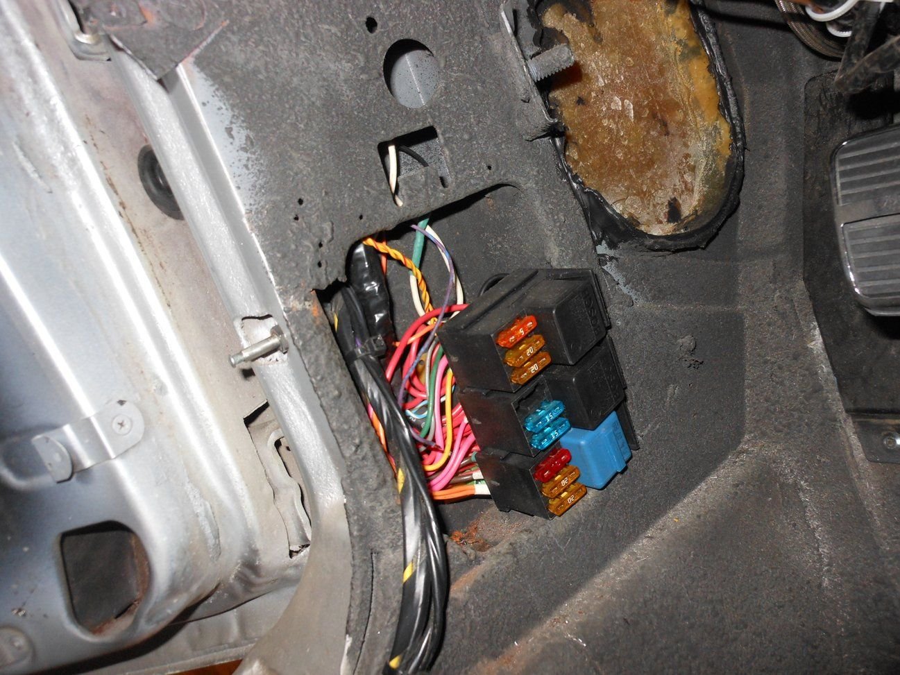

Oh- I made my own new "fusebox"- and relocated it - big help !!!
