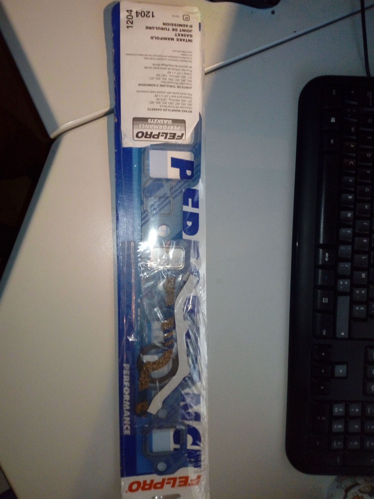

Do you mean the same RTV 22071 on ALL the ports (4 coolant passages AND the 8 intake ports).
Here is a picture of the products I got:
