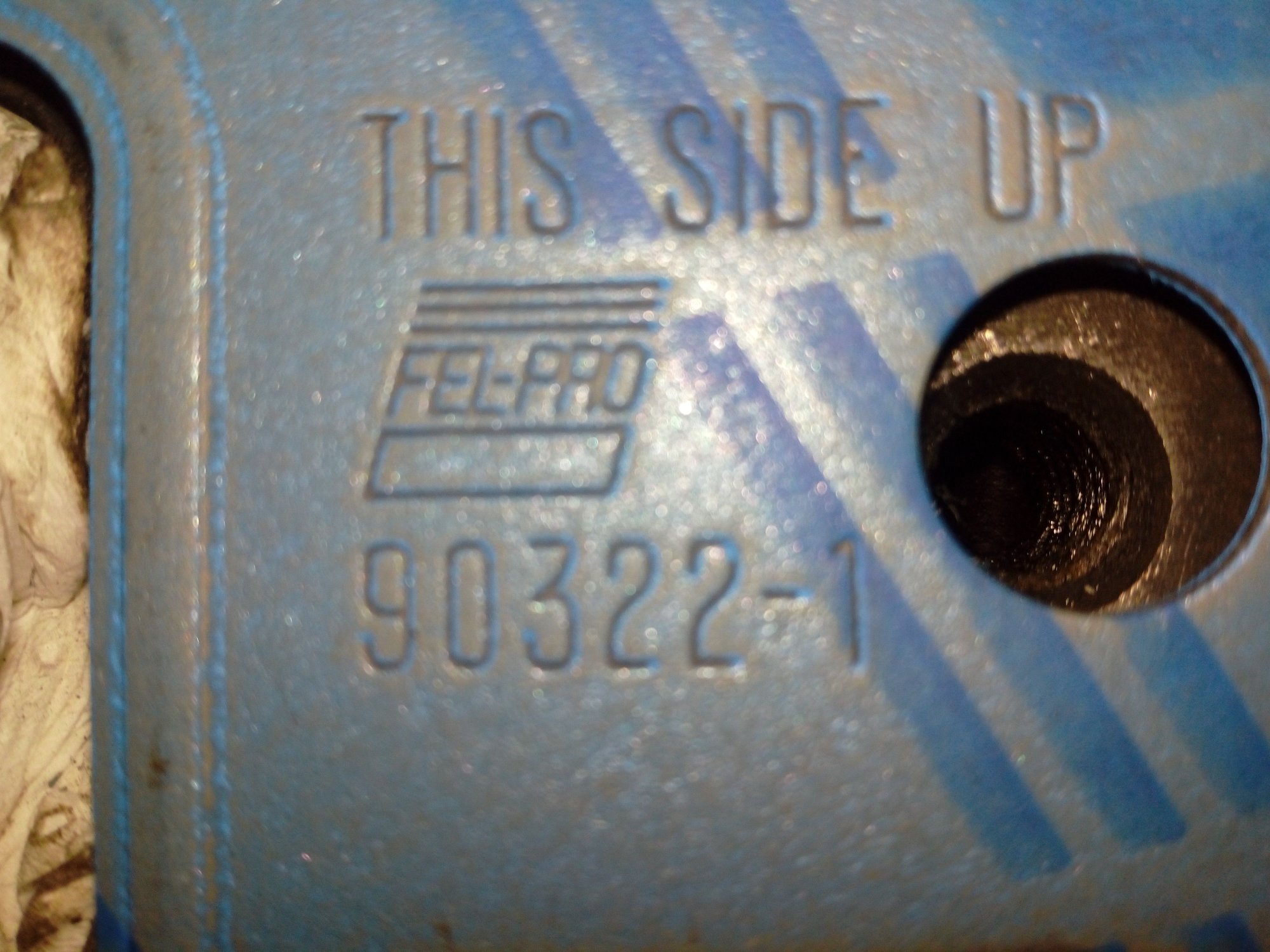

The gasket itself doesn't say '1204', but 90322-1...
Maybe it's Permatorque? Felpro says not to use any sealant on Permatorque...???
Here are some pics of the product number and the fitment (not installed yet).

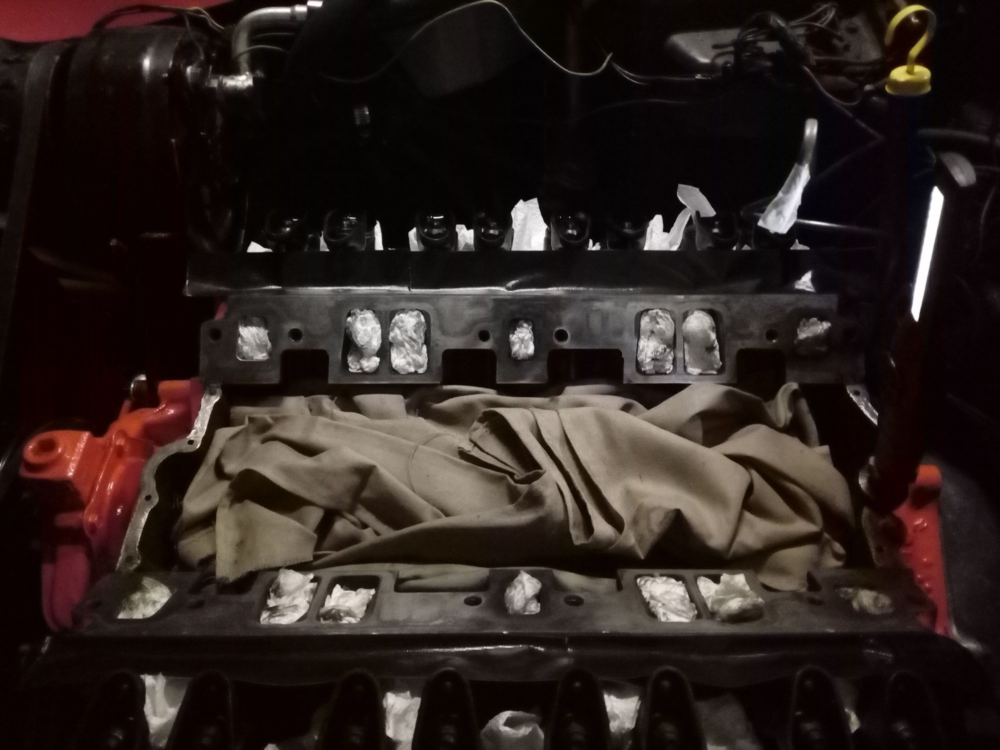

I use the 3M Rolex bristle discs....lay a towel in the valley pan and wad small rags for each port.....
The 3M discs are the best damn thing ever invented.
They were designed by 3M for Chrysler during the 100% failure rate Dodge Neon 2.0l head gasket dilemma in 1999/2000.
They will not remove material if you pick the correct color for the job....I like green for cast iron....white for aluminum.....they are a must for any garage mechanic.
When finished, remove the rags from the ports first and then the towel....carefully.....if you get anything in the valley....shop vac it out then blow with some compressed air.....
Good to go.....
