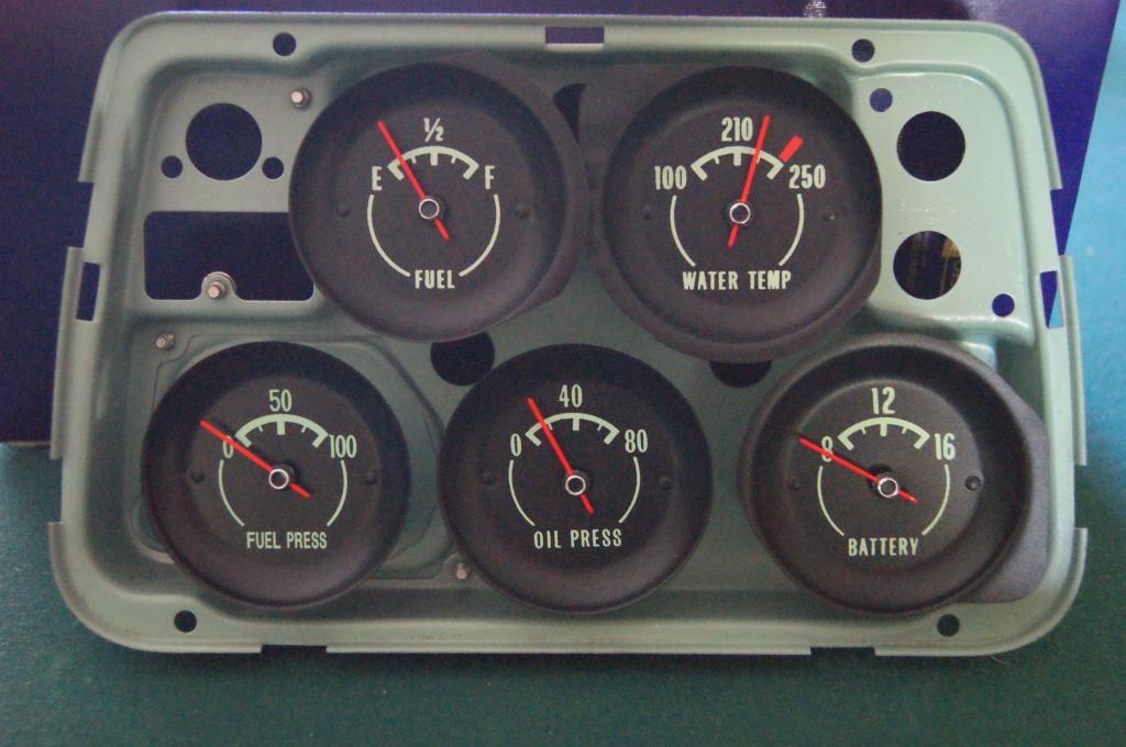

Here's what a buddy of mine did to his 70 LS conversion...much better than a clock!!!
Old Sep 2, 2019 | 08:36 PM
Buttersvette's Avatar
Buttersvette
Joined: Jul 2017
Posts: 399
Likes: 115
From: chico ca
I will never pull that dash and components out again on my 68, but just curious where did he get a fuel pressure gauge from?
