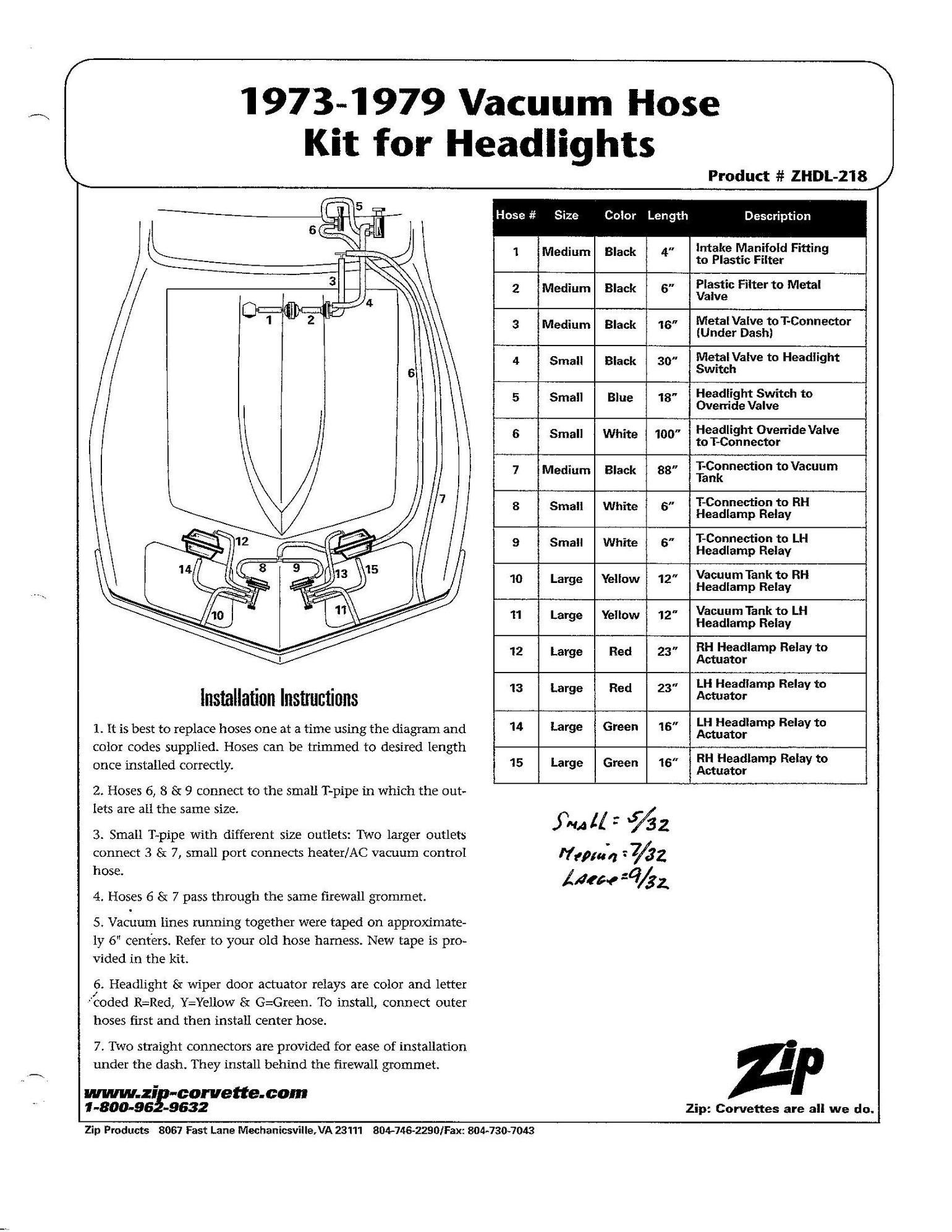

Default Does this help?
Be very careful removing the heater hoses from the heater core, if the tubes move they can break.
Vacuum hose sizes:
Vacuum hose sizes:
Am I reading this well:
Small = 5/32
Medium = 7/32
Large = 9/32
I'm not sure of the handwrighting...?
Small = 5/32
Medium = 7/32
Large = 9/32
I'm not sure of the handwriting...?
That is the size of the hose in 'inches' you might have to convert to 'metric'.
