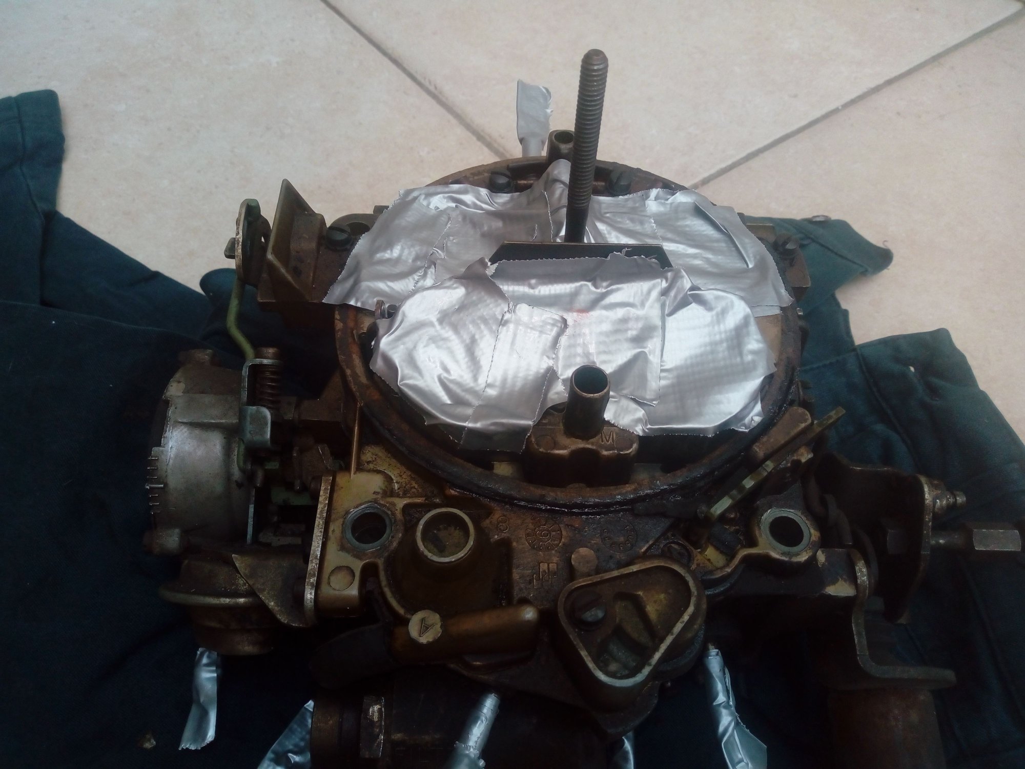

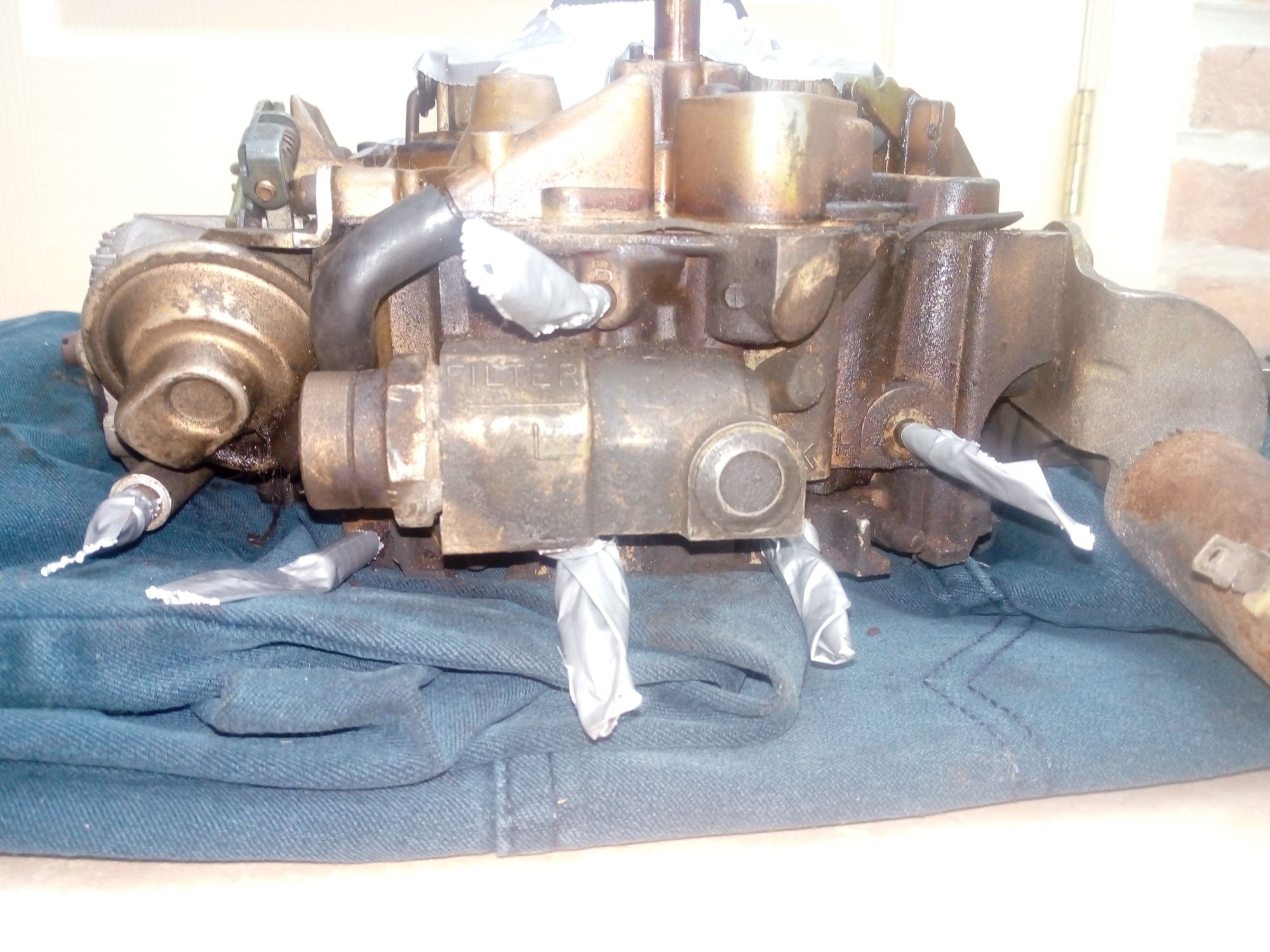

I'm going to clean the outside of my qjet from my 77 before I install it back on the intake.
I have taped off the top of the carb and all the little vacuum pipes (+fuel inlet).
Am I OK to proceed or are there other things to take car off, or to bare in mind?
Do I have all the lines taped off? (don't remember how many lines there were)

I think you should be fine.
Use the spray and an old tooth brush and get into all the spots.
If your really adventurous you could pull it completely apart clean inside and out - but if its running fine probably can wait for another time.
Cant tell from the pictures but you may want to tape over any breather tube coming upwards on the top.
Not sure about later quads but early ones have open breathers

Looks good to me. I think I would spray the top and bottom also. Hold the carb up and spray from beneath so that it drips out instead of dripping inside.
The can says leaves no residue, but other brands of carb cleaners that I've used will leave a oily film. A can of brake cleaner will take care of that.

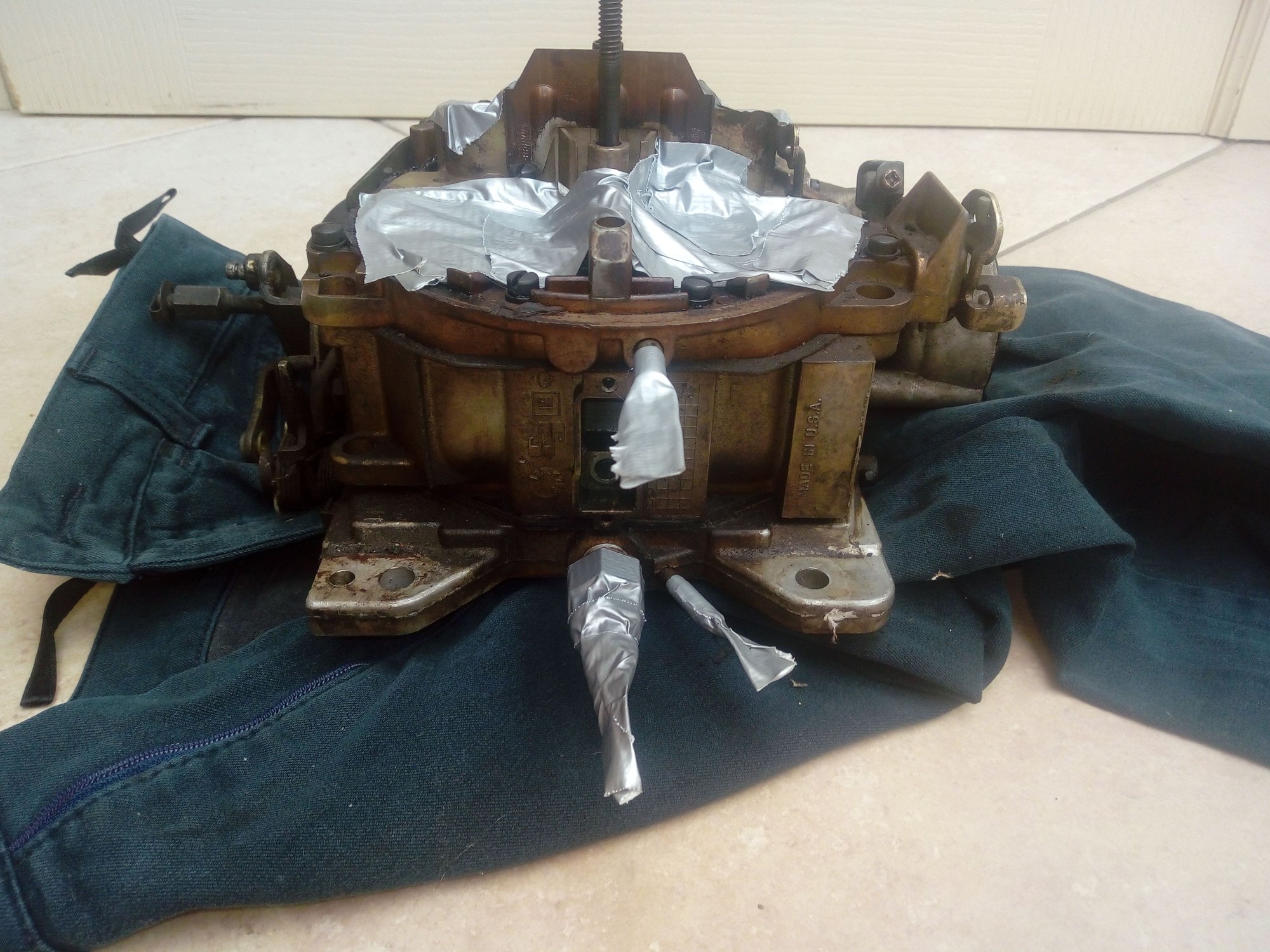

Are these the breathers?
Old Sep 22, 2019 | 10:42 PM
CraigH's Avatar
CraigH
Joined: Apr 2010
Posts: 2,794
Likes: 1,195
From: Canberra Australia
Looks like it. Worth covering them up as well if they are open to the inside of the carb before you start spraying cleaner around.
