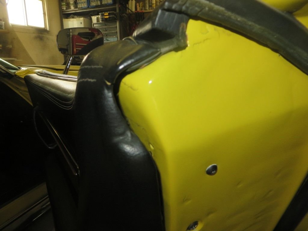

I didn't put any of the other screws in my panels and there is nothing I recall that needs to go through the panel to hold the weather strip

No, the screw in the top is under the door panel not through it. Glue is used along the bottom and f/r edges to hols it in place

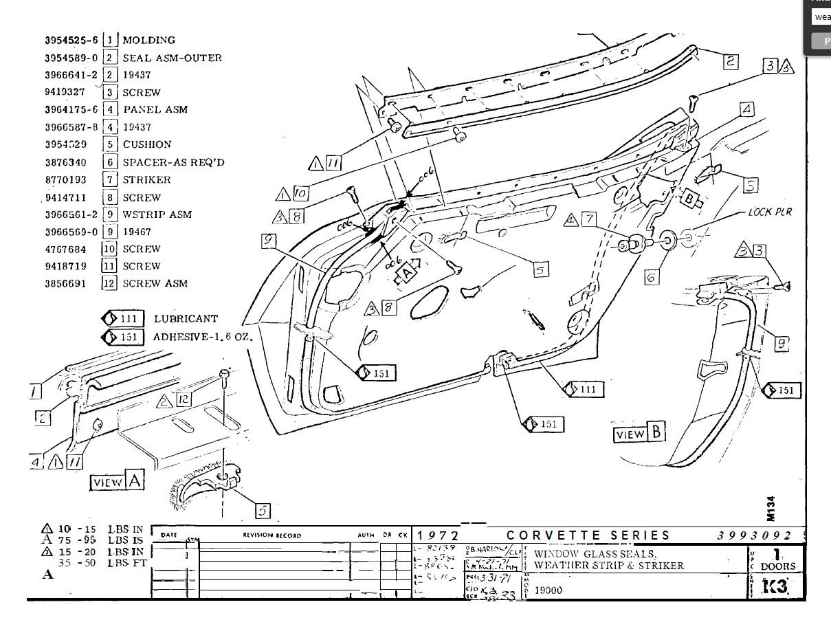

awsome pics! that tells it all- thank you! so adheasive goes on door front/rear/bottom.. so solid string of it all way around (on door).. do I also do same on the rubber or just the door? Thanks a million!

I used a small bead on the door sort of on the flat of where the flat meets the corner, doesn't take much, and hold the weatherstrip in place with a bit of tape until it dries. Make sure everything it clean (alcohol) and dry, test fit to see how it sits since it's really a one shot item
