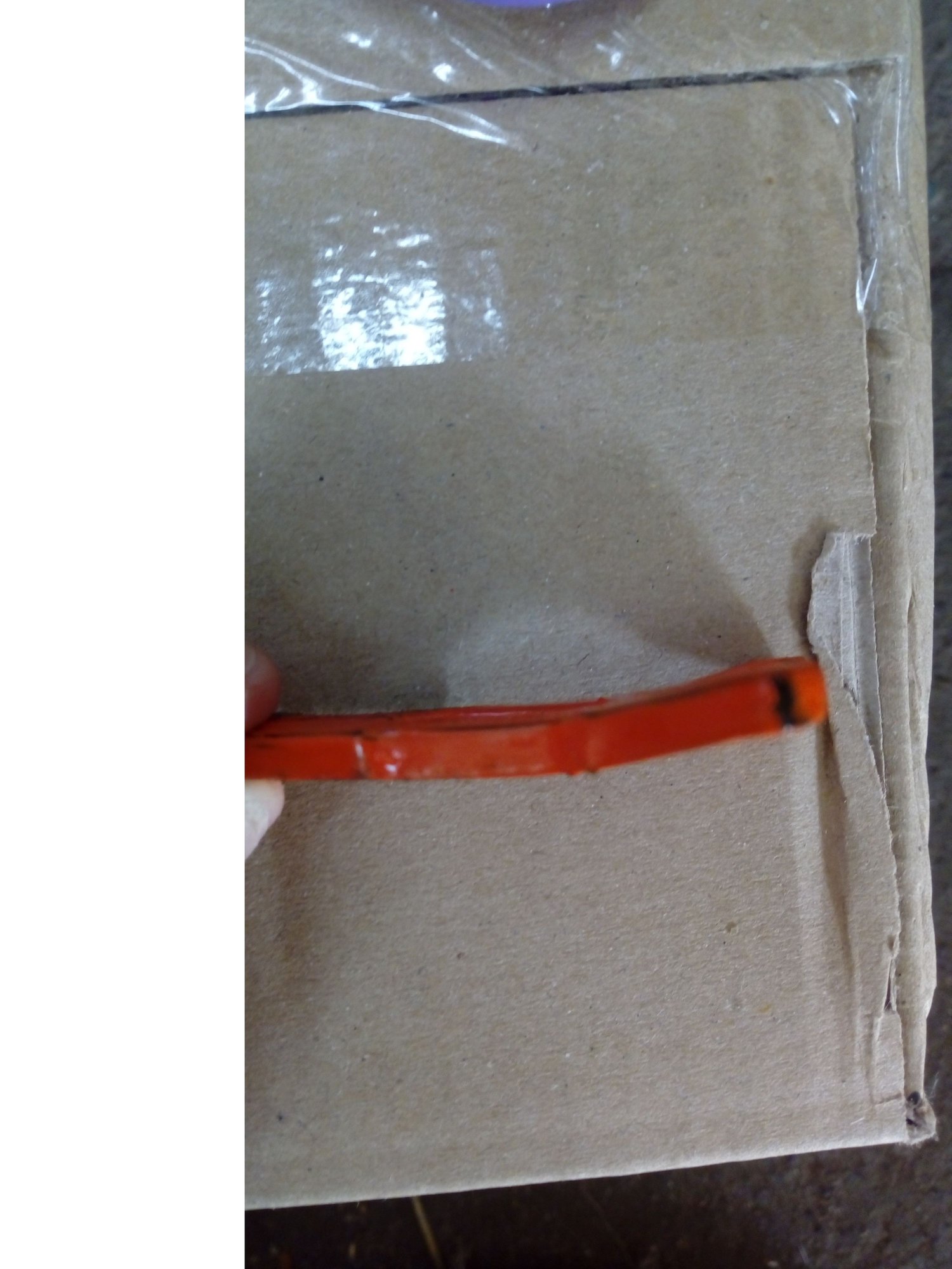

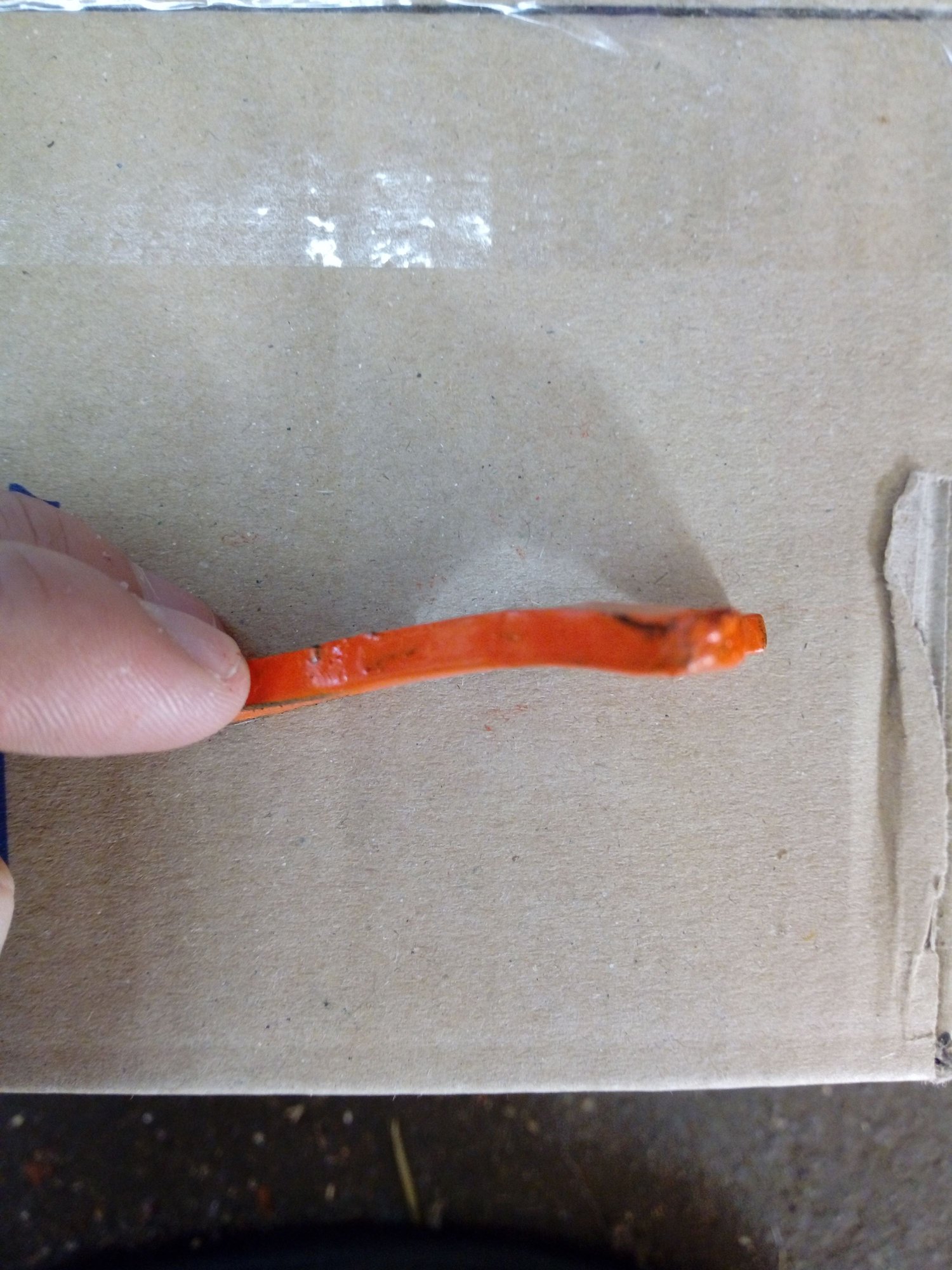

Hey everyone
How should the distributor hold down clamp be placed?
1. Going up (left to right side of the picture)
2. Going down (left to right side of the picture)

#2 is correct.

Down. The idea behind the design is to “spring” load the clamp

#2 is correct. But, you also need to understand the secondary purpose of that part. Yes, it holds the distributor tight so that it will not move during operation. But the other MAJOR purpose for that part is to be the pathway for electrical ground from the engine block to the distributor housing. So....the contact points on the bottom of the part at each end MUST be free of paint, etc. so that electrical conduction can take place. Likewise, the distributor housing flange and the engine block where those contact areas touch must also be free of paint and insulating 'stuff'. Otherwise, you WILL have ignition problems.

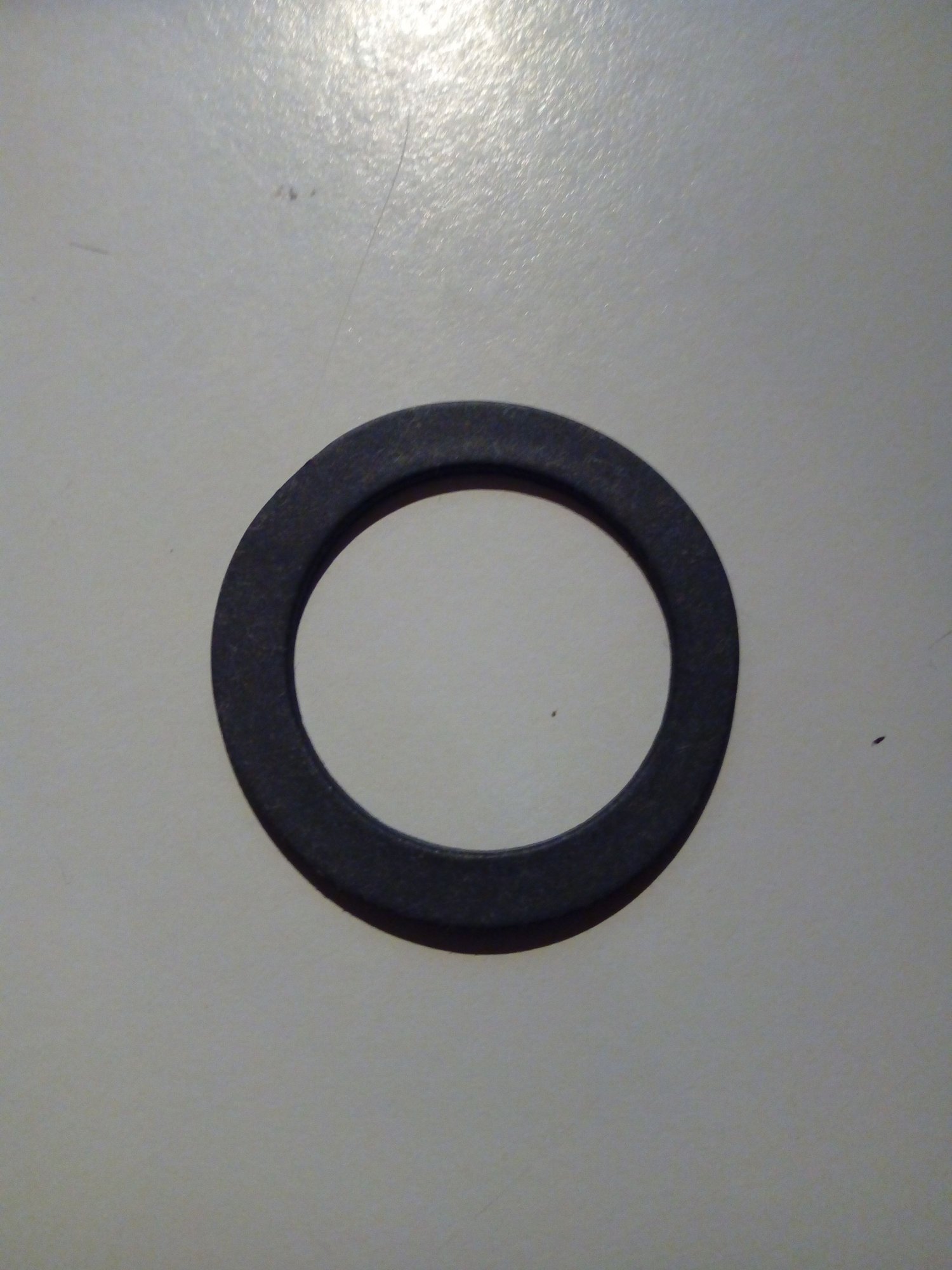

What about the gasket for the the distributor?
Go with the gasket and some Permatex 'High Tack sealant', or leave the gasket and use just some 'Black RTV'? (I'm using an aluminum intake.)
The little fiber ring gasket was part of the intake gasket set from Fel-Pro.

I used Permatex Black and pretty much glued the ring gasket to the Intake semi-permanently. You can't "glue" both sides because you may need to rotate the distributor another day.

OK, Black RTV (or the Right Stuff) it will be.
